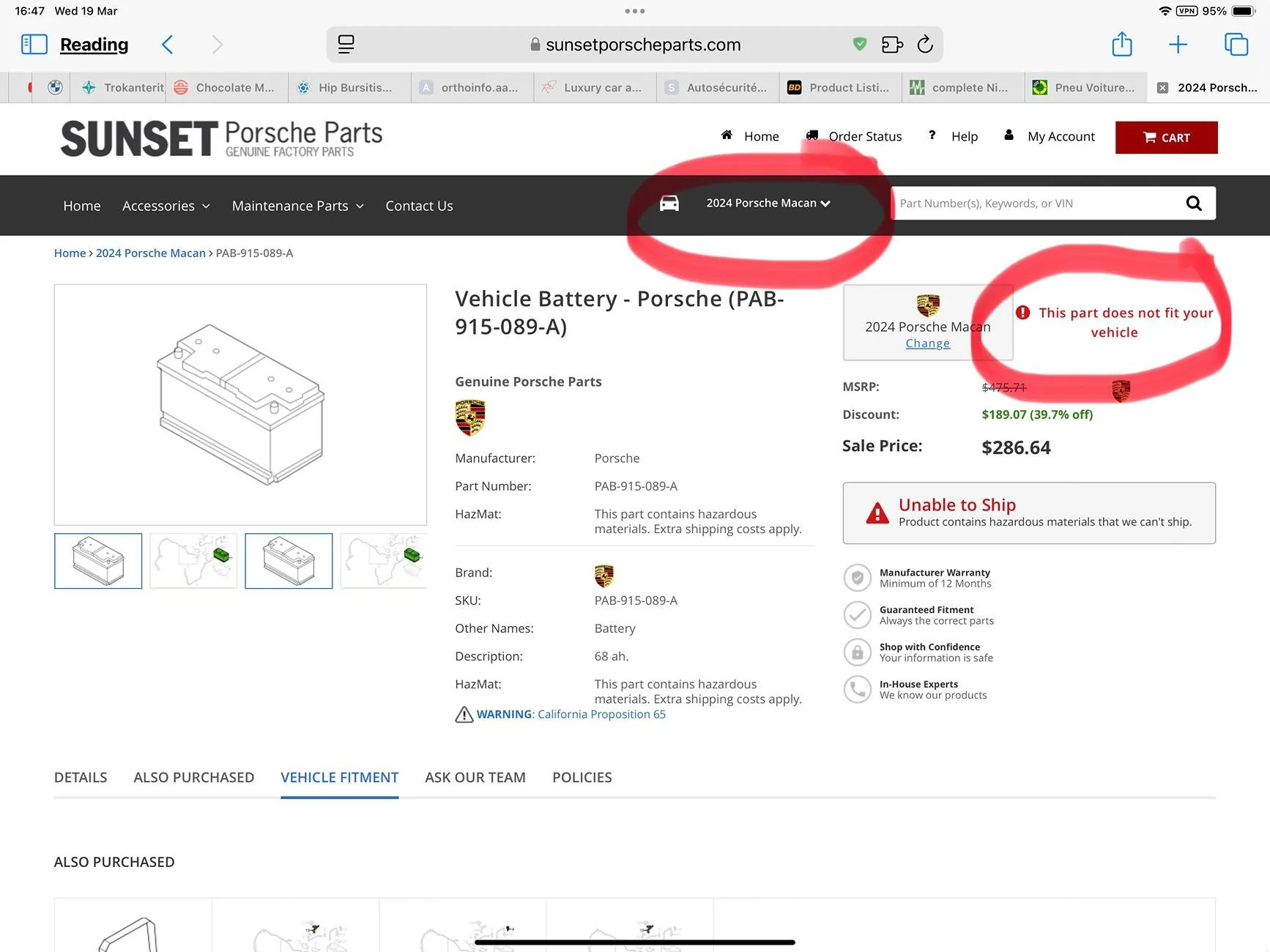

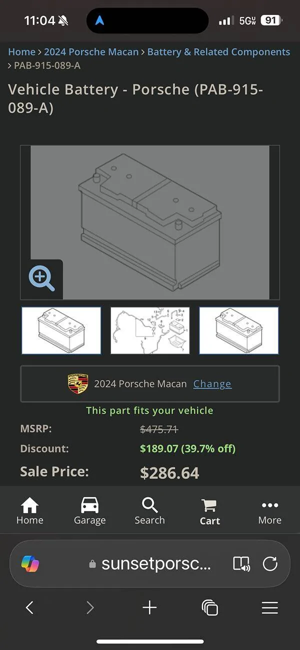

Just the 12v alone, if it were say 60Ah, that's 60 * 12 = ~720Wh. So you'd only be able to run the dash cam at 240Wh for ~3 days before draining that LV battery completely.
Yep that is what I get around 3 days before the 11.7v are reached
