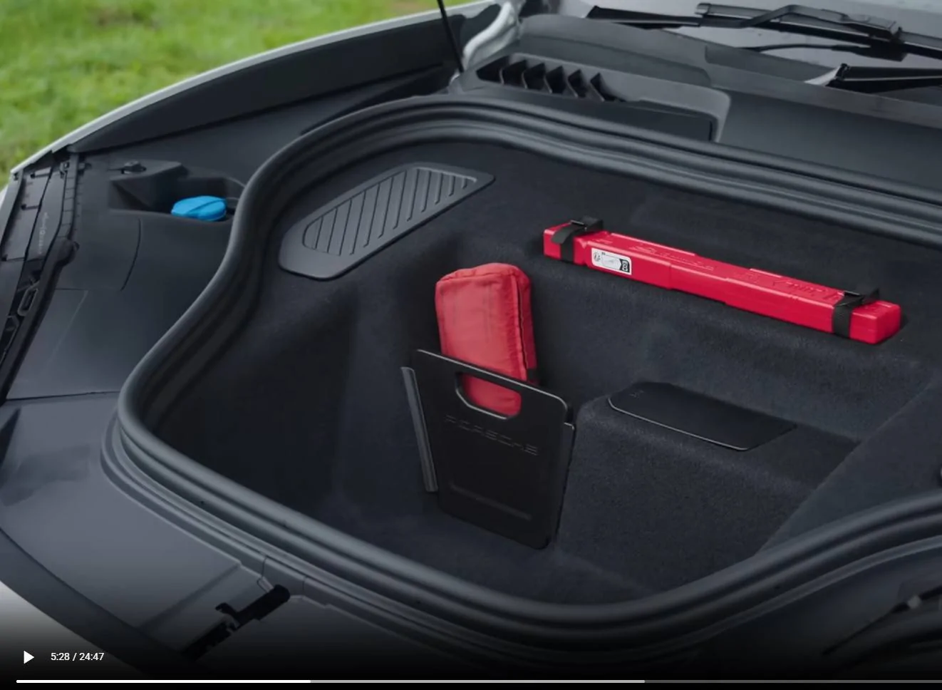

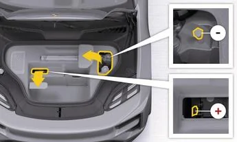

He also told me the battery is under the passengers footrest
This might be technically accurate, but is not useful. From the image in the manual, you can see where the battery is accessible from the frunk - the + connection is directly on the battery. It looks like you need to remove the whole frunk lining to get full access to the battery.

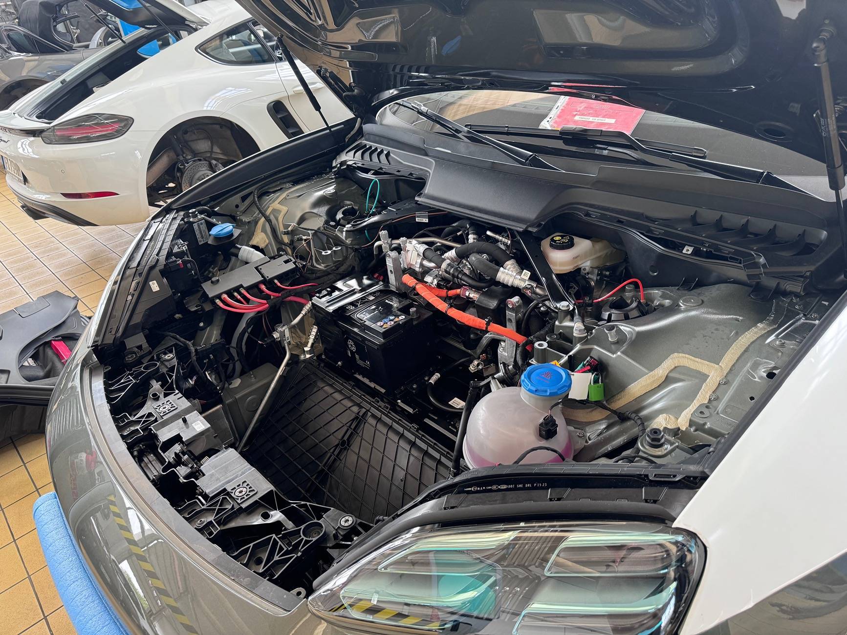

Looks like the battery is on the passenger side under the lining.
Electric Macan EV 12v Battery capacity and charge type? IMG_8211
Interestingly in RHD drive cars the battery appears to be shifted over to stay on the passenger side.
