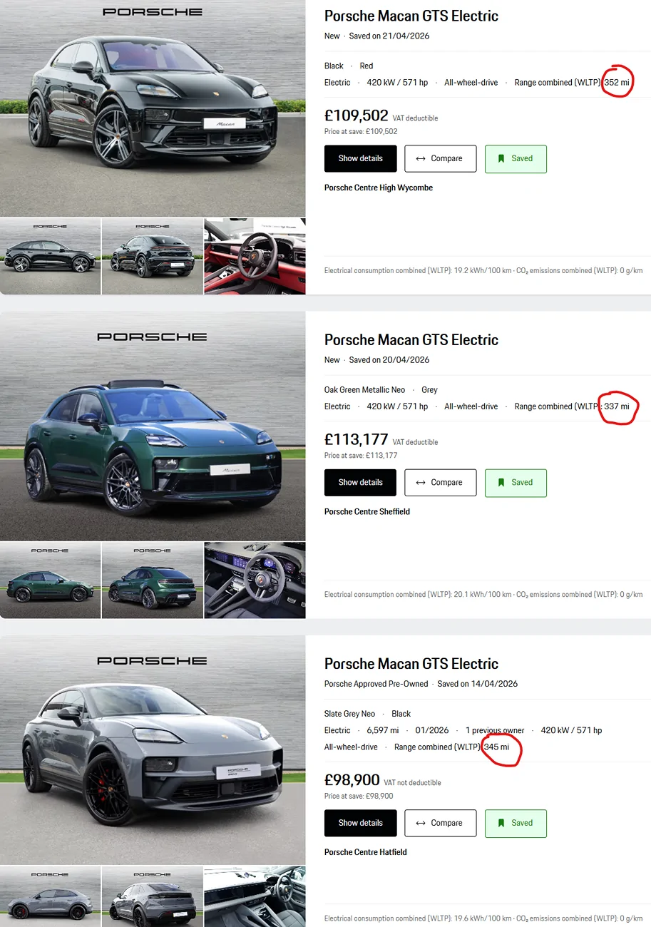

Also, other than the sport design bits, other options (including, significantly their weight, or any other measurable impact they may have on WLTP as measured by whomever) are different as standard, and these all have a bearing... I've always been a little interested in how much options like thermal glass, ventilated seats, four-zone climate, ACC, might affect WLTP calculations.
Looking at different configurations on approved used demonstrates this somewhat (all 22" wheels below):
The primary main differentiator will be the wheel rim size and tyre selection on these cars. The options list won't all materially impact actual range but bear in mind options such as a towbar will have a bearing but most other things not. Noise Insulated glass is actually lighter (around 2kg) - Unlike the conventional single-layer safety glass used for the sides and rear, this glass features five layers: glass, three layers of film, and then glass again. The middle layer of the three polyvinyl butyral (PVB) films has special acoustic properties that absorb much of the oscillation of the surrounding glass.
WLTP is best ignored and just apply simple logic - large rims and fat tyres = increased drag = reduced range + low ambient temps = makes things worse.
Depending on Model Year (MY) there will also be small changes if the WLTP has been recalculated. There are MY25 / MY26 in your samples.
In any event, as you're UK based deduct +/- 15% from these numbers to get a more or less realistic real world range for ambients 15C or more. You will never achieve these range numbers.
Passenger weight is another factor too - obviously.
Porsche used to have a range calculator where you could provide wheel choice, ambient temp, AC ON or OFF, type of driving - City, Motorway, Country Roads which was really useful and quite accurate.
