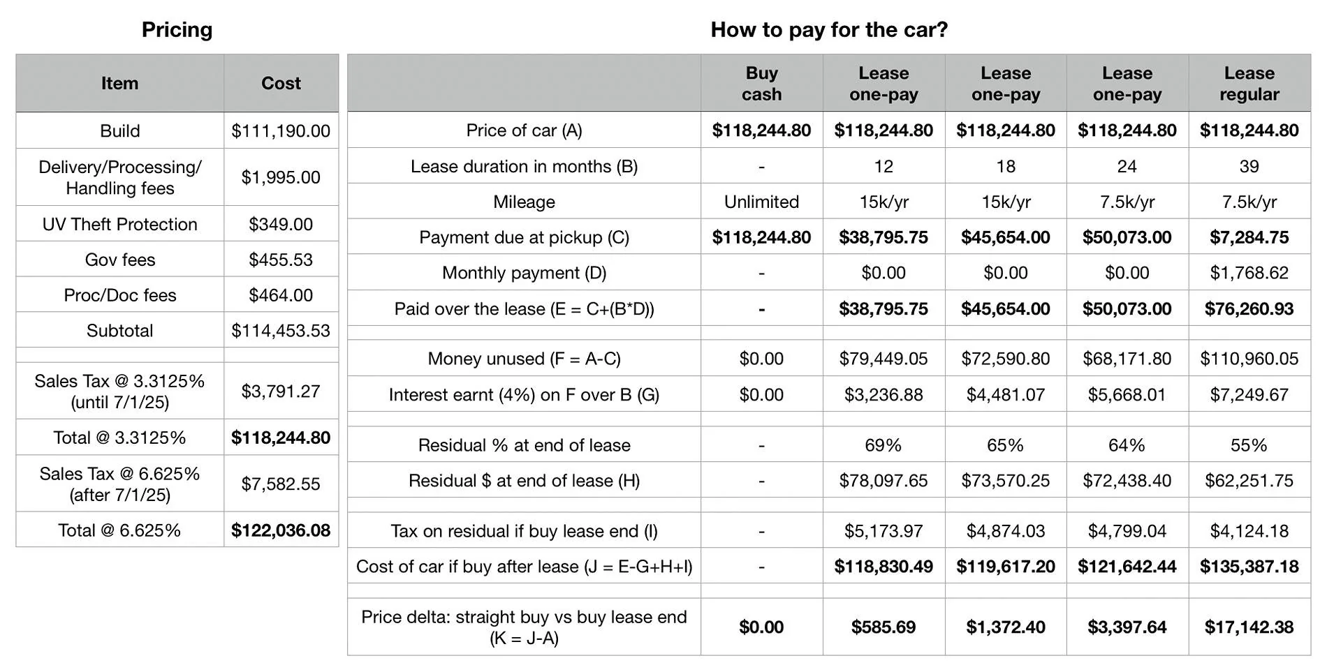

The options:
I asked my SA to share all options with me and I’ve summarized the costs and options in the charts below.
Electric Macan EV Buying vs leasing (and possibly buying then): my numbers IMG_0072
Couple notes on the math:
  • Investing the unspent money over the next 12/18/24/39 months with a 4% return, it can offset in part the cost of leasing.
    That 4% can easily be secured with a CD but I could probably earn more through stocks - I’m being conservative here.
  • The sales tax on EV in NJ is changing through the ownership of my Macan: if I buy the car now, I’ll only pay 3.3125% in taxes… but if I buy it after the lease ends, I’ll pay 6.625% on the balance. 😒
  • All the leasing options include the $7.5k tax credit which may very well vanish next year if Trump follows through. So it may be worth squeezing it now.
My thoughts:
  • With the 12 mo option, I could buy the car (with the increased sales tax) at lease end and be out of pocket less than $600 vs direct purchase. Not bad at all!
  • Both the 18 and 24 mo offer similar peace of mind but at an increased premium… I need to check what the 24mo option would cost with 10k miles/yr.
  • The 39 mo option gives the most use of the car but buying at the end of that lease makes no sense.
  • The question is: if I instead bought the car upfront and sold it after 39 mo, could I get at least $42k out of it? (36% residual when Porsche states residual will be 55%) If not, leasing may also work in my favor.
I’m currently considering leasing for either 18 or 24 months (depending on 10k miles pricing) and assessing during that period whether the car is defect free and how it depreciates.
If conditions are favorable, I can just buy it then - and still sell it after 39 (or x) months of ownership when something better comes along.
If conditions suck, I can just walk away after 18/24 months.
Did I miss something? Not consider any aspect of this entire process? Make a mistake in my assumptions?
Please be my sounding board. :)

It's worth mentioning that mile overage is actually not that bad. 30 cents a mile sounds terrible until you really math it out.
For example.. even 25k (17.5k extra) miles on a 7.5k lease is only 5250 or 437.5 extra a month.
I think it's actually worthwhile to get a lower mileage lease. The mileage is also waived if you buy it out. I'm going to do the 2 year 7.5k and just plan to either buy or pay overage.
I'd get a quote on a 2 year 7.5k or 10k normal lease. I don't know that one pay is worthwhile when you consider you're losing the yield on the cash you're paying upfront.
The thing is I actually believe Porsche leases are setting a residual that's higher than what the cars will be worth. That's what's changed for me. I also plan to put on a lot of miles and I actually think buying extra miles will be cheaper than depreciation.
If you're planning to keep the car for years and years, sure, but if there's a chance you'll sell the car in 2 or 3 years you could be looking at a devastating sell price.
917
1,309
30cts/mile is indeed not terrible, and good to know it’s not charged If you buy the cart in the end.
I suspect worse case I’d do an extra 1k mile per year, so $600 over 2 years… I can live with that!
Thanks @PanameraFrank!
dgkhn
248
260
New Hampshire
Following your logic, I did a 2-year 7500 mile regular lease on a Macan 4. (The residual on a Macan 4 in that situation is 67%, more than the Turbo, so that tilts the calculation even more in the lease direction.)
Besides the reasons given by @PanameraFrank, by doing a regular lease you can buy it out any time over the lease life (without paying the remaining rent charge), so you have even more flexibility. You might want to look at the math of doing a two year lease, and then buying it out after 1 year or 18 months, vs doing those shorter-term leases.
By the way, for the most part, each additional 2500 miles in the lease reduces the residual by 1% of MSRP (I think one of the gaps is slightly different) (the 12 month and 18 month leases are different because they force you to take 15,000 miles per year). So, on a two year, 7500 mile/year lease, if you go to 10,000 miles/year, in your example, it will lower the residual by about $1200. Assuming you would actually drive the extra 5,000 miles over the two years, those miles would cost you $1500 (5,000 x $.30), or only a $300 penalty all told.
One more thing on the opposite side of the ledger: whatever you earn on the "money unused" will be taxed at your marginal tax rate.

i have a 4S pickup coming up, was leaning towards cash purchase, but after checking this thread, it inspired me to look into lease terms with my SA.
cash price out-the-door (incl taxes/fees): ~$110,000
lease details:
$5,500 down, 24 months, 10k miles, monthly payment ~$1,900 (incl taxes), residual ~$64,100
total paid over lease: ~$51,100
total cost to own: ~120k
i looked up some formula for withdrawal-adjusted returns (cause we technically need to withdraw from the investment principal every month to make payments). I live in California, so assuming a tax-free rate of 2.5% using CA muni bonds, i'd earn ~$4.5k in non-taxable interest over the lease period. This reduces the cost to own down to ~115.5k.
in summary, it's a ~5.5k premium to lease over purchasing. whether that's an attractive offer or not comes down to individual risk tolerances.
i think something that often gets overlooked when calculating interest accrual from investing over the lease period is 1) not accounting for taxes and 2) not accounting for withdrawals.
in states with high state taxes, it is marginally more advantageous to take the tax-free yield over treasury bills/notes (which are not subject to federal taxes but are subject to state taxes), at least this was the case when i last crunched the numbers.
if i just used the general interest rate formula assuming no withdrawals, it would have shown that i'd have earned ~1k more in interest over the lease period.
