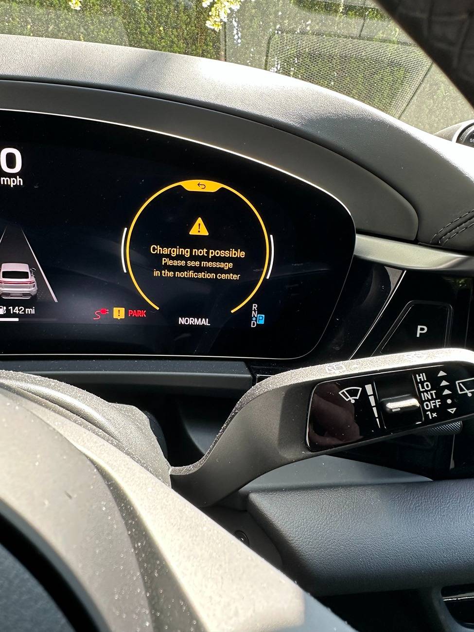

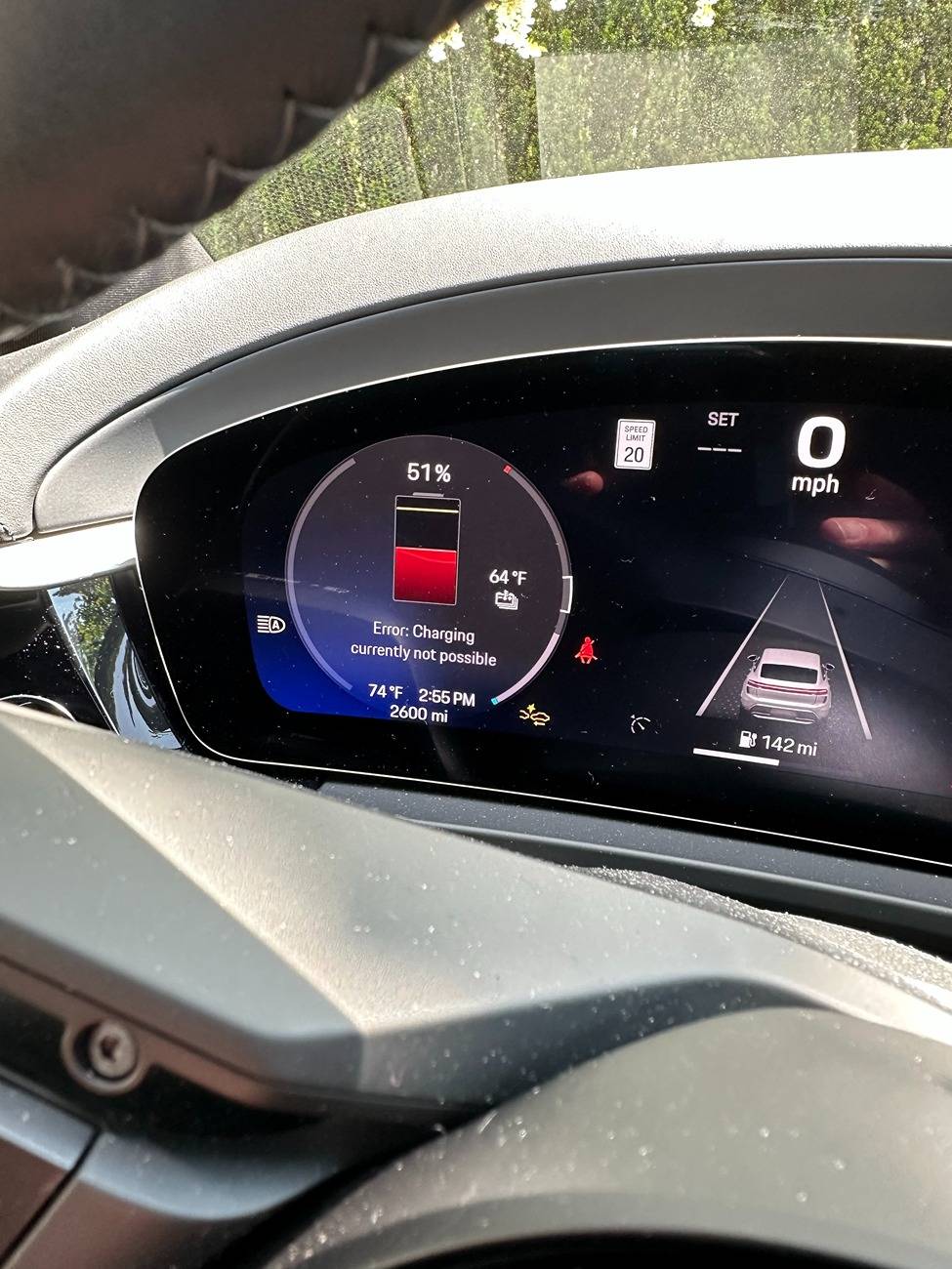

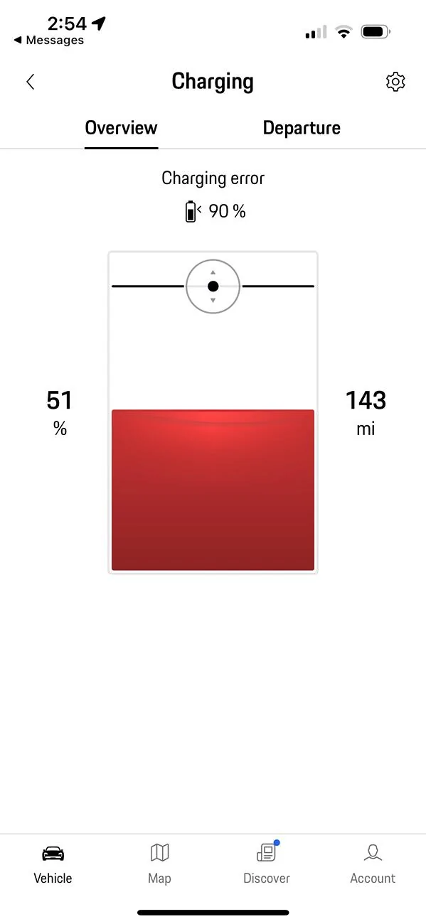

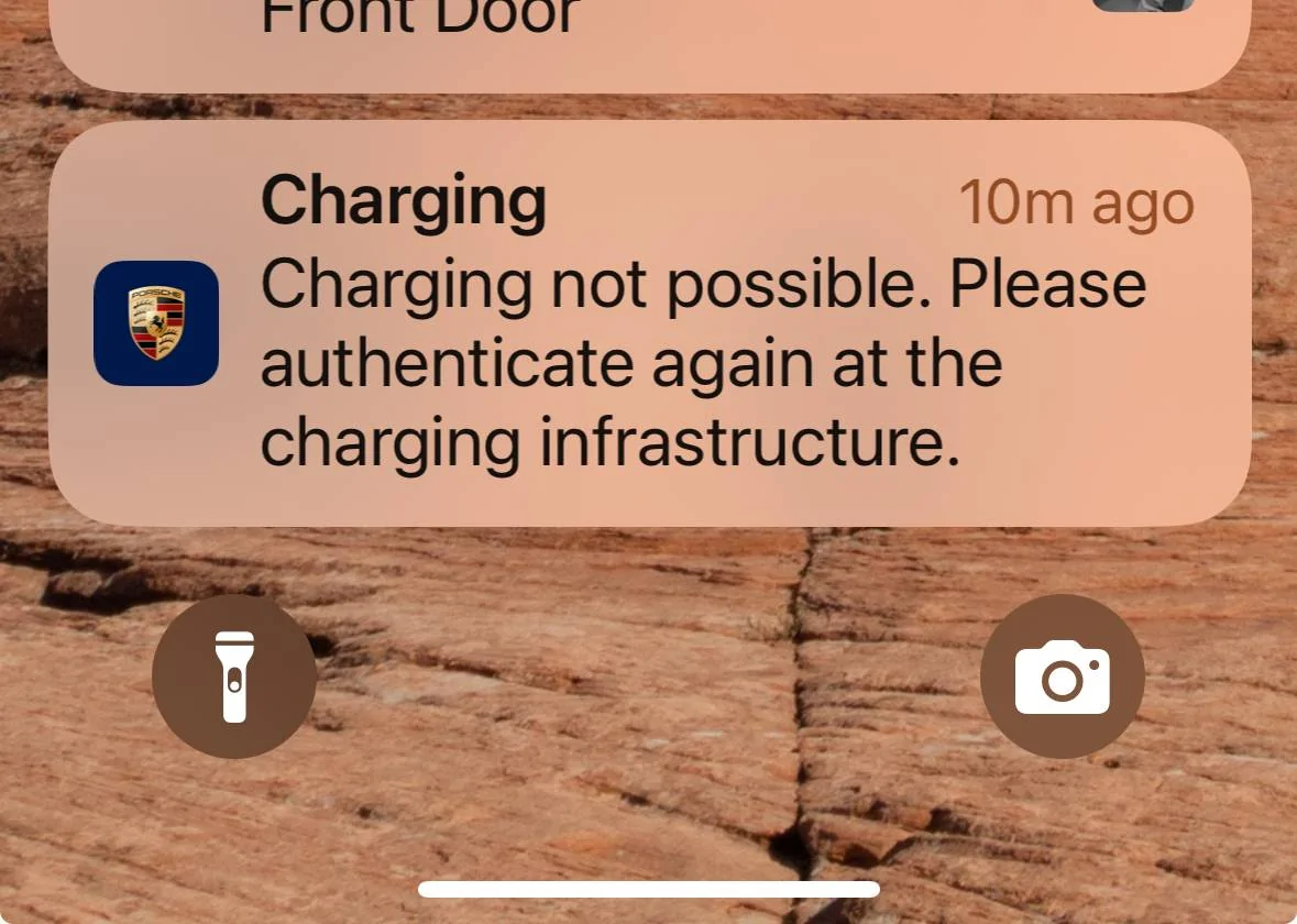

Today the Macan continued its fun tour of available failure modes (this car has been in the shop for about 30% of the time that I've owned it).
Anyway, today it stopped being able to charge at home with the messages below. I understand that people have had difficulty authenticating at public charging infrastructure but this should not be happening on a home charger. Anyone else experience this?
Error: Charging not currently possible

Thanks all for the suggestions. It turned out to be the Porsche charging cable was in a bad state - with all indicator lights red. The error messages misled me somewhat with the mention of authentication. If they had simply said "the cable is not providing electricity" I probably would have figured this out more quickly.
