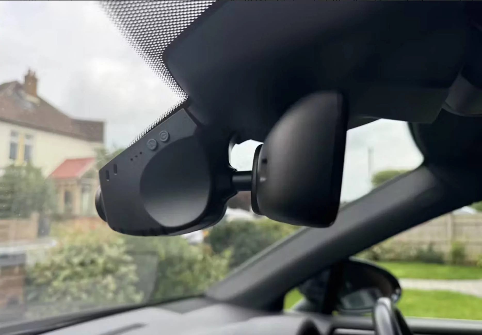

Porsche dashcam is bad, and very badly integrated…
What do you think about fitcamx: OEM like install is amazing
Are these any good? I had the dashcam prep in my spec as standard so I am tempted if these are any good and work with the existing wiring?
