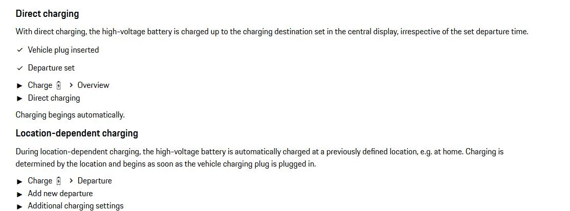

From the owner's manual:
Electric Macan EV Direct Charging Toggle on App? 1737044457524-nk
