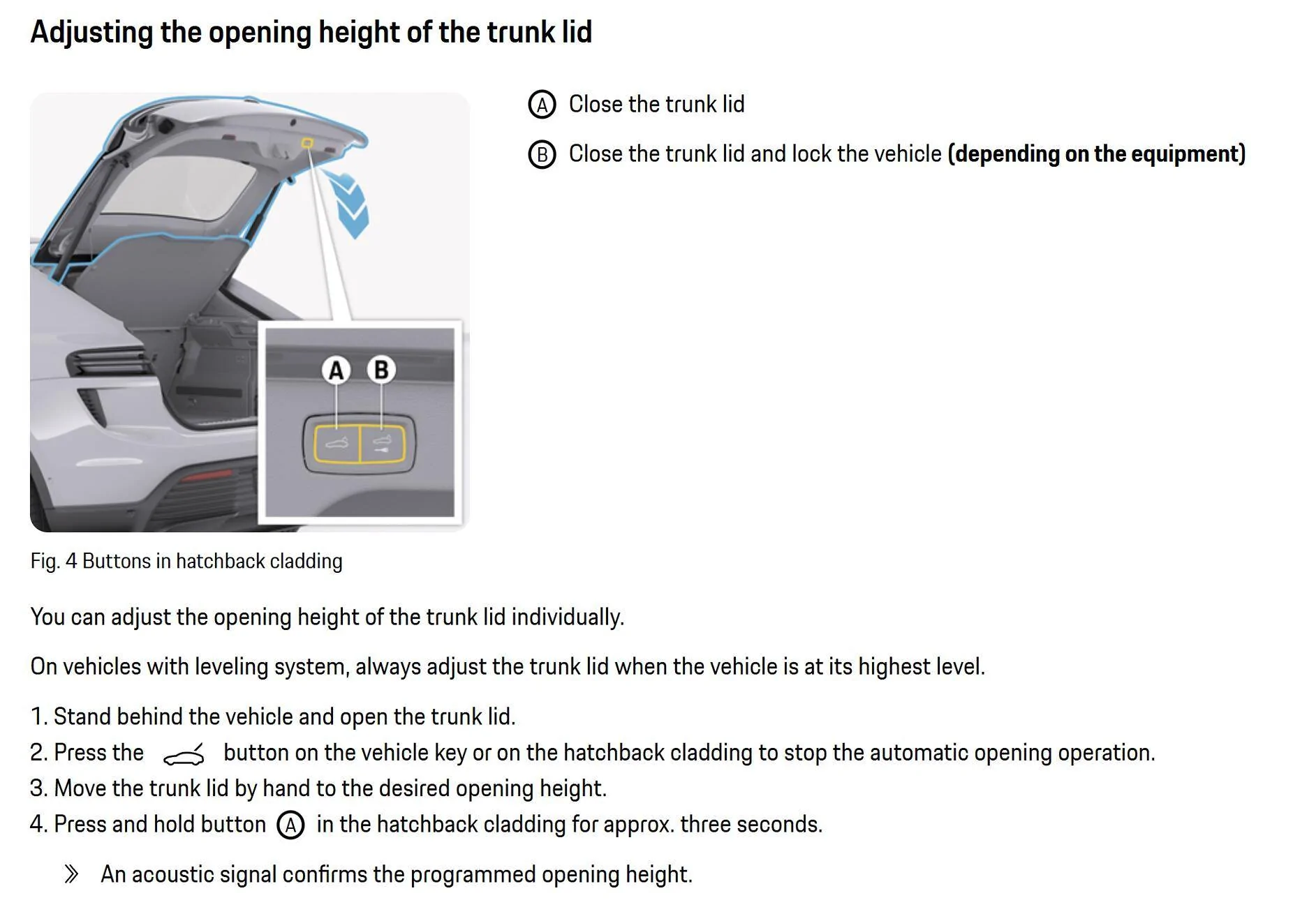

If the hatch hit the back of the garage wall due to parking close to it then there is little that can be done about that, but you can adjust how high the hatch opens, which would help prevent hitting the ceiling.
Electric Macan EV Disable front and rear hatch buttons on key fob and door controls? 1751653458970-o
