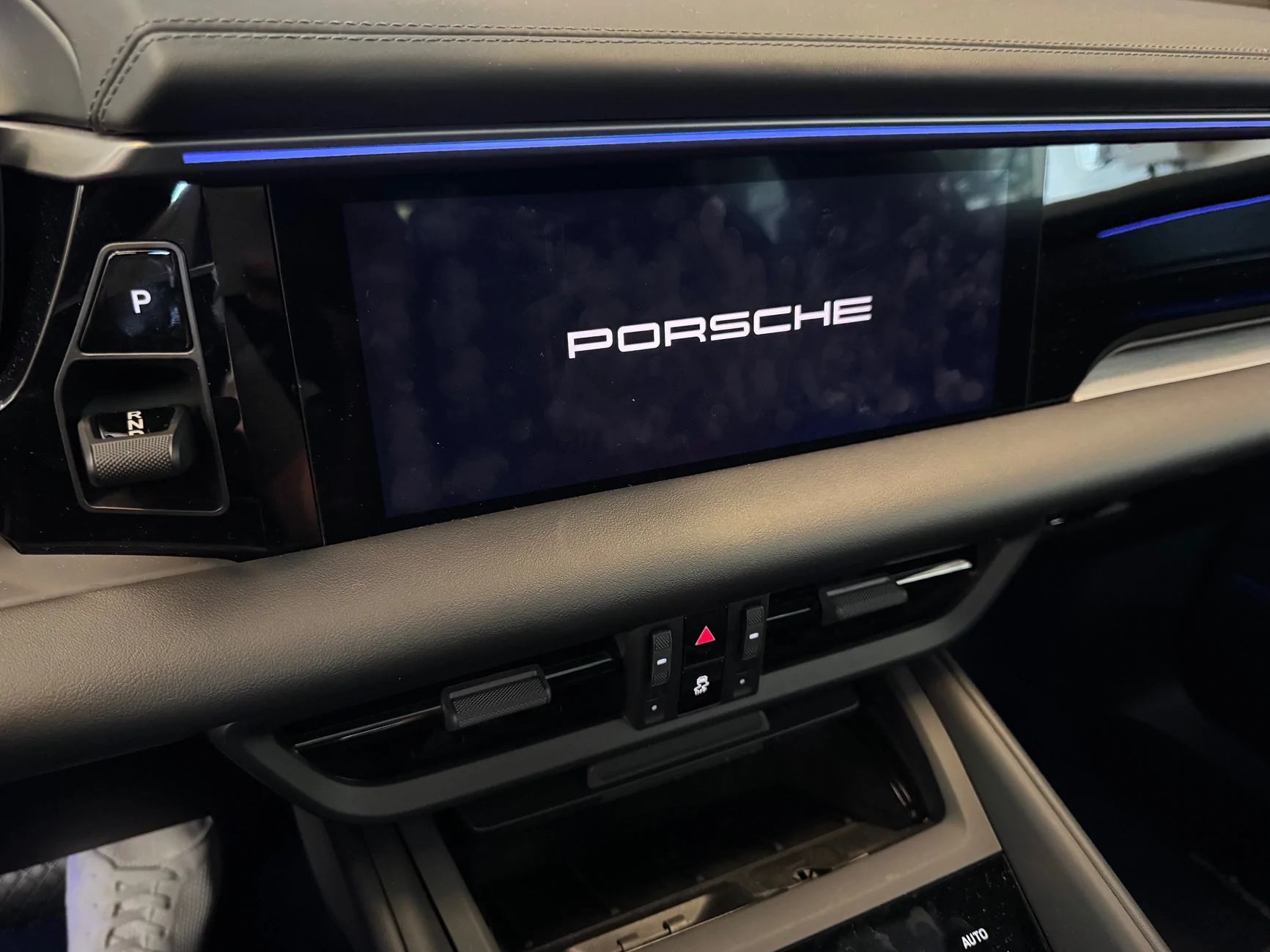

I lost 1% overnight. Also, My wife started the car up to run an errand two days ago and the screen only had "Porsche" on it. It never moved past that, even after three restarts. Eventually it did after se walked away for a few minutes.
Update: This also happened to me yesterday... twice. All I needed to do was back the car out of the garage for a few minutes. The startup screen would not go past the "Porsche" screen... waited for a few minutes, turned car off, then tried again. Same thing. Third time it loaded past that screen. Battery % did not change overnight last night.
