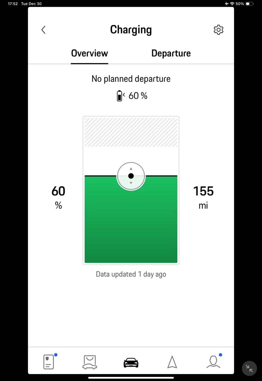

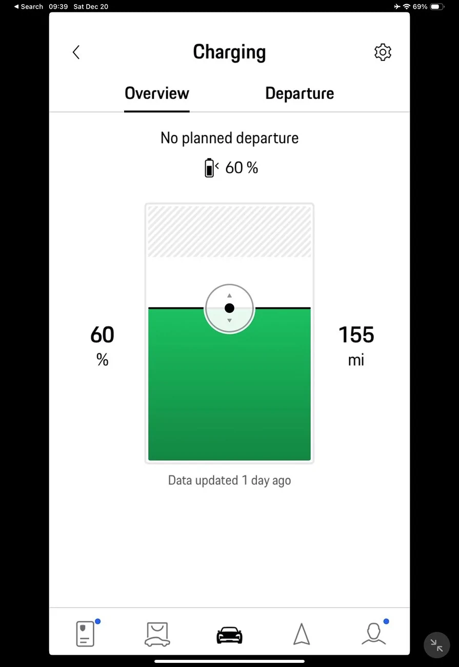

now my car is parked for 3 weeks. it is not plugged in. parked at 12/12 with 60%.. checked 12/20: 60%,
as of yesterday: 60%.
When you next drive, that percentage will drop after just a short distance.
this thread is called: “does the car keep soc stable after one week?“
answer: yes.
