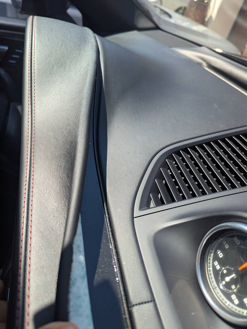

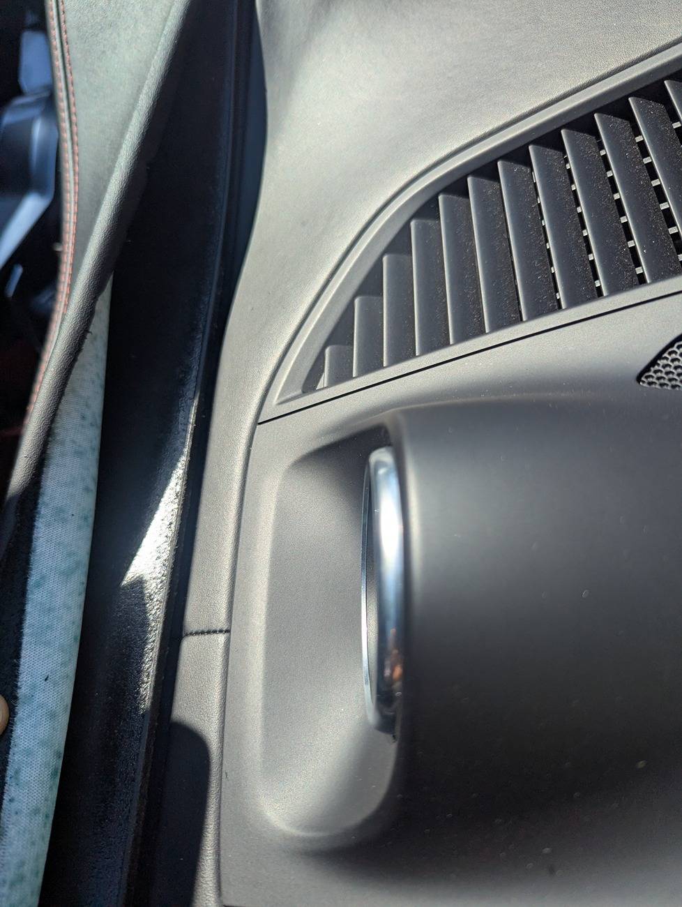

2018 Macan S....
Separation due to hot weather.

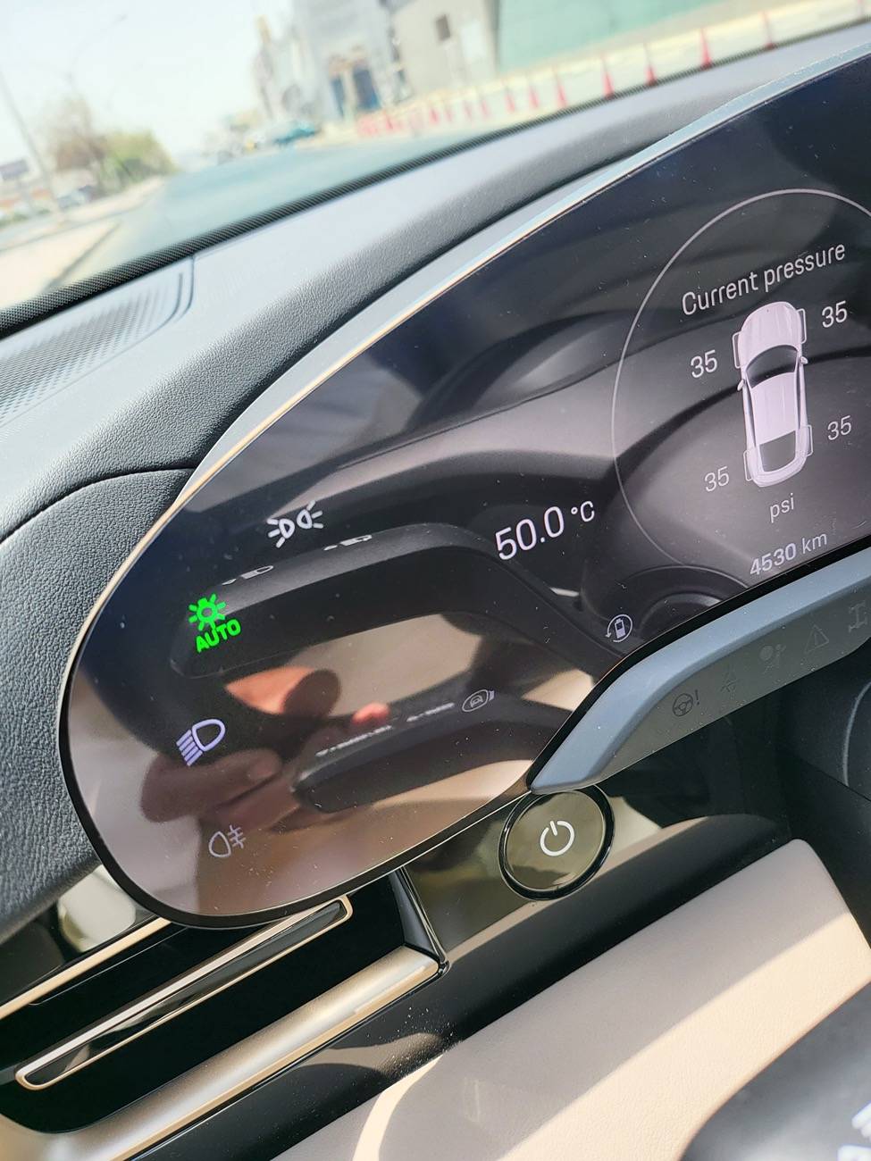

35 degree celsius is considered good wheather over here, that’s not extreme heat. I’ve used my taycan as my daily driver in 50 degree weather (during July & august) with no issues. This is the temperature in the shade of course, in the sun it is much higher. The battery management and pre-cool option took care of the charging, I did not have to do anything. If I remember correctly I had the maximum charge reduced to 80% on the Taycan or something like that. I liked that I could keep the AC on for 30 minutes when the car was parked in the sun especially since my Taycan was black.
