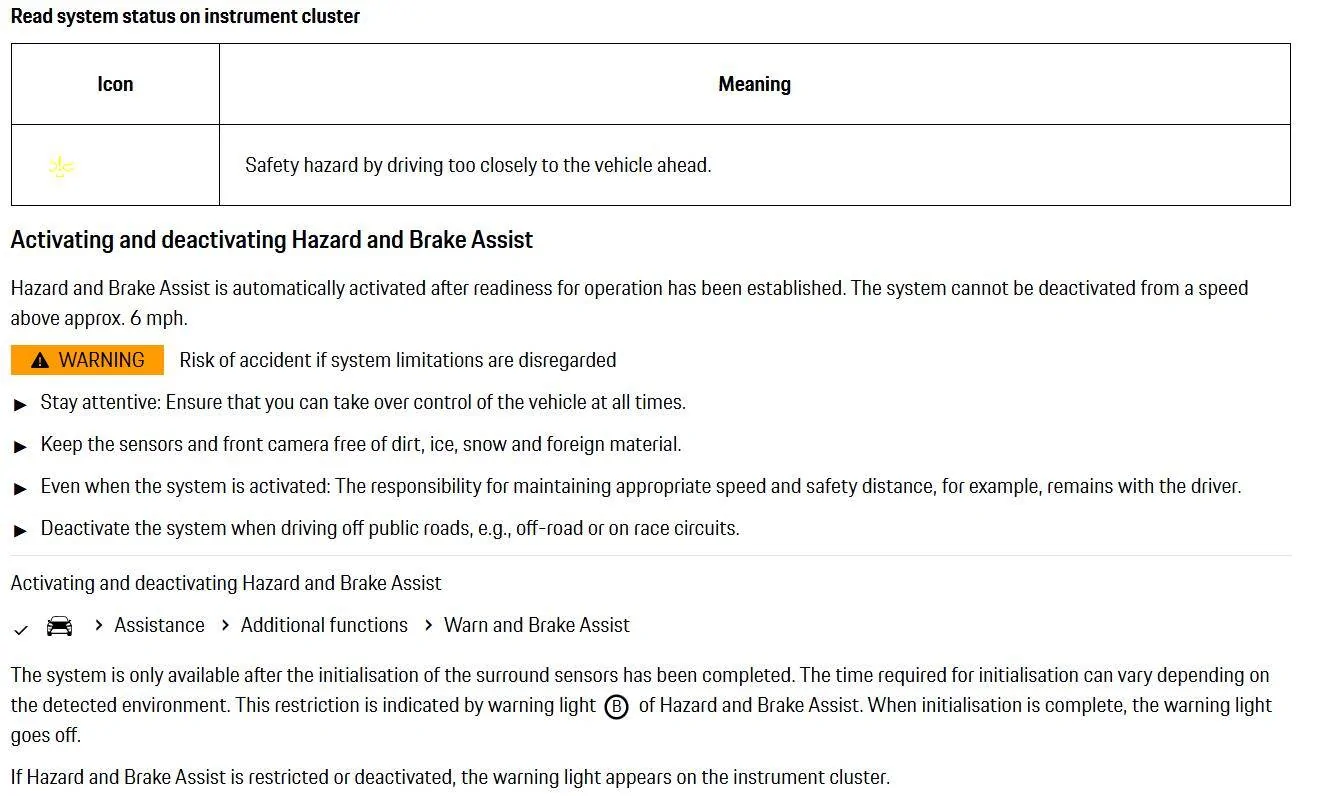

Thanks, Diego! It’s not always clear where to navigate within the online manual.
This page confirms Kal-El’s response that this symbol appears at startup until the Hazard and Brake Assist system is initialized.

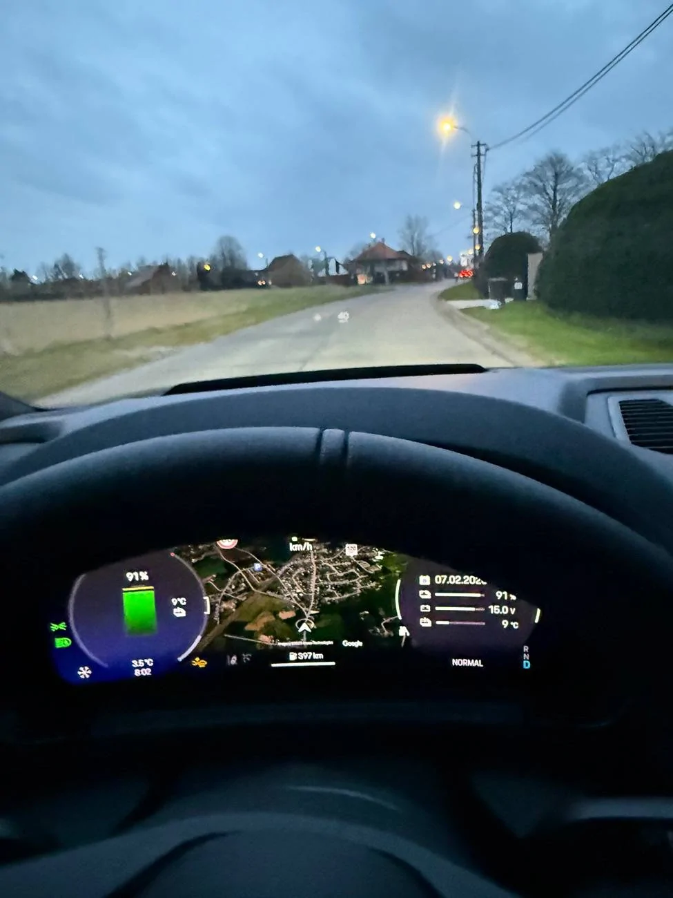

I even have it when nobody is in front of me
Electric Macan EV Front Impact Warning Light IMG_8136
1,125
724
Yep but deflections from the side can also trigger. - perhaps
I have a 4S on extended loan this weekend and experienced this and repetitive warnings. In my case lots of road spray at times and when close to a central reservation- tedious.
Perhaps the hedge on your right was determined to be a threat!
I will check again
do you have the whole warning/intervention turned off?
I turned mine off today and i noticed that warning light now stays lit like you're showing
I also turned it off. Thanks for the tip.
