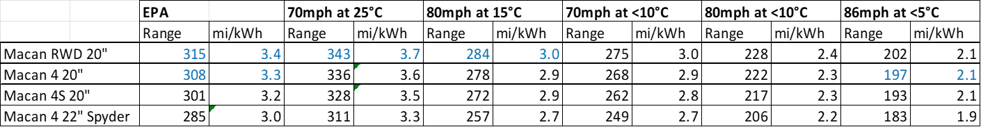

Looks about right, matches my experience below. Values in blue are measured, black calculated based on the range test video & porsche consumption data:
I would say my 86mph @ 5C is equivalent to your 80mph at -5C, then your 22C cabin heat took you down a notch to 2.0m/kWh!

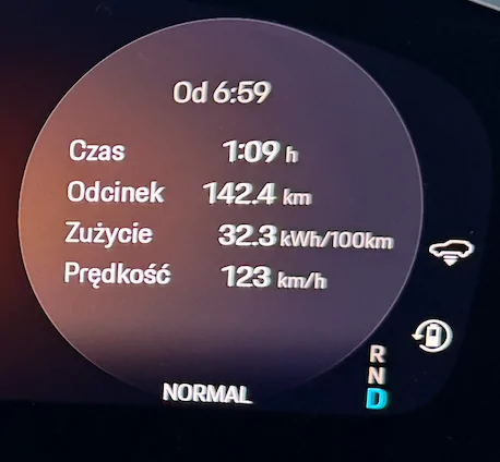

Last month with average speed 124km/h in 2C outside temp I was getting consumption 24.8 kWh/100km.
For me avg 123 km/h on highway means you are mostly doing 140km/h.
This was in +5C outside temp.
Electric Macan EV Impact of cruising speed on range 1769012194980-7i
I very much doubt claims of anything below 30kw during longer stretches of high speed driving in winter. You can - under some circumstances - get "120km/h in 3C outside he is getting around 26.9 kWh/100km" perhaps downhill or sth ;)
There are many factors like elevation change, road friction (some highways are smooth with more asphalt, some have more concrete), tires, tire pressure. During long stretches of highway driving all these factors combine.
How you exit a corner matters as just entering the highway alone can have impact - you can slowly drive and accelerate or you can feel the back sliding on full throttle. So driving style also comes into play.
Overall it is what it is - either you can charge fast and have fun driving or the EV is not for you ;)
That being told I noticed some improvement in consumption after:
1) the first software update
2) doing a better job with tire alignment on wheels minimising the RFV (Road Force Variation)
Ok I see the difference now. When I am talking about driving 130km/h it is speed set to cruise control with me resetting trip meter once I enter highway. Both mentioned drives were with mostly empty highway so there was not much of breaking/accelerating hence real average speeds being 124 and 126km/h.
When you are saying that you are getting average speed 123km/h with doing mostly 140km/h it most likely means that you do a lot of breaking and accelerating so while we get similar average speeds consumption can be quite different.
While you are right that there are many factors at play I just don't see much differences other than few C delta in outside temp in my drives. My car is also randomly losing SOC % while parked in garage, so I am wondering if maybe BMS is getting messed up calculations.

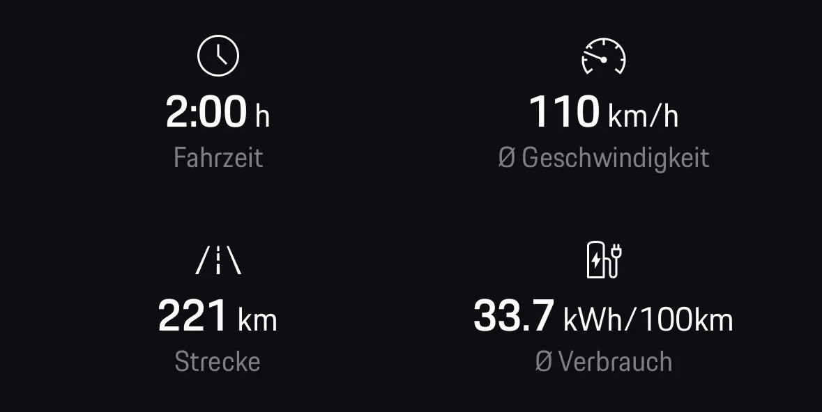

This was at 0 degrees celsius and constant 150-160 kmh, sometimes 170. Plus entry/exit to autobahn on some 30kmh city parts which ruin the average. 20 inch winter tires on 4S.

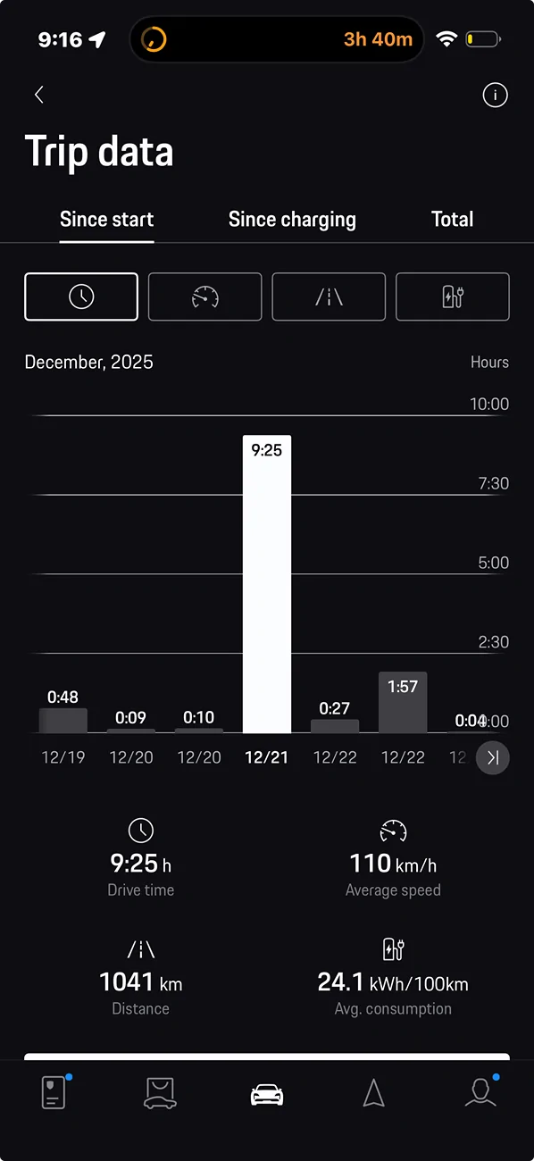

Most of the driving around 130km/h when possible ... heated battery, started at 2C in mountains and had the rest between 5 and 10C ...
