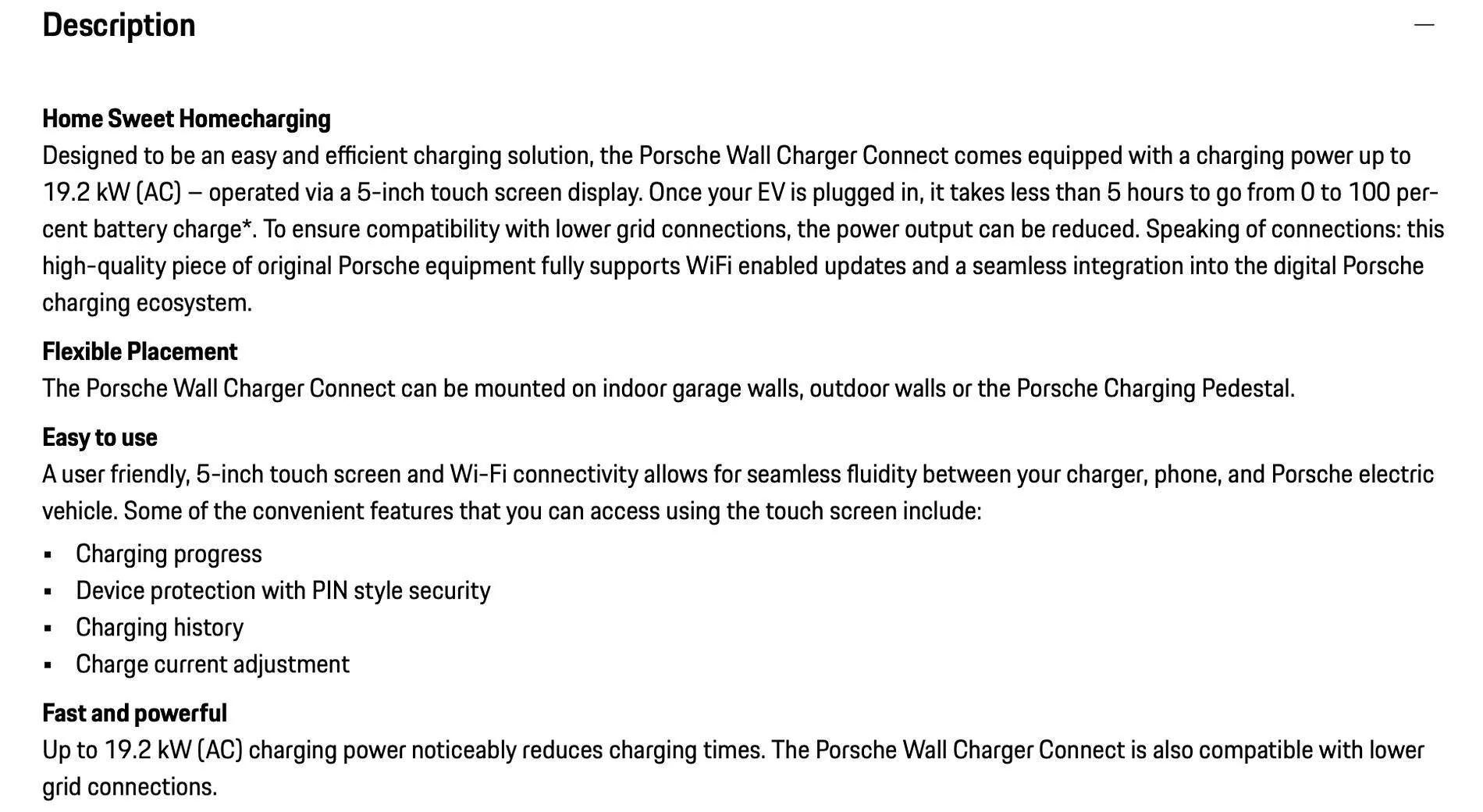

the North American SAE J-1772 EV charging standard allows for 1.44 kW to 19.2 kW L1/L2 charging (12 - 80 amps) - there are similar ISO standard with a lot of overlap - so there is no one standard but the general constraints follow the SAE J-1772 guide lines - for AC charging North America is migrating to the SAE J-3400 NACS standard, but it's mostly an updated standard covering the new physical plug format for NACS style charging cords and vehicle charging ports…
the gen1 Porsche Taycan supports this full range of charging capacity - the gen1 Taycan has an option 19.2 kW onboard charger and the Tacan with this factory option does in fact charge at 19.2 kW when paired with an appropriate capacity EVSE - standard Taycan (no factory option) support 48 amp (60 amp breaker) 11 kW charging…that is also beyond dispute and is easily demonstrated.
building codes limit "mobile" EVSE's (those with removable NEMA plugs) to 40 amps (9.6 kW on a 50 amp breaker) - this is where the confusion creeps in - if you are a "MOBILE" EVSE with a NEMA plug you can not provide more than 40 amps via a NEMA 14-50/6-50/10-50 NEMA outlet
you can provide up to 19.2 kW (80 amps @ 240 volts) if your EVSE product is hardwired - again this is a BUILDING code electrical device limit - NOT a EVSE limit or a charging protocol limit.
hardwired J-1772 EVSE's can be anywhere from 12 amps to 80 amps…
mobile plug-based J-1772 EVSE's can be from 12 amps to 40 amps…
there are number of hardwired EVSE's in North America that are more than 40 amps - I have 3 in my garage - and I can drive to at last 5 locations with in 10 miles of my home…that offer L2 charging at more than 40 amps…
Porsche sells a hardwired Wall mounted EVSE that is configurable from 12-80 amps - Porsche Wall Charger Connect - it supports the Taycan at 11 kW and 19.2 kW if you have the optional Taycan 19.2 kW onboard charger…
Electric Macan EV Macan EV Road Trip by Out of Spec Dave - Part 1 Screenshot 2024-12-10 at 1.43.28 PM
there is no reason (other than Porsche screwing up) that the North American Macan's are limited to 9.6 kW (40 amps) - none of their other EV or Hybrid products have a similar limitation = and the same for Audi. the onboard charger in the supply chain world wide is nearly identical across multiple vehicle assembly lines and not different regionally…
many existing EV owners have installed 60/80/100 amp EVSE's in their homes - hardwired - mounted - one of the most popular EVSE's is the charge point flex which tops at 50 amps on a 70 amp breaker (12.5 kW possible charge rate).
  • My 2020 Taycan charged at 11 kW on my setup
  • My friend Audi eTron SUV charges at 11 kW on my setup
  • My son's Tesla Model Y charges at 11 kW on my setup
  • my 2024 Macan Turbo EV caps out a 9.5 kW on my setup - and the EVSE reports 39.7 amps being delivered of an available 48 amp capacity
  • My 2024 Macan Turbo charges at 9.6 kW at my dealer service Porsche Wall Charger with an 80 amp capacity (19.2 kW max charge rate)
  • dealership Loaner 2024 Cayenne eHybrid's charge at 11 kW on the same Porsche Wall Charger
  • dealership Loaner 2024 Panamera eHybrids charge at 11 kW on the same Porsche Wall charger
  • dealership Loaner 2022 Taycan RWD w/11 kW onboard chargers charge at 11 kW on the same Porsche Wall Charger
  • A 2023 Taycan w/19.2 kW onboard charger charge at 19.2 kW on the same Porsche Wall Charger
  • A 2025 Taycan w/11 kW onboard charger charged at 11 kW on the same Porsche Wall Charger
  • A 2024 Macan Turbo (not mine) in PDI charged at 9.5 kW on the same Porsche Wall Charger
for some reason Porsche has limited/capped 2024/2025 North American Macan's to 9.6 kW
I do not believe Porsche will ever pursue resolving this
I do believe it's an un-necessary limit
Porsche customer support representative who identified as an EV expert and Macan expert told me that maximum charge rate of _ANY_ EV in North America was 9.6 kW - When then asking about the 11 kW Taycan/Cayenne/Panamera/Audi/Tesla, and their own Porsche Wall Charger Connect which offers more than 9.6 kW - she had no response. she had no response about the 19.2 kW factory option for the J1 Taycan - Porsche internal confusion on this topic is deep, and institutional and just sloppy and makes me question their commitment to EV's - which as we all know is waning…
NOTE: what the Porsche customer support "expert" told me on the is that no EV in North America supports more than 9.6 kW charging - and yet their own products tested at their dealership with their own EVSE demonstrate that to be a false assertion.
What she meant to say but was not trained properly to understand was that no _MOBLE_ EV Charger (EVSE) can charge at more than 9.6 kW - but there are EV's (many from porsche/Audi) that can charge at great than 9.6 kW, but that will require a non-Mobile EVSE hardwired and a circuit breaker of 60 amps or more. Here sir let me direct you to our own product the Porsche Wall Charger Connect that can be configured to provide up to 19.2 kW of charging capacity (240V@80 amps on a 100 amp breaker).
I believe this limit is in place not due to hardware limitations, but someone inside of Porsche got confused between mobile EVSE limits, hardwired EVSE limits, and onboard vehicle charger limits - they have been confused in this space before and had the wrong spec's posted on the North American website for Taycan for 4+ years (listing the Taycan as a maximum of 9.6 kW and yet listing their mobile EVSE as being an 11 kW EVSE [which is impossible in North America] and conflicts with the specifications sticker on the back of the PMC/PMC+/PMCC/PUC)
there is no ambiguity that there is a imposed 9.6 kW limit in the North American Macan's - that has been demonstrated…
it is also not hard to find a greater than 40 amp EVSE in North America…
many customers on the Taycan forums and this forum have existing 60 amp or greater installs in their garage…and enjoy 11 kW charge rates on their Porsche vehicles (other than their new Macan EV)
We'll never know exactly why there is this limit with the North American Macan - but I'll bet anyone lunch it's a configuration mistake and not a hardware limit - but Porsche will never address it.
I also find it odd that the Macan is the _ONLY_ EV in the entire Audi/Prosche EV product offering with this limit…even their hybrid's are 11 kW. Seems an incongruity at a minimum - also very very inefficient supply chain management to have this one difference if the onboard AC/DC chargers are in fact different - poor supply chain management - additional complexity in assembly - more complexity in parts/supply - and a non-competitive product in the market place (9.6 kW charging limit is not a Premium EV charging experience) - if this is in fact a hardware limit - it speaks to really really poor management on Porsche's management - seems a very complex difference in a region where it's deficient and probably gains nothing - AC/DC converters for battery charging is a component easily shared across their entire suite of products…
