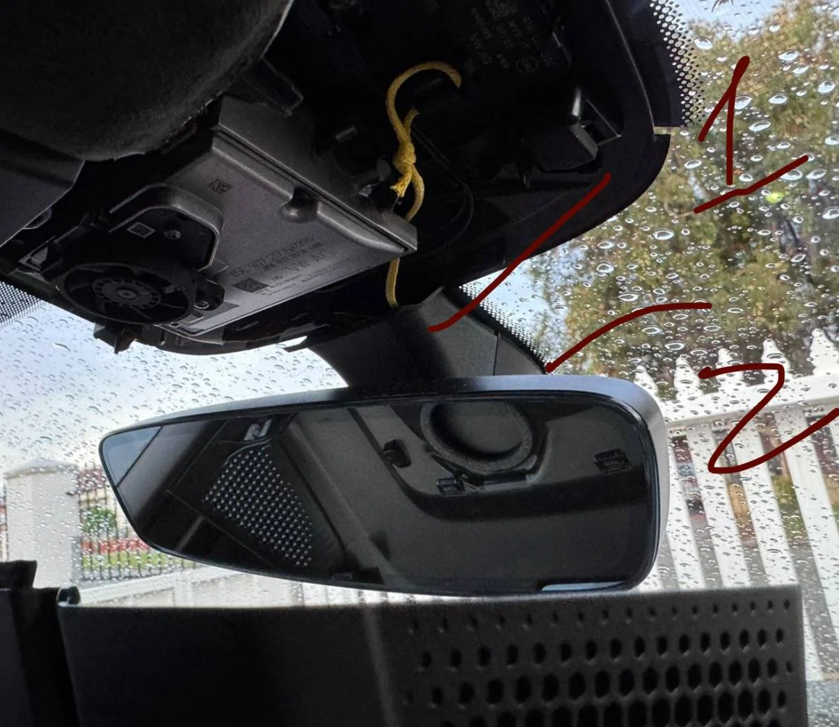

To be clear, these are the 2 parts to remove:
1. Slides right off (pull it towards the roof)
2. Once the previous part is off, it’s fairly easy
Everything looks normal, like on my car.
I also struggled when I first did it but the second time around was easy.
Yeah, that was my issue. (1) doesn’t slide off towards the roof even with quite a lot of force. Will give it another shot sometime in the future ?wife isn’t happy that I scratched the hard plastic when I took off the first part
Oh by the way, there is one clip on each side (left and right), that attaches this piece to #2.
You will need to use the little plastic tool (flat side) to separate #1 from #2.
Based on your pic, it looks like they’re still attached.

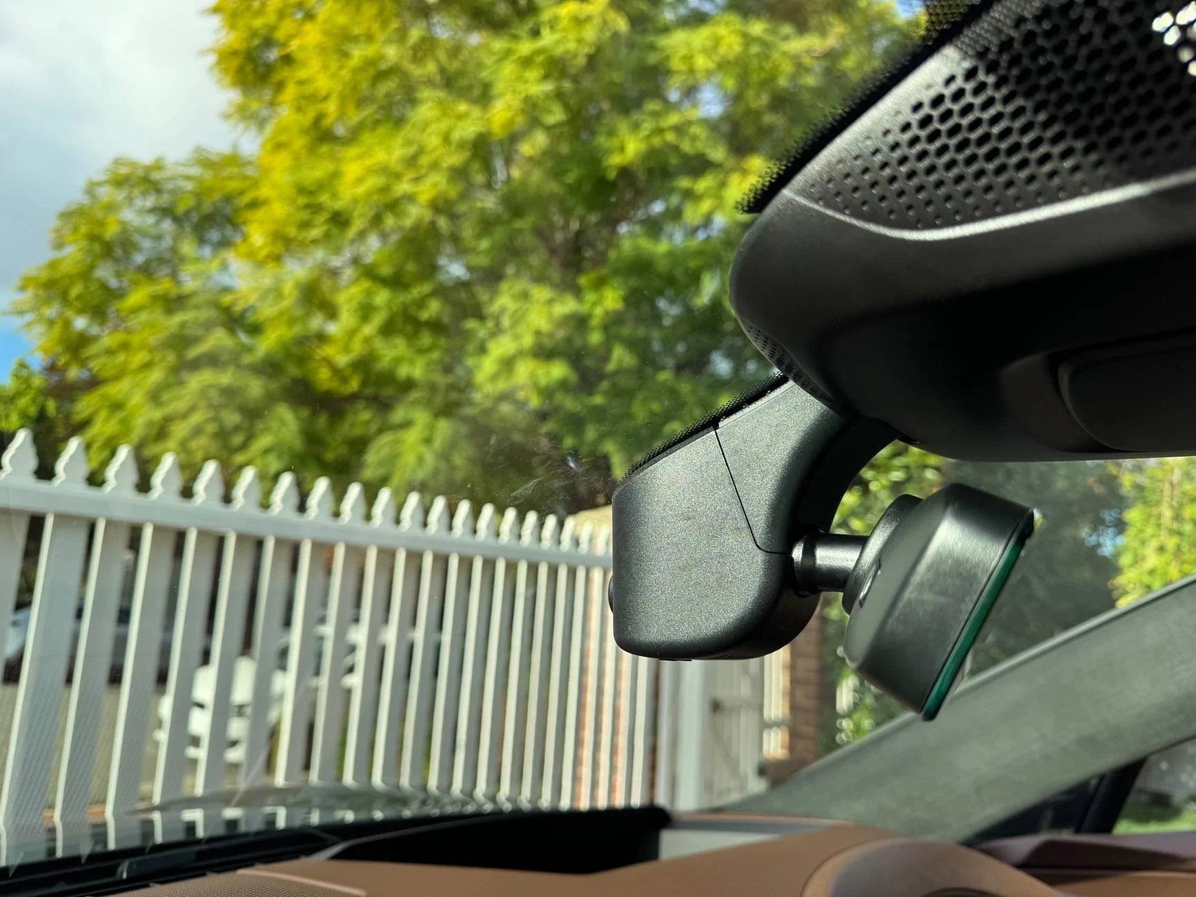

Electric Macan EV Macan EV Turbo Ice Gray Delivered and WOW 🤩 IMG_3348
Thanks!! Just reporting another success story with Fitcamx! Took us about 4 hrs with the install video and your hot tips to finally get it done… whew!!
Can you please detail out how to remove part #2 after removing #1? I have struggled a lot to remove #2.... Do I need to detached the mirror after removing part #2 to install fitcamx? Please help.
Part 2 is as per the video, turn counter clockwise (with some effort) and it comes off. The shell that forms Part 2 is then replaced by the FitCamX.... every step of the install is tough as.
I have seen the video you attached. I tried to turn it counter clockwise, but failed. I might need to try again with more force... Anyway, thanks for your help!
