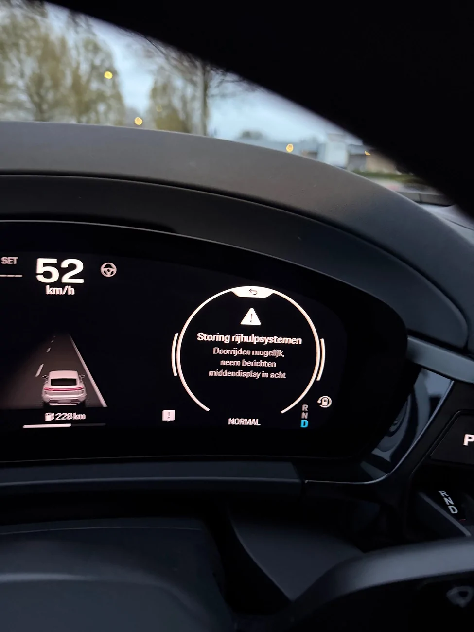

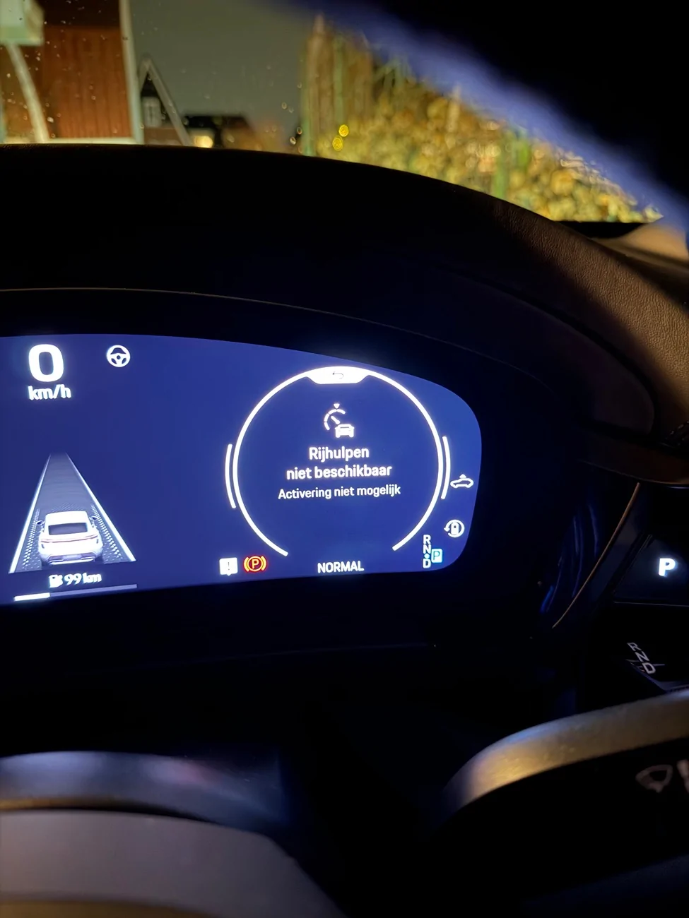

Just got the update last Friday (today is Monday). I received an print out of what was done. Lots. Took 3 hours.
So ... When driving on the weekend here is what was happening: the Android Auto would shutdown; the home screen would appear (with all the apps); then that would suddenly go black; the Android Auto symbol would appear; and my music would then continue playing.
This little interruption would only take 10 seconds or so and I was back listening again to my favorite song.
The annoying part is timing - this happens about twice per 10 miles (3 times per 20 km).
I thought I could "change its mind" so I switched to the radio. Within 3 or so minutes it went through the loop above and took me back to my favorite song on Android Auto.
I'm booked in for a check on the software Wednesday.

is it one of the "known bugs" that my Macan is not saving it's settings on the driving profiles?
When I set the spoiler to the up position it only stays there for 2 seconds, flaps down again and option get's disabled. Using the save button tells me it is saving it as a custom profile but the option gets ignored. If so, I will contact my dealership at Amsterdam, just picked the Macan up one week ago but I think I did not receive the latest update yet.
In NORMAL-modes he saves the settings, in SPORT en SPORT PLUS he doesn't.. That was the problem in 28.11 and in 28.13 it still exists.
And about the update of Innodrive in 28.13; got all the issues back again.. First it started with the error that the assisting systems stopped working during driving. This morning I got the message that it wasn't possible to activate the assisting systems at all..
Already sent an email to the dealer again.. Will be the 6th time since August 22 it will go back!
