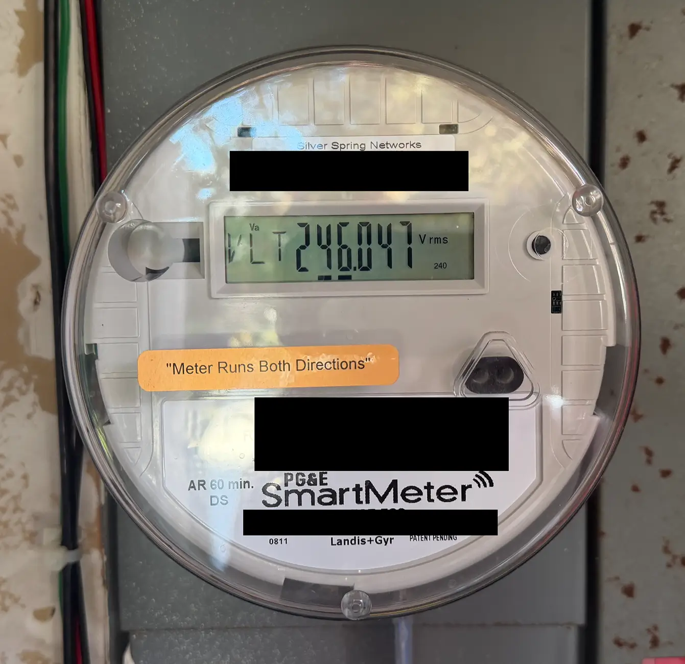

my voltage right now is 246 volts
my 2024 Macan Charges fine
my 2021 Cayenne eHybrid charges fine
my son's 2022 Tesla Model Y charges fine
my neighbor's Range Rover hybrid charges fine
my other neighbor's Audi Q5 hybrid charges fine
my friends Audi Teton charages fine
etc
if Porsche has updated their software to have strict voltage regulations they are going to brick _MOST_ (all?) of their fleet…and they will have to back out that change and release new software
although I highly doubt that voltage is the root cause here as to why your Macan is not charging - but hey it's software it could be anything
there is simple fact here: car is broken, it used to work, software update is the change - Porsche must fix it under warranty or buy the car back as defective and non-functional.
all of my equipment and vehicles work just fine at 246 volts - and I've seen my meter as low as 218 volts on a hot day in august in California when the grid is under extreme duress…
etc
