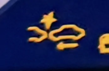

Can you comment any more on these specifically?
  • The yellow car where?
I believe the 'yellow car' is the one icon on the lower mid dash, when you first start the car, I think its forward collision system indicator (but I could be wrong).
Currently, it stays on for a while until you drive long enough, then it goes away.
I don't believe there is ANY improvement to this, the warning light for this seems to be on for the exact same amount of time as before, and any improvement to this is a placebo.

Sometimes it was on for 5 minutes, now hardly over 30 secs. So far for your placebo.
I think it has to do something with faster / improved calibration after a cold start.
I can with 100% certainly tell you that not any one example (mine or yours) proves anything. It's not a personal challenge to your experience. This is why started my sentence with "I believe..."
I have not had the forward collision yellow light at startup improve in any way that is notable. I can drive for 3 or even 4km (upwards of 5 min in residential streets) after leaving my garage - before it turns off.
If you're hitting the freeway soon after you start your drive, maybe there is a difference (or read that as a different start to your drive), it could explain your experience being different.
