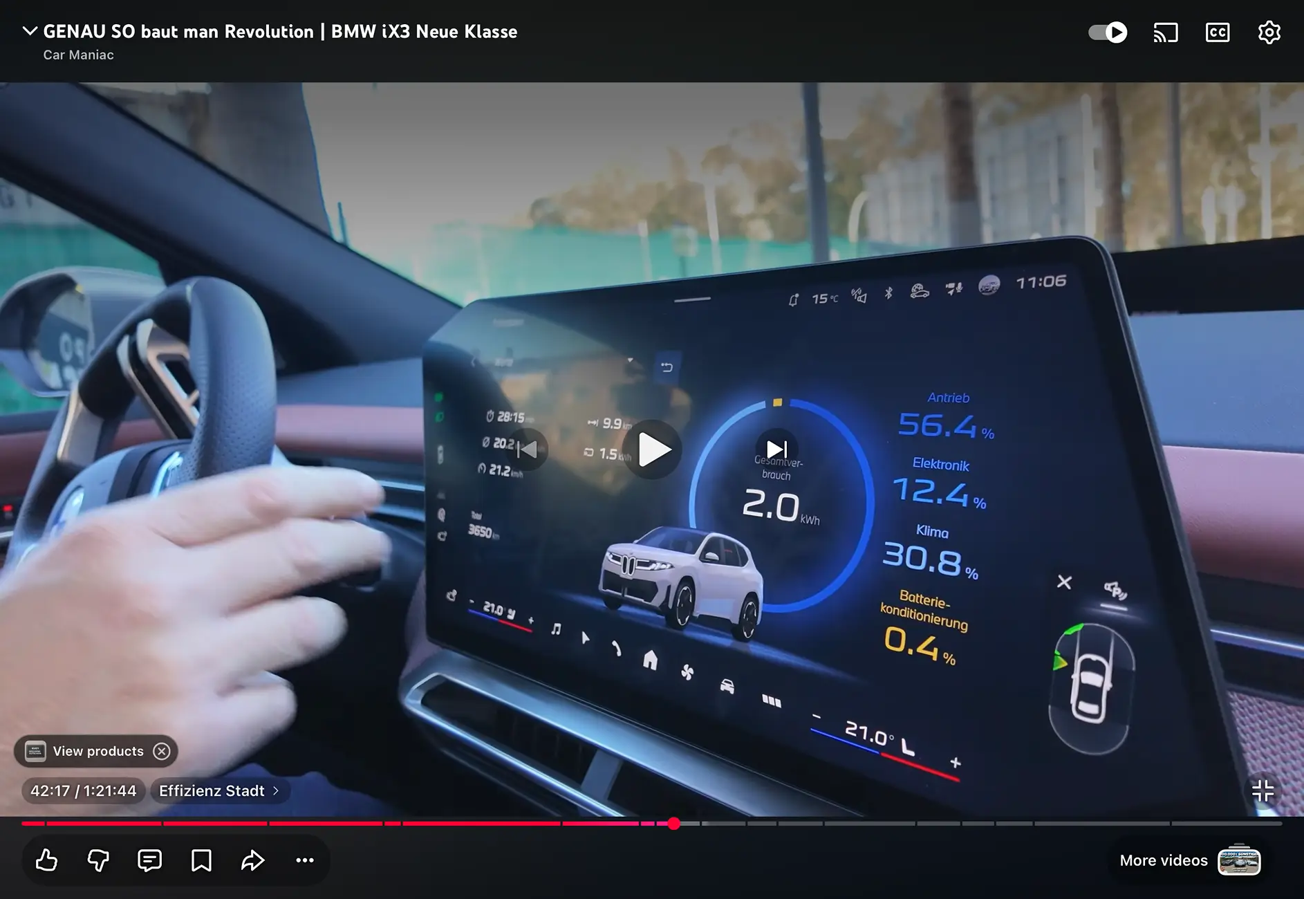

we do not have this for porsche. but the new bmw ix3 neue klasse is using 30%(!!) of its consumption for the AC.
15c outside, AC set to 21 c
Electric Macan EV Preconditioning & charging planner IMG_0185

30% with AC set to 21C and 15C outside seems like a lot but is the car is stationary?

The car shows a total consumption of 2.0 kWh, it's probably stationary

Yes, filming and so on so yes lots of stationary moments, I see this too when waiting for my children to get from school … the only difference in a Porsche you do not have the stats, so you need to calculate / guess it yourself, Porsche claims users have enough money and do not care so no need to know this. BMW is full of stats, also in the App, but in my iX no battery temp, but that car is 5 years old 🤣
