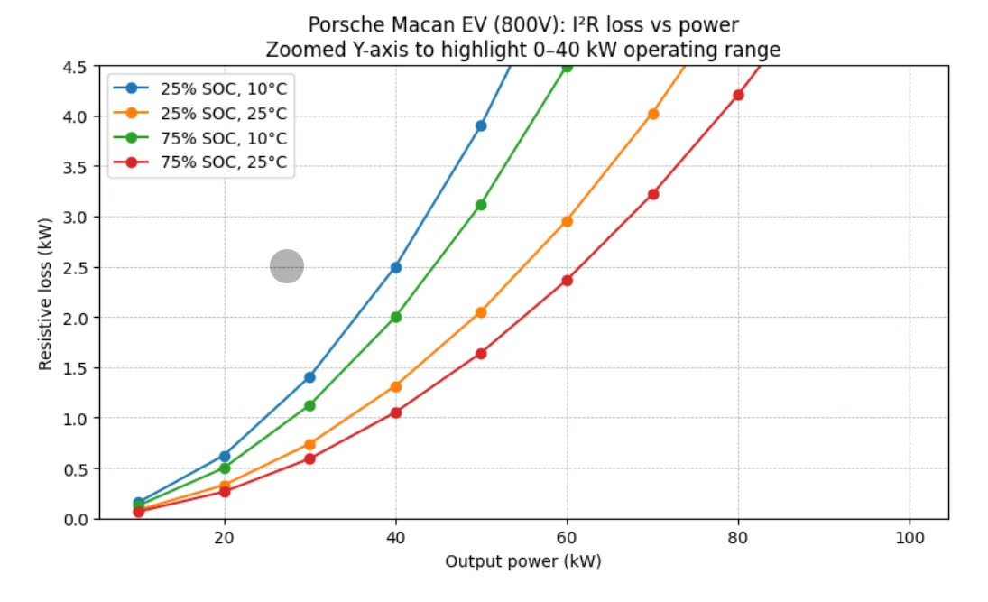

AC charging would not have heated up my battery from 9C to 23C … fast charging it gets it to 40C and AC charging will help it keep temp so it will land around 23C otherwise I would loose all the heat and if you would have seen my other post you would see that also consumption would be lower with a warm battery otherwise I would never had have had 24.9kwh/100km at average speed of above 102km/h (had a traffic jam, but otherwise was driving 135km/h when permitted)
Internal higher resistance aka higher consumption when you drive a colder battery
Electric Macan EV Preconditioning & charging planner 1766185600263-uq
I will drive back home with a cold battery but conditions will not be the same … will report back. But I will pre condition as I have a friend that already is annoted when I stop more then 10 minutes …

where is this chart coming from ? ( also the loss is less than 1 kw ? per hour ? per 100% charge?)

so 1kw extra seems not a lot, but that is 1 to 2 kWh extra per 100km and is why I get 24.9kwh at 130km/h and others get 27 in colder conditions … the chart is a research done by ChatGPT 5.2 on initial internal resistance of NMC batteries and then let it did some research on the total number of cells for the Macan at 800v and it is pretty well in line with my real life consumption related to battery temp … so I double verified it with driving the same test route I have under the same conditions, only variation being battery temp … it really is underestimated, not only fast charging but also capacity and efficiency are impacted
Everyone should decide if it is worth the extra effort, I do and it pays off in my view … stopping 63 minutes instead of 83 … one can debate if that really matters … for me yes.
We all know that colder conditions have higher consumption up to 25 even sometimes 30%, I estimate that battery temp is responsible for around 5% and another 5% in capacity loss so combined it gives … but hey you do not need to believe me (the other 15 to 20 go to heating and wind resistance … you can go seat heating only, but that is not for me)

precondition needs 3kw/1c

I never saw 3kwh per 1C by that logic I would loose 30% for 10C heating … I never saw that even with a cold battery and if that would be the case my routine would be a hard recommendation As that eliminates 95% of the power needed as the fast charge + AC top up the night before takes care of the cold battery.
Also, but I’m not 100% sure and should look for a more technical review I think pre conditioning also can use heat scavanging, recuperating heat from the engines like Tesla does.
I see some slight elevation in consumption, but as i can charge at 270kw it adds maybe 1 minute at the most in the first charge, as another benefit because of it I heat the battery during such charging sessions easily to 40-45C making the consumption of the car drop further and making pre conditioning for the next stops almost none existant

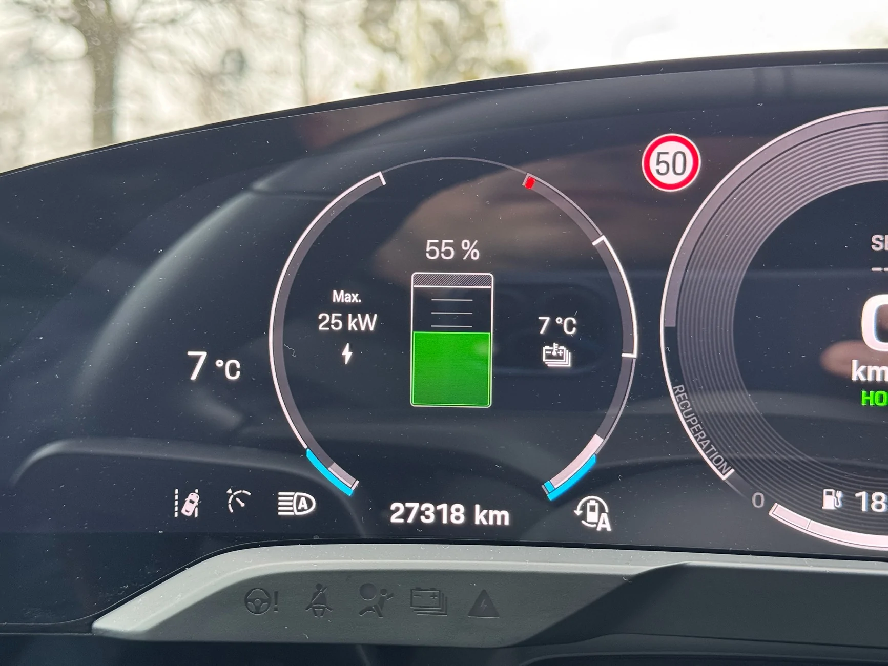

I think this discussion shows there is a discrepancy between some theoretical assumptions and practical observation which differ.
What helps you a lot to understand how the charging process works is what Taycan shows and what Macan lacks. It's the maximum charging speed you'll get given current battery temp and SoC which is displayed all the time even when not connected.
This is very useful and very informative. What is shows is that battery even slightly outside of optimal thermal window can be not just "slightly slower" to charge but A LOT SLOWER to charge and it aligns with many observations here about Macan.
This is not even very cold weather and with 7C it's max 25kW for a car that goes up to 300kw.
What I also noticed is that when you approach a charging station without prior preconditioning with cold battery it takes a lot of time to get to the level of max charging speed - I don't know why, just based on my several last charging sessions. It can DOUBLE the charging time. I picked up the car from Porsche with 40% SoC and cold battery at 0C and was not able to get fast charging even after 10-15mins after I connected it to Porsche DC charging station.
Electric Macan EV Preconditioning & charging planner IMG_9580
All this shows you that what's most important here and what has the most impact is the software controlling this process. And how it works is hard to tell even when it's not buggy which we know in many cars in can be.
So to get the best experience you should be using Route Planner and not try to outsmart it in any way.

With MY2026 (and hopefully an update to existing cars) the Macan can also show the current maximum charging capability.

Great, this along with the SoH are great examples of new software that adds value.
Somehow I wouldn't hold my breath for updates for older cars though...

That is something my ID3 does for over a year … there really is no reason not to give us that in an update … also the Cayenne shows it as well …
