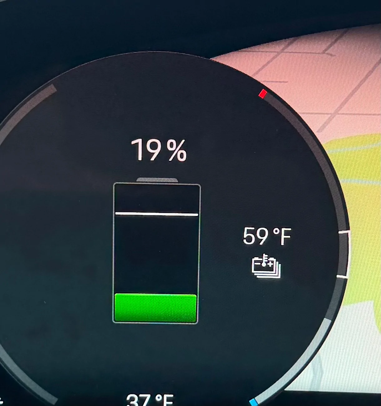

Started the morning out at 30°F/-1C. Nothing special done to precondition. By the time I was getting close to the charger the outdoor temp was 37°F/3C and the battery temperature was 57°F/14C (lower than the video, they say battery is 17C!) just from driving. When I finally stopped I had a much lower SoC than the video at just 3%.

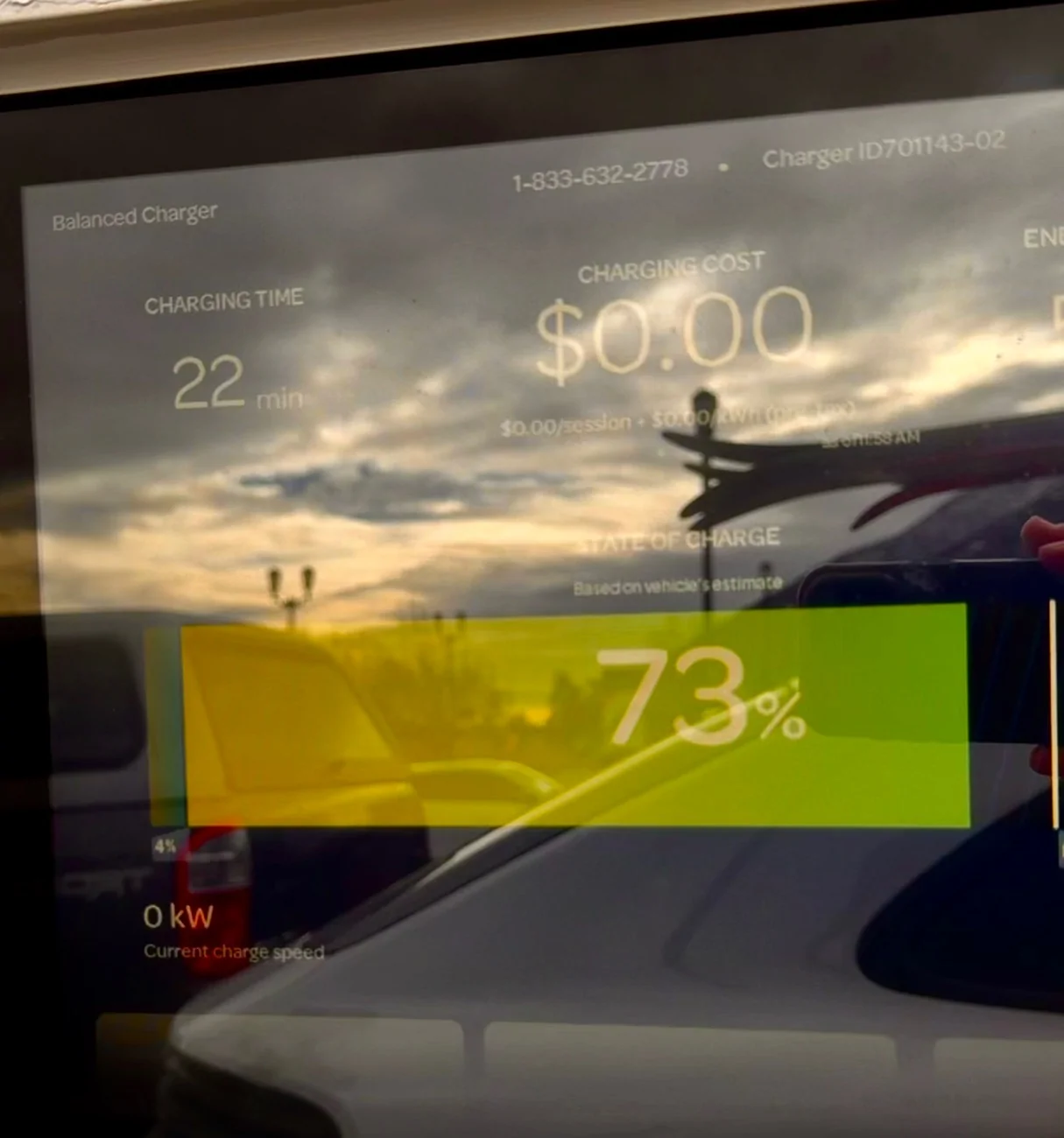

Just finished and pulled into another spot to finish up this post. The chargers were balanced and the station was packed, so I feel like it could have done better. Still I managed to go from 3%-73% in 22 minutes, peak speed I saw was about 206kw (probably due to balanced stations).

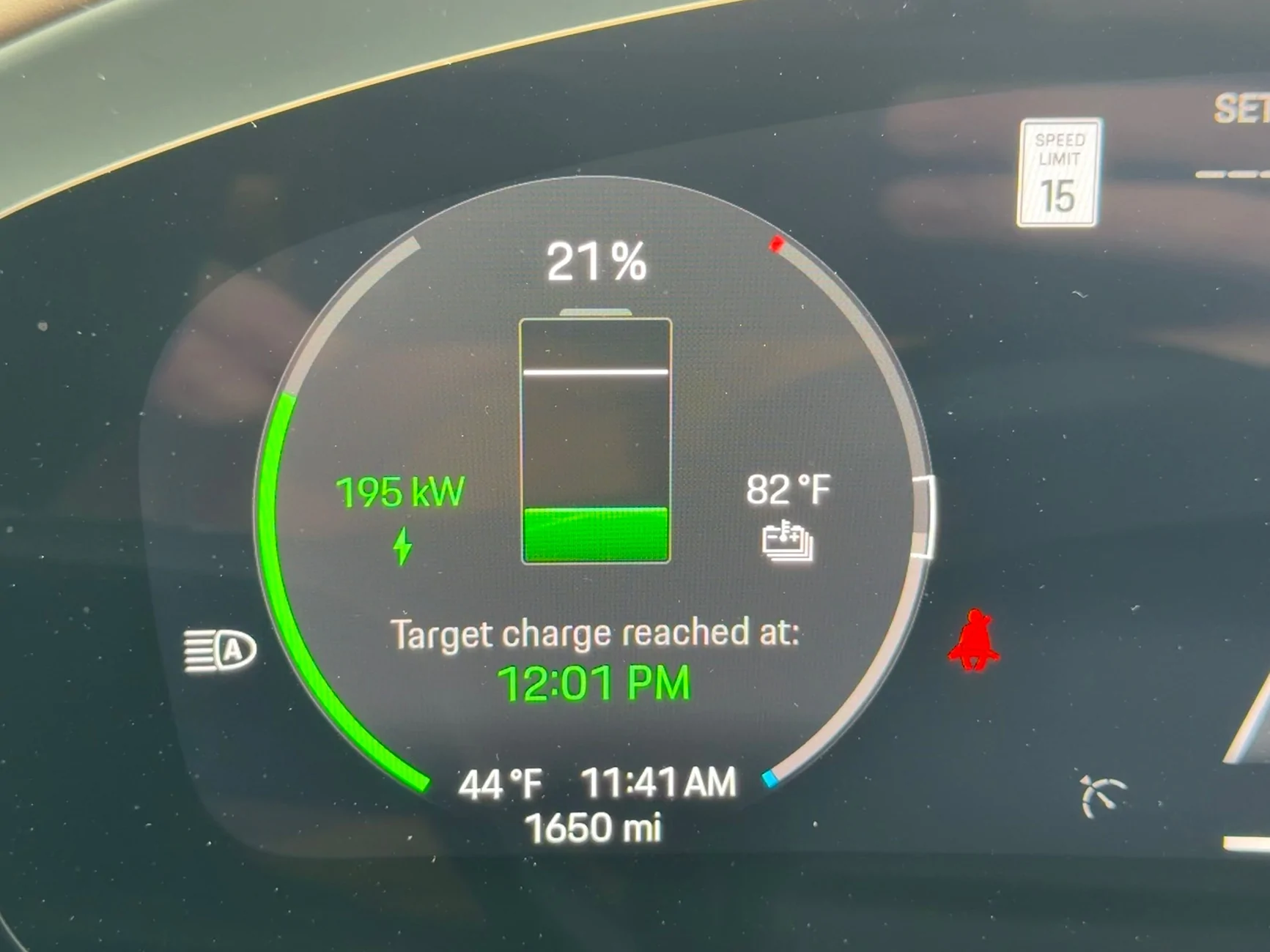

I noted that the battery jumped to 85°F/29C within the first four minutes of DC charging, and after ten minutes it was at 107°F/42C. So even if it just wasted a few minutes getting the battery temperature up to the sweet spot, no big deal for me.

And not to be picky, but you are not showing the charging and the temperature in the same shot … In fact you are not charging when showing the battery temperature …
The pictures I posted Clearly show me charging and temperature, both are shown in the circle …

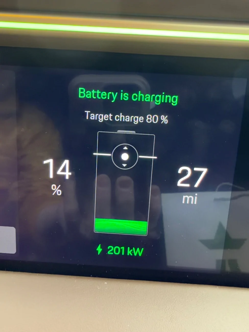

I took the battery temperature shot while driving , and later after charging I took a shot of the charging display in center screen.
To get charging rate and battery temperature together, here’s one took just a minute or two after my last shot. Looking at the timestamp it had been charging a little over four minutes at this time.
You can see that the battery temperature is already jumped into the sweet spot. You can also see that it is starting to dip below 200, but the readout is really quite bouncy and jumped between 195-205 for the first five minutes or so.
At any rate the point for me isn’t whether I got the max possible performance in winter, it’s whether it’s fast enough for me not to worry about it or it being worth switching away from my preferred navigation.
