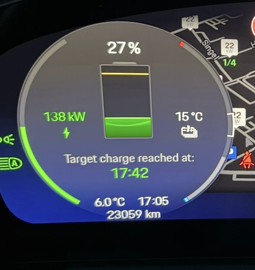

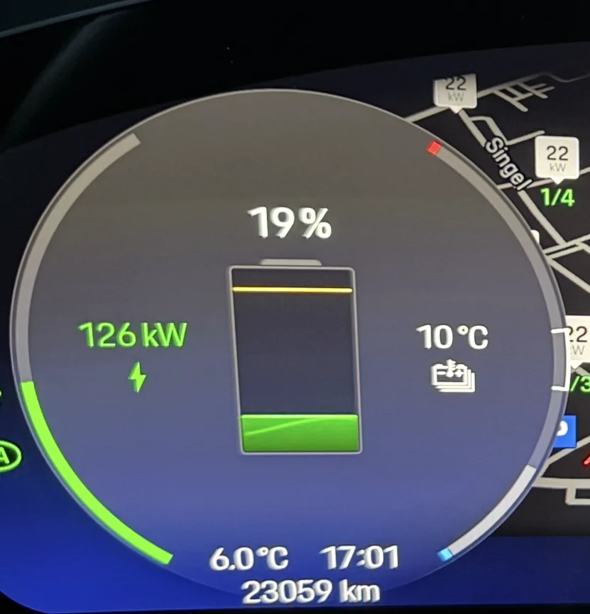

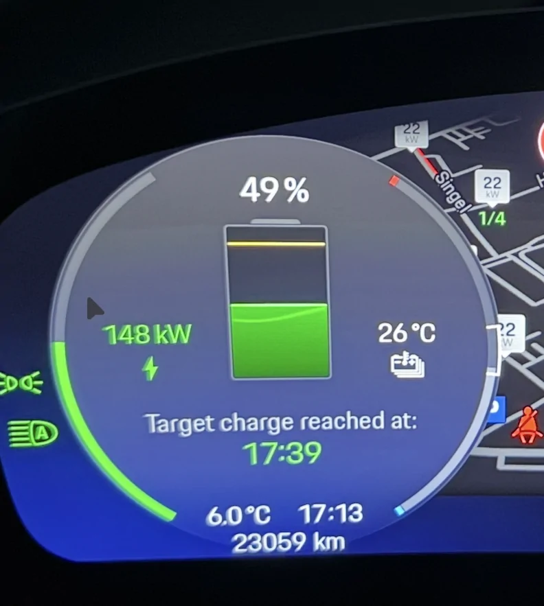

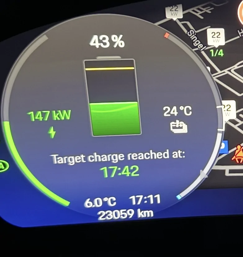

At the site that can deliver 350 per stall and I was alone at my stall and one other 400v car at another stall, close to the end a Q6 arrived and used the 3ed stall so no shared power and always full power to myself …
What I’ve been telling all along,
from 19% to 49% 12 minutes / 30% charged, battery started at 10C and reached 26 at the end, went further up to 28 after charging stopped, no real increase, as other people have mentioned one stays on the degraded charging curve
I repeat, no pre conditioning you loose 2x the time when you drive the car between 10 and 60%, little less if you charge to 80, but why should you waste time to 80% even the Porsche Nav hardly will go that high for the exact same reason!
12 minutes, the car had been driven 50km that day, 25 just before the charge at 120km/h … so it’s not that it was from a cold standstill either … the battery did ”heat” up during the day by 2C, so from 8 to 10C
My car is perfectly fine and will do 270 kw anytime of the day when pre conditioned …
Make what you will seabird will say that this is either not scientific or that there is a defect with the car or charging station, I can assure you there is none!
Electric Macan EV Preconditioning & charging planner 1764952169104-8
Electric Macan EV Preconditioning & charging planner 1764952048532-q4

And a picture of the middle part charging
Electric Macan EV Preconditioning & charging planner 1764952663470-ln
Electric Macan EV Preconditioning & charging planner 1764952722838-a5
may be. the point is that the heating of the battery would cost so much energy that there would be no gain in charging time. the car calculates this and act accordingly. when you leave with 10c battery temperature and need to charge soon it would 1.) not even be possible for the heatpump to heat the cabin and the battery (at least one hour for 10c) 2.) it would cost so much energy that charging would last even longer. The car tries to reduce charging time as good as possible.
