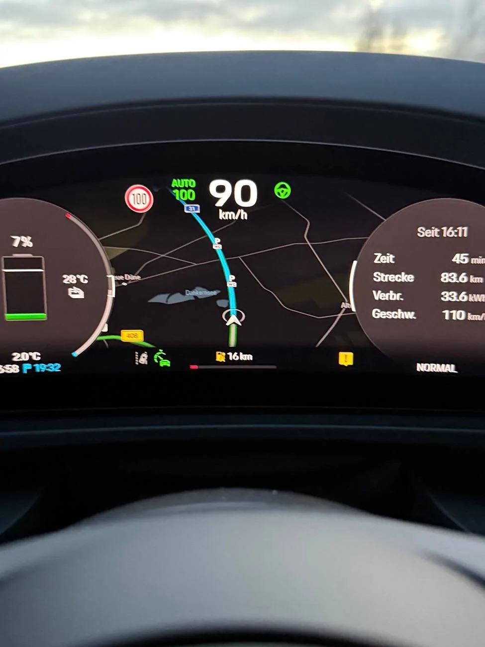

I drove several Teslas before the macan and I’m pretty comfortable driving the battery to 2-3%. On my first roadtrip with the macan I tried to do this like I’m used to, but experienced the same behavior.
If there is 10% battery left you should have another ~50km. But not so in the macan, below 10% the macan seems unpredictable. At 7% it showed me 16km range left. If you do the math, 16/7x100=228,6km so that algorithm seems dumb and not calculating very well.
Hope we get our first OTA soon to fix this.
Yes but, when driving on B roads that, in my case 12km turned out to be much more …
In your case if you calculate 95kwh battery with a 5% heat loss is 90kwh usable at a consumption of 33kwh/100km that 7% would equal to 18km of range … pretty OK …

Another factor: ambient is 2 degrees but battery is 28 degrees. How did it get there? Must be preconditioning. I have to think if the battery is being heated, range will decrease. Why was it heated to above the minimum efficient temperature, I wonder.
