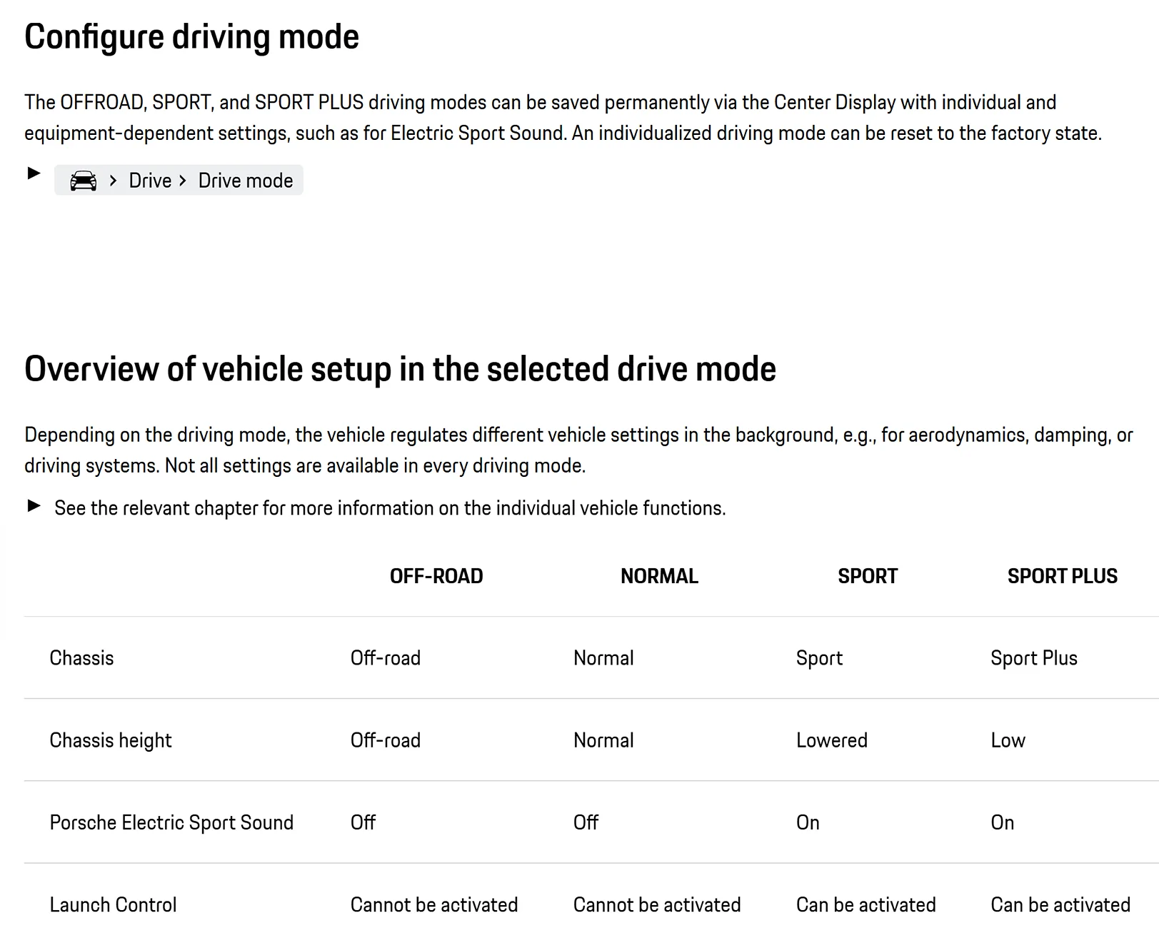

I have it on my Macan and I am looking to turn it off permanently. It's possible in the comfort-drive mode, but not in sport and sport plus. Really annoying fake buzzing sound!
Just turn it off in the the Sport and Sport+ drive mode settings and store them.
