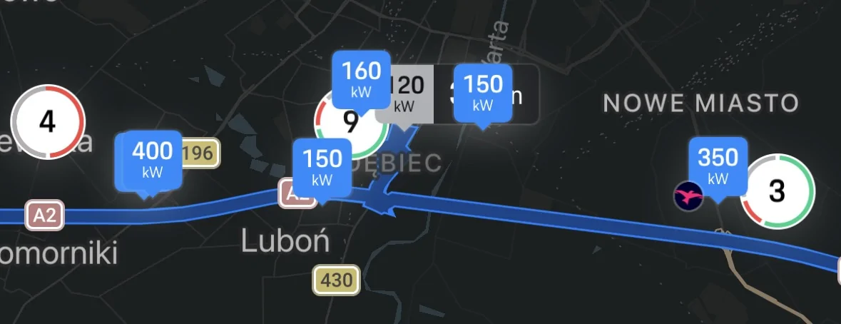

Is it just me or have the mobile app and PCM route planner gone totally dumb over the last couple of weeks?
It ignores preferred charging networks (IONITY in my case), selects charging stations with way less power when literally right next to them are available chargers twice that fast.
On my usual route which I take almost every week it now suggests literally the slowest possible charger even though there are plenty of other high speed chargers available in much more convenient locations including preferred charger IONITY.
Electric Macan EV Route planner getting dumber? A9CE350F-701D-4C4F-A78A-830A9BDB6B29_1_201_a
You can override it manually in which case the charging time drops and arrival time is much shorter. W#%?
