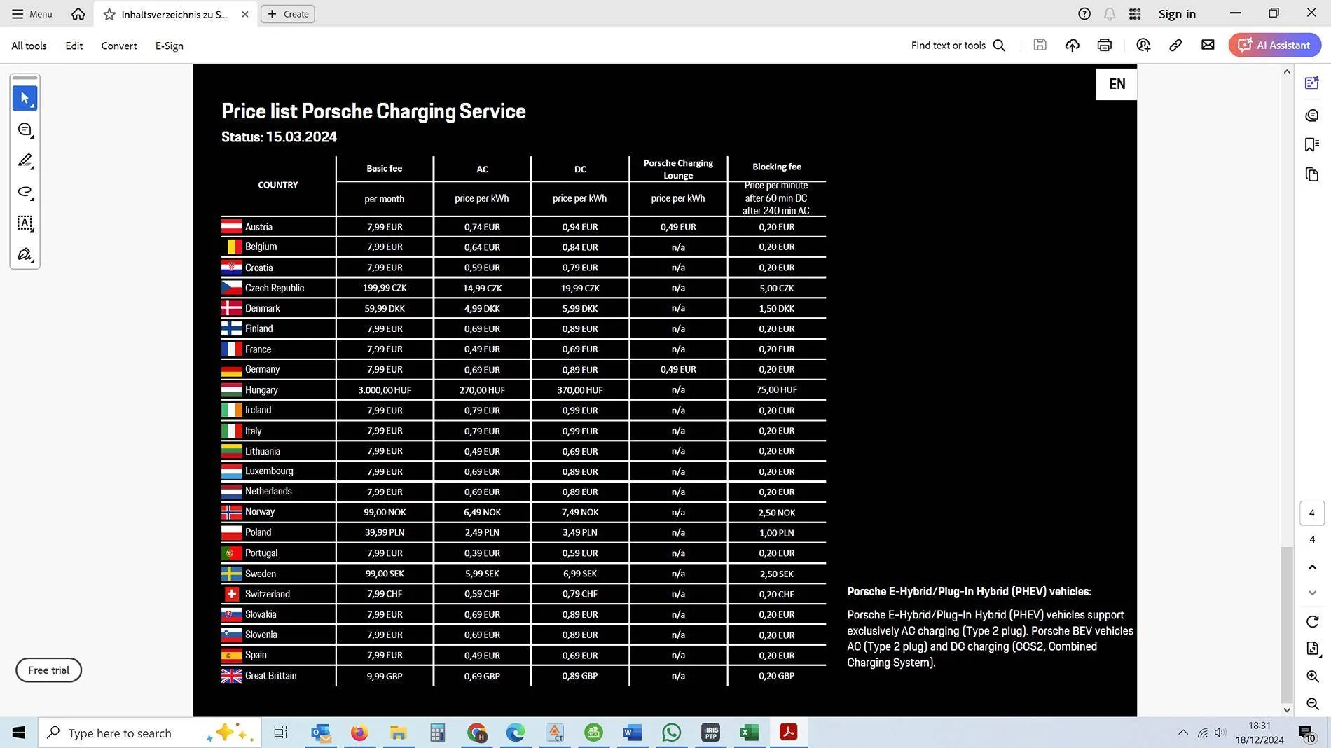

It’s in the fine print, but yes, they should be more proactive and tell us. See the last line on this, on the ‘Price list Porsche Charging Service Plus’. This was emailed after the handover.
1) Preferred partners: Porsche Dealerships (DC only),
Porsche Charging Lounges, Porsche Factory, IONITY

The Porsche card should also work at Gridserve, Fastned, Osprey, Shell, BP, ChargePoint, Mer, MFG, EON.
Yes, quite right, but the point here was they are far more expensive than Porsche's Preferred partners, ie Ionity or Porsche's own, at £0.39 per kWh
