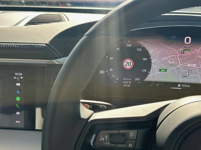

I have another issue - I manually changed the time after the clocks changed to BST. The time on the instrument cluster display is one hour adrift from the time on the centre display. I have tried a reboot, re-setting the time but cannot get them to synchronise. Can be seen in this photo:
Electric Macan EV Summer time - not updated automatically SdC - 1
Does anyone have a fix?

Mine didn’t change automatically, despite being set for that. I then changed it manually. I got in this morning and set a destination and noticed it was reporting it was going to take me 1:10 to drive 4 miles. The dash clock and driving screen showed the correct time but the PCM was an hour out. I pulled over, turned off auto-change and then turned it back on and voila ! It then reported I would arrive in 10 mins.
