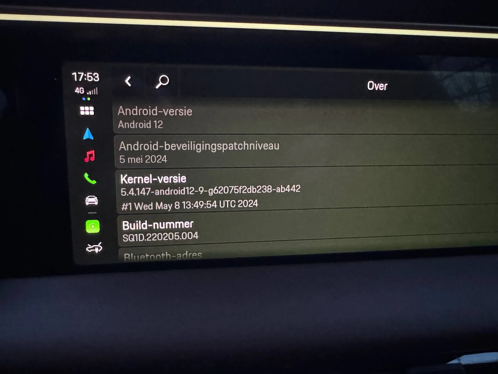

First few park manoeuvres it seemed ok but I still get the proximity sensor view instead of camera top view. Current pcm software version:
Electric Macan EV Surround view not showing up consistently. IMG_4299
Not sure anything was changed/updated at pcm level.
