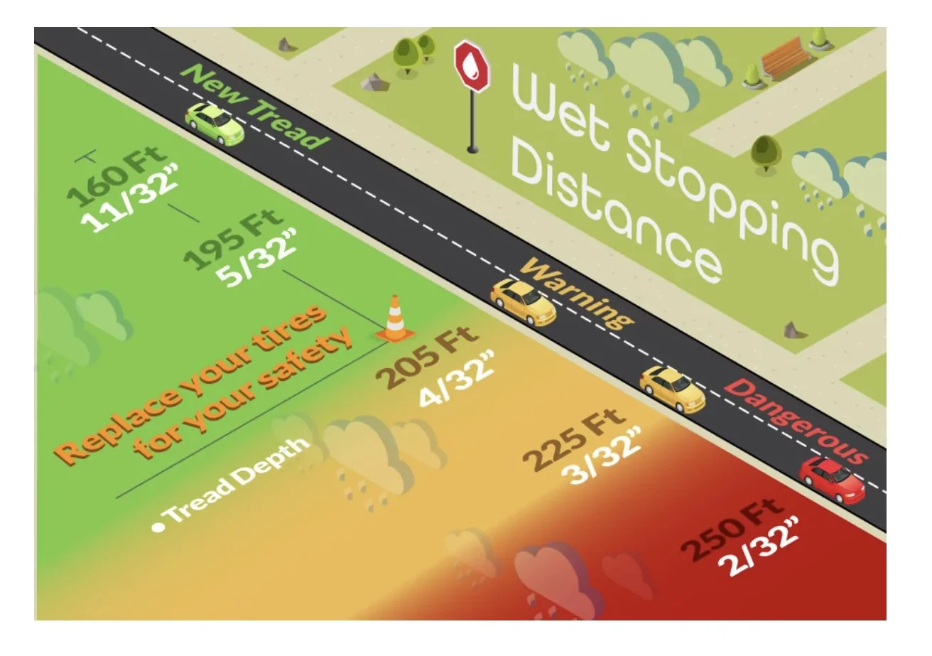

The less thread the longer stopping distance, especially so in the wet. From Discount Tire’s URL:
Electric Macan EV Tire Wear IMG_6069
4/32” is my absolute minumum.
