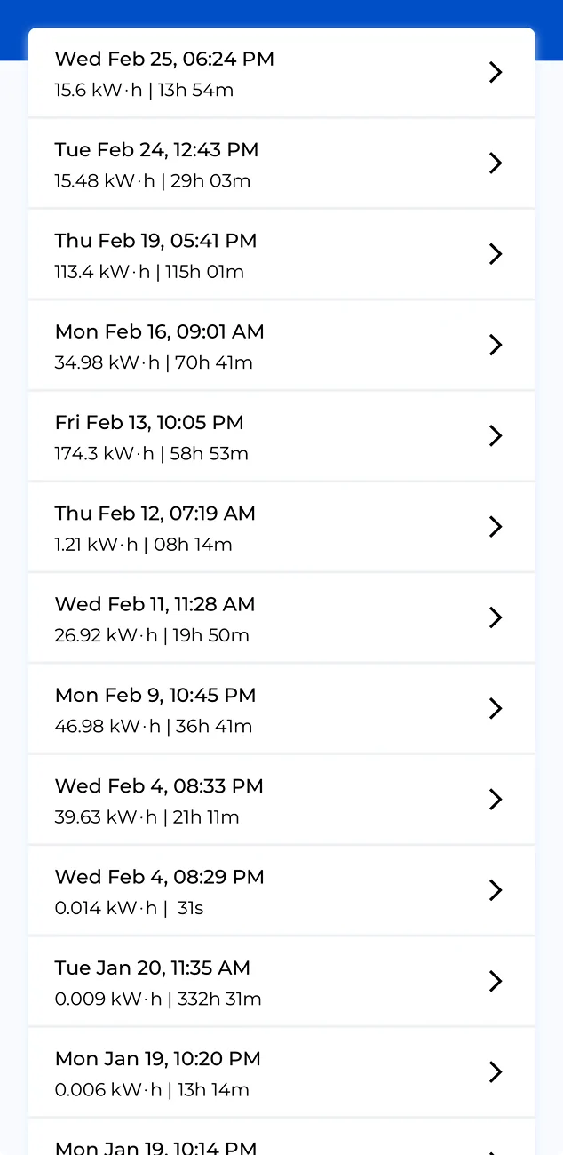

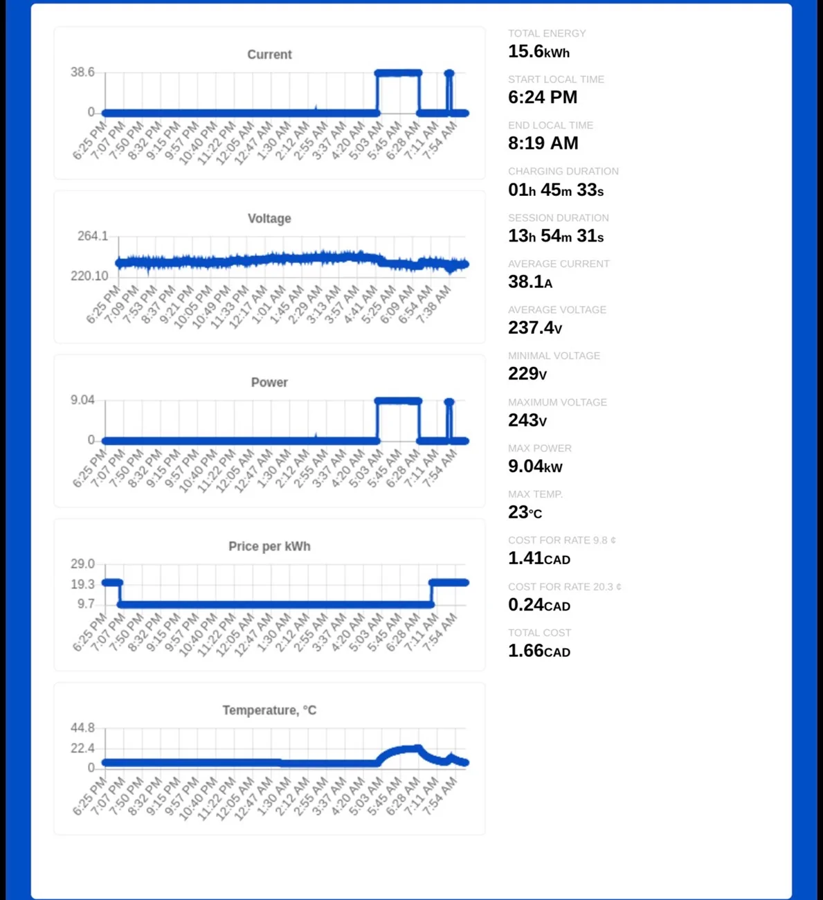

Like Feb 19th, my charging session apparently lasted for 115hrs. Last night, I powered it off to close charging session, and as soon as I powered it back on, it started a session even though the car wasn't plugged in at 6:24pm.
Based on last night's charging, my voltage ranged from 229v-243v. Sometimes it can go as high as 247v

So not sure what to make of this, but the past week my car has charged perfectly fine without an issue and voltage has been all over the place. Yesterday started charging at 249 and 248V.
I am a bit surprised that after consistently having an issue for a two week period I have now gotten to the point where it is charging immediately w/o any work arounds to make it happen.
I am going to avoid using departure timers for the near future just to be safe and see if the instant charging continues to work. The one other thing I may try, is to go to a fast charger over the coming few days as the last time my troubles began shortly after a fast charging session. This could mean that it is tied to battery temperature and if that is the case my issues may arise this summer.
Hopefully some of the other investigations being done for others will yield a result as at this point I am just tossing up my hands trying to find a cause and effect. I am going to cancel bringing it into the dealer as the dealer is 45 minutes from our place and they would look to hold the car for day or two.
