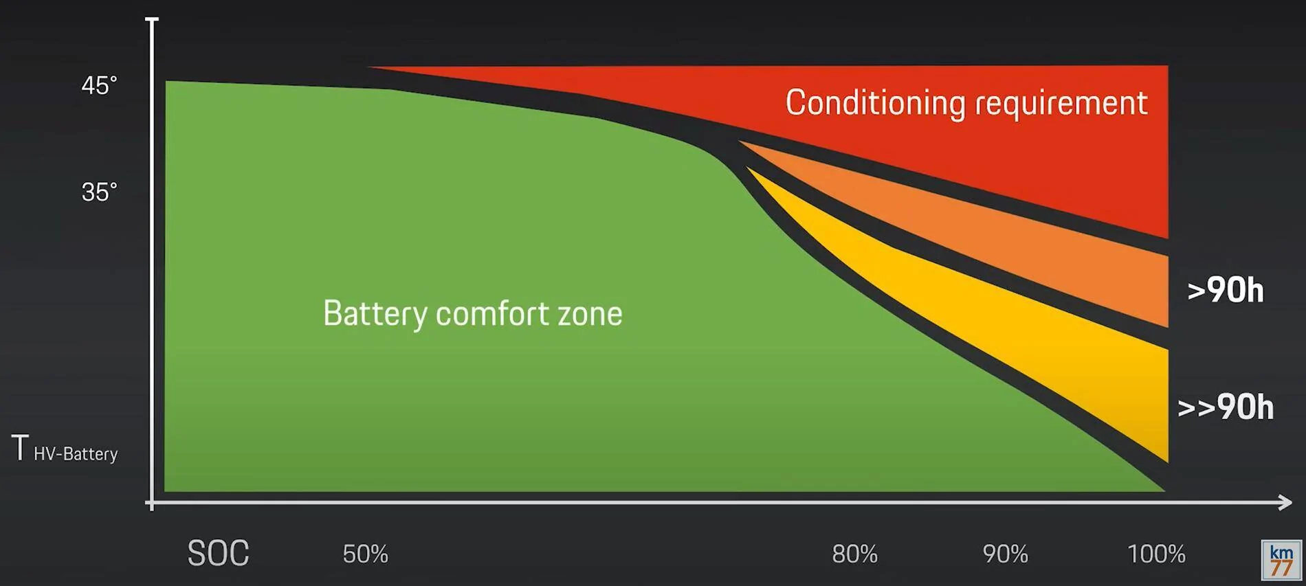

The good news is that Macan seems like has a unique and smart feature: it will automatically discharge the battery if it's charged to high SOC levels and the outside temperature is high. This helps reduce battery degradation. Here are more details:
Electric Macan EV Is Fast Charging Bad For Battery Life? -- Engineering Explained Answers the Question 1728154919015-78
