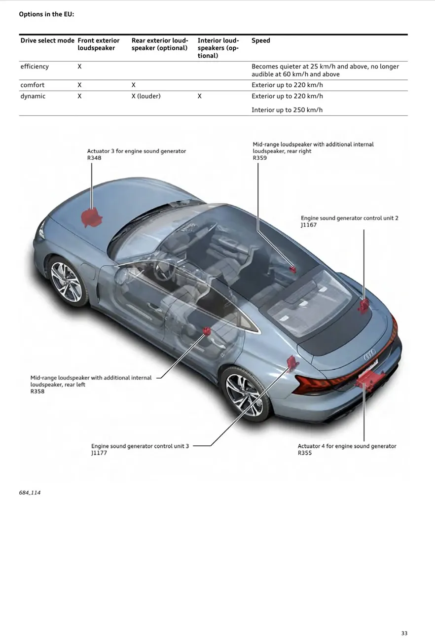

Looking at the youtube video (link below) and attached pic it appears taycan brother has:
2 external speakers (1 front, 1 rear)
2 internal speakers (1 left rear, 1 right rear)
2 control units (1 for internal sound located left rear, 1 for external sound located right rear)
The front external loudspeaker is standard as this does the AVAS sound (pedestrian safety). If you want the sport sound you get the rest of the kit.
Still none the wiser if the sound system affects the sound, I mean if these are extra active speakers you can have any sound system, it will not make a difference to the sport sound.
If I had to bet, the sport sound is an independent system (4 active speakers/2 control units), Bose/BM does not make a difference. Well is does as Bose is crap, don't make the same mistake I did.
For Macan I have no idea as I do not have it (hate the fake sounds).

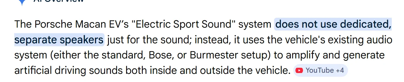

Sport Sound doesn't add any speakers on the inside of the cabin, and there are no manual volume controls for it. The stereo volume doesn't affect the Sport Sound -- in fact you can have the stereo off and you will still get the Sport Sound.
I wonder how you know this and if there is any evidence of this. I think you are right, but the group here needs proof. Google says the same thing, but we need a source that would confirm this.

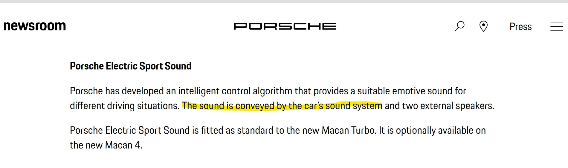

Here it is from Porsche Newsroom Australia version, but nevertheless.
https://newsroom.porsche.com/en_AU/...irst-all-electric-suv-from-porsche-38004.html
