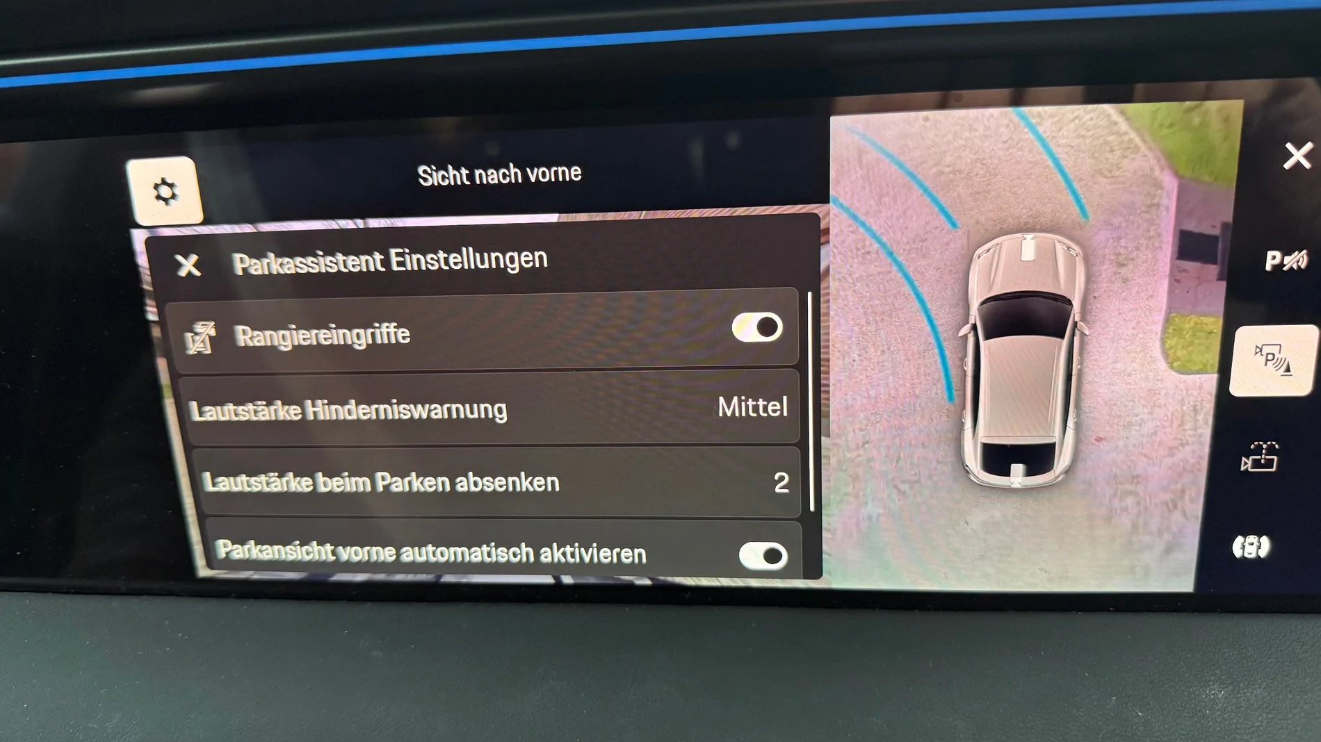

My Camera screens suddenly went German this morning.
Reassured that others have seen something similar - and that it may revert without intervention.

I had the software update done recently and since then the camera screen is in German as well.
