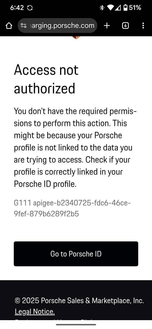

Also, the guest app won't work for charging. I get the follow message. Any ideas?

In the My Porsche app check Vehicle details > Functions > Charging and click on wheel (upper right corner) to see if Plug and Charge certificate is installed. If not, request it. Once installed, Plug and Charge should work. It may take a while for it to get installed. If you are unable or it doesn’t work, call Porsche support. They are good at answering calls and will be able to assist you with it. Don’t bother emailing support as you get an automated response and takes forever to answer your questions.
