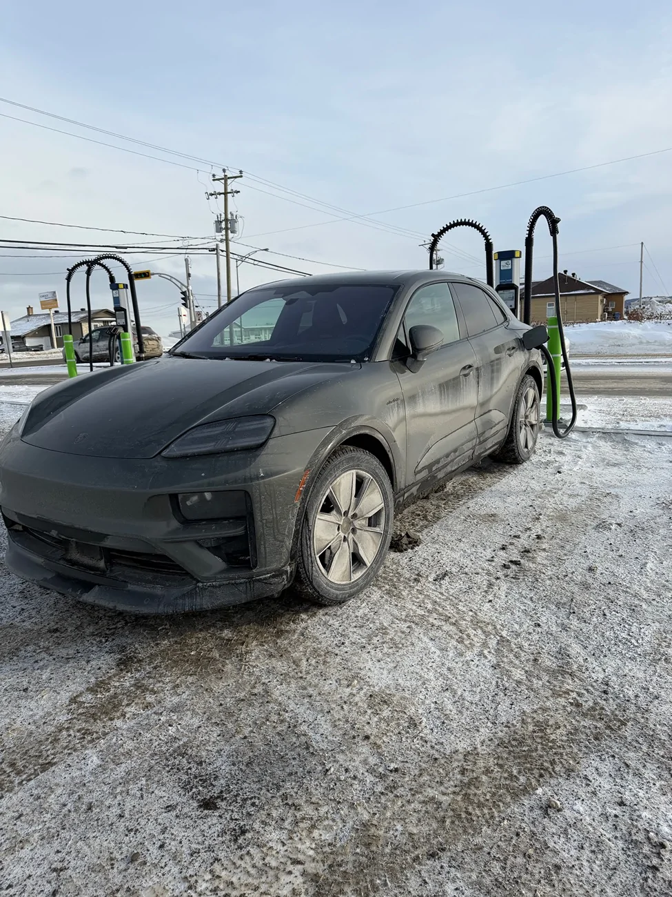

Electric Macan EV Long trip / cold start IMG_0411
Electric Macan EV Long trip / cold start IMG_0413
Electric Macan EV Long trip / cold start IMG_0419
Soooooooo
Sorry for taking a bit to respond but the ride back home unfolded as follow:
- departure 5h30 am / outside temp -25’C / Battery temp: -3’C (probable residual heat from last night DCFC charge up to 85%
- 963 km / 4 charging stops / charging speeds as high as 251 k! but mainly in the 100-150 kW because of the available infrastructure
- 11 hours driving time / 89 km/h speed averge (as half the ride was on regional 1 lane roads)
- average consumption: 27.3 kWh/100 Km
Outside Temp rose up to -12’C but lotsa snow for the 2 hslf
The PCM managed it all very good!
Thank you all for your inputs
