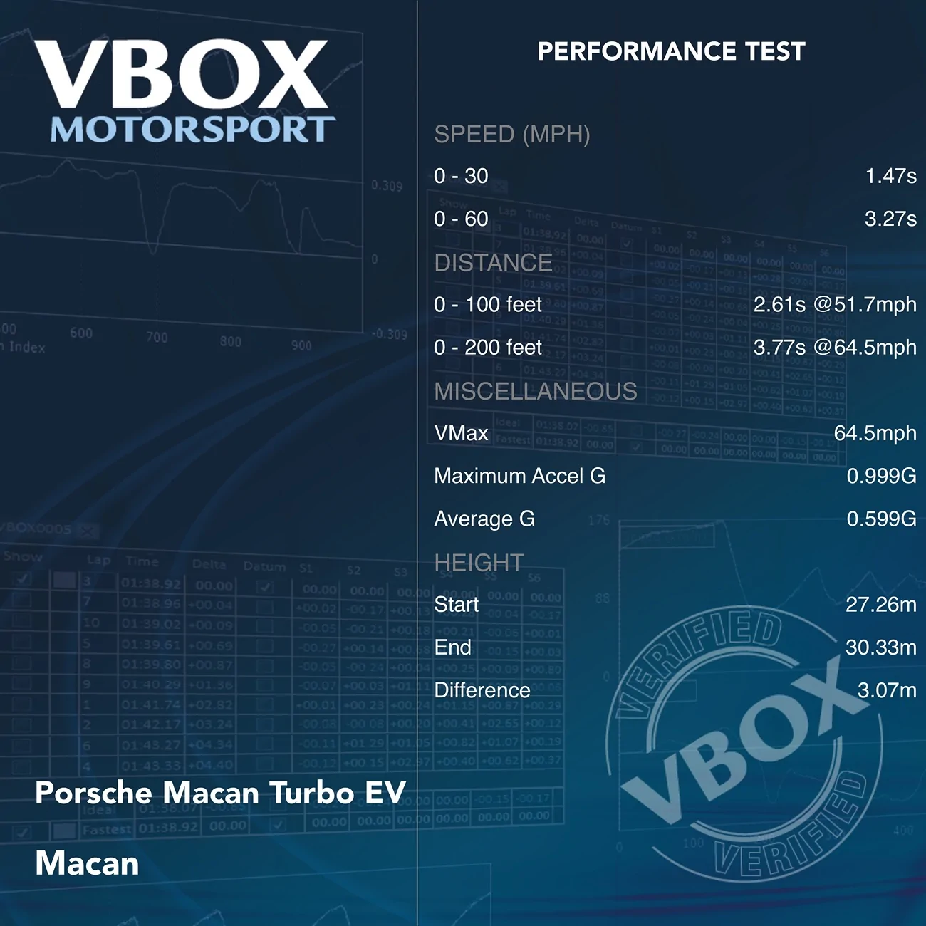

I’ve recorded 3.27s on a slight uphill with Michelin PilotSport A/S tires on 22” RS Spyder wheels. That’s from a Racelogic Vbox, which is going to be more accurate than a phone app.

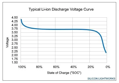

Battery packs don't have flat voltage - as the pack discharges voltage drops - there is no "magic" as voltage drops power drops...
there is nothing to regulate, you can't make energy/power out of thin air…
a given EV motor's power is based on "watts" being injected - the math of watts/kilowatts is brutally simple…
watts = volts * amps
watts = power/torque
less voltage at the same amps = less power - unless you increase the amps
at 65-70 mph the Macan is a 3.3 kwh/mile vehicle
since it's normally a 780 volt pack - we can figure the amps for 3,300 watts @ 65 mph
3300 watts / 780 volts = 4.23 amps
do this for exactly one hour you will consume 3,300 watt-hours (or 3.3 kWh) of power…from the 95 kWh of usable capacity from the Macan's battery.
as voltage drops (a natural and unavoidable outcome of pack discharge) you have to increase amps (flow/consumption) to keep 3,300 watts as the constant input to the EV motor - otherwise you'll lose "power/torque"…and can no longer do 65 mph
complex software keeps this all in balance so that the throttle responses are flat/linear/predictable - but again the underlying physics are brutal and unforgiving - there is no "regulatin" voltage - the voltage is what it is for any given level of pack discharge, but you can vary the amps to keep "power/torque" "constant" - but that changes consumption and therefore range if any given power level…
volts is roughly "power"
amps is roughly "flow rate"
you can keep the watts constant by increasing amps (the flow) - but there is nothing you can do to counter the voltage drop as the pack discharges…
it's physics and it's a bit unforgiving
here is the voltage curve for the Taycan for a given "cell" in the battery for example - it's unlikely the Macan (or any EV) cell discharge curve is remarkably different.
there is some brutal/factual/unrelenting "truth" here in degrees of freedom for the chemistry/physical of a LiON cell voltage discharge - they do what they do as "output" and then you can "adjust" things by changing your consumption rate (amps) - until they don't got no more to give at which point you shut down.

Sorry, a good part of this is just not true at all. I have an EE background. While the basic math here is sound, if you want to adjust power output you can easily do this via voltage regulation.
In your simple single cell example, we commonly slap 3.3v regulators in front of lithium cells to run low power electronics, which keeps the voltage and power usage consistent and as expected across nearly the full range of the battery capacity.
We sometimes use buck or boost converters to adjust voltage to where a load needs it to be. There are many ways to manipulate power delivery, we don’t need to naively follow a simple discharge curve.
I don’t know much about the specifics around EV power. I’d assume though that there is some power conditioning and conversion going on to tailor the power to the load. I’m not even sure EV motors are DC, they’re always talking about silicon carbide inverters.
to be concrete about it - I was thinking that the motors are perhaps 600V AC motors, and battery pack is maybe 700VDC nominal, maybe 750V when fully charged and 600-650V when low on charge. An inverter regulates and converts the battery DC to the 600V AC to drive motors pretty consistently across the range of the battery’s DC voltage.
