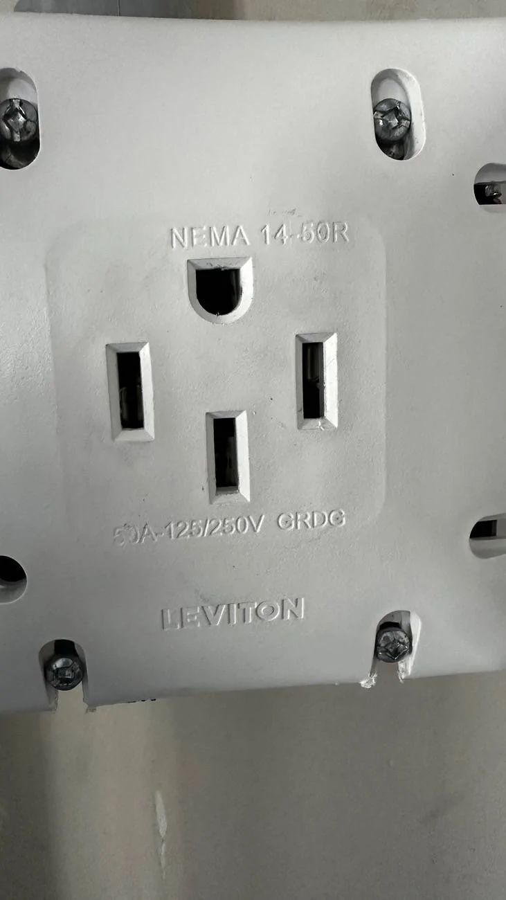

I have a 240V line connected to the charger. How can I tell if it was grounded properly or not? The line was installed when the house was built 7 years ago.
edit: actually, looks like on the plate it has the letters GRDG, does this mean it’s grounded?

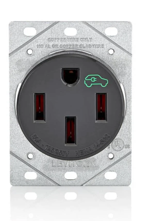

agreed - check your circuit and inspect the socket for any signs of thermal damage - also make sure your NEMA socket is "EV rated" - that's the Hubble or Leviton EV sockets - lesser/normal/common residential NEMA 14-50;6-50 sockets are not design for the long duration high demand operation that EV charging causes…a socket that is not rated for EV charging loads may cause electrical connection issues during charging sessions leading to electrical connection faults…

also review Porsche's recommendation/requirements for proper install of their EVSE's - their suggestions/recommendations/requirements follow industry established best practices (they are not unique and mirror other EV vendor's excellent advice) - but they are spot on with calling out the requirement for a Hubble Commerical quality NEMA socket…I would also consider the Leviton EV rated socket - but it was not available as a product at the time Porsche published their recommendations

Upon inspecting the socket, there doesn’t appear to be any burn marks and looks like it’s a Leviton EV socket. See photo attached. So then my next thing to check is if it has been properly grounded?

I wonder if the reason it hasn’t overheated or show any burn marks is because I typically only charge at 50% (Level 1), and usually charge between 40%-60% SOC. Occasionally I would charge using Level 2 up to 100% SOC when I need to drive out of town and need enough juice to get back without needing to stop to DC charge, but that’s maybe once every two weeks. I would have thought the electrician would have known to use an EV rated socket instead. And they supposedly have a lot of EV charger installation experience too.
most electricians are clueless when it comes to EV charging even those that have done EV installs
at a minimum your install does not match Porsches recommendations on the NEMA socket used - which mirrors other EV vendor’s recommendations - if they actually knew what they were doing you’d have a hubble commercial socket since most EV vendors recommend that and is best practice for an EVSE- so your electrician didn’t do any research or missed the memo…
