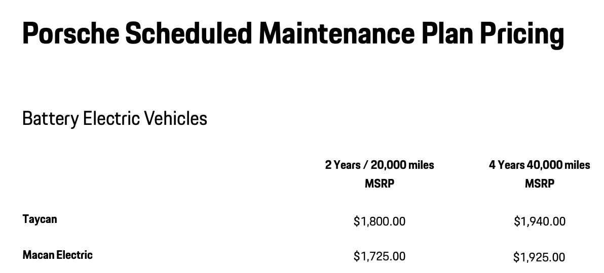

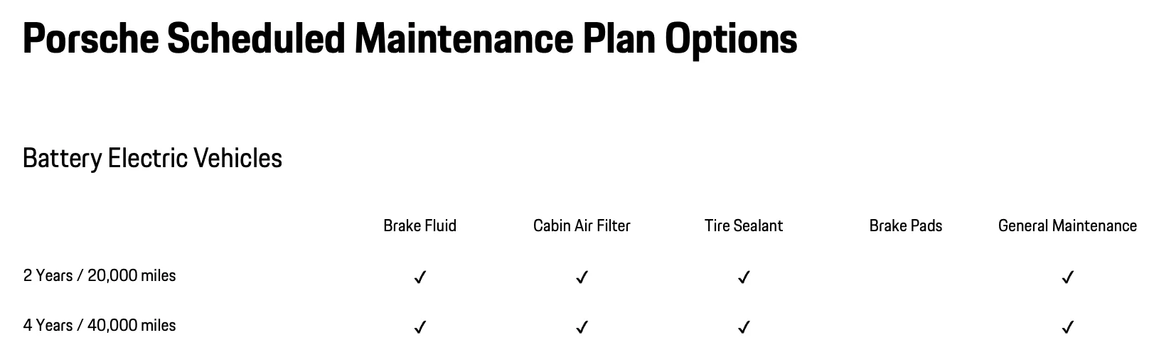

Had the car in for the 1st service. Instead of paying $1500 for the service, I asked for 2 things:
1. brake fluid flush (at 1 year, this is an overkill IMO)
2. service interval reset
Total $440
I got a loaner, and they performed several different recall campaigns.
I'll need to replace the cabin air filter and wipers myself, but I kept a chunk of change in my pocket. Did the same approach with my Tycan for 2 services.
Next service Oct 2027 or 1880 miles (not sure why not 20k, but that's what shows on my app)

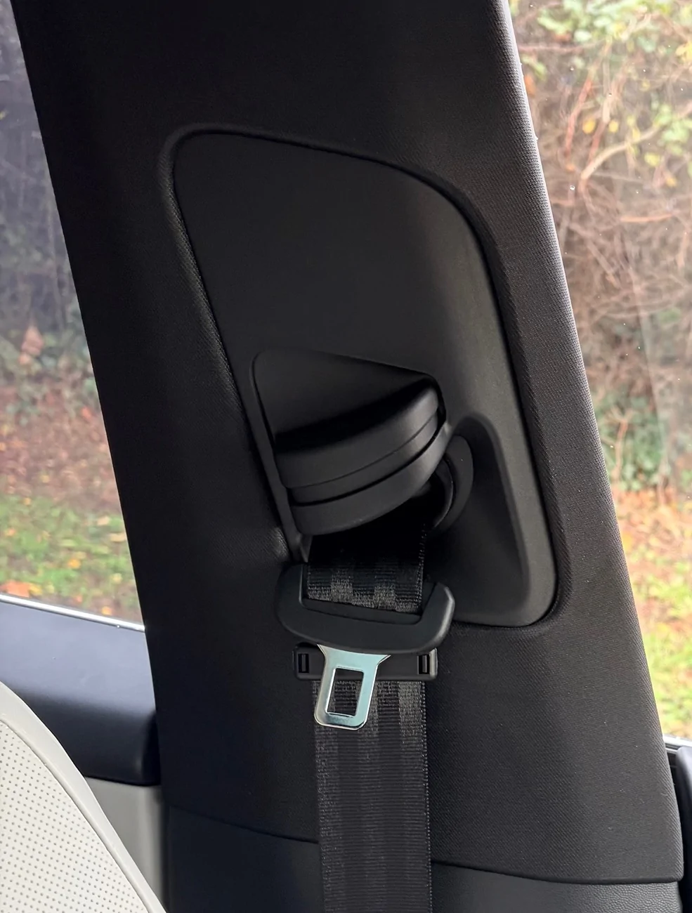

BTW, for those who hate the passenger seatbelt buckle rattling, they installed this as part of a recall, I'm guessing.

I had mine done under the ‘campaign’ and it does look anything like that. In fact I can’t see any difference but it certainly works. May be a different resolution in the UK ?
Can you take a pic? I can’t see how they can fix this without replacing the belt like the I have shown above or something looking like a bodge (what they did to OPs car).
There is very little space between the buckle and the B pillar in the Macan which makes it impossible for the buckle not to hit the B pillar when the car rocks side to side.

I had mine done under the ‘campaign’ and it doesn't look anything like that. In fact I can’t see any difference but it certainly works. May be a different resolution in the UK ?

Thank you. That looks like mine as it came from the factory, I did not do the recall.
I have mine the same way, jammed up all the way up, it is the only position that it doesn’t rattle.

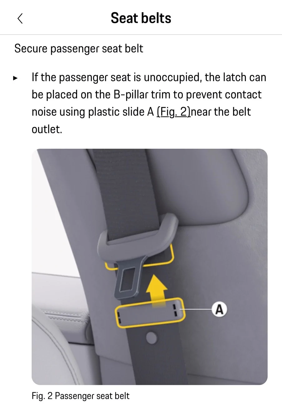

but at the same time, i bet when the car is out for testing, there's always another person in the passenger
No, Porsche were fully aware of this design fault, it is included in the manual.

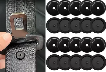

Personally, I prefer this option. It's barely visible. I installed it on both front seatbelts.
The standard clip solves the problem temporarily, but it eventually shifts and hits the B-pillar again when you're alone.

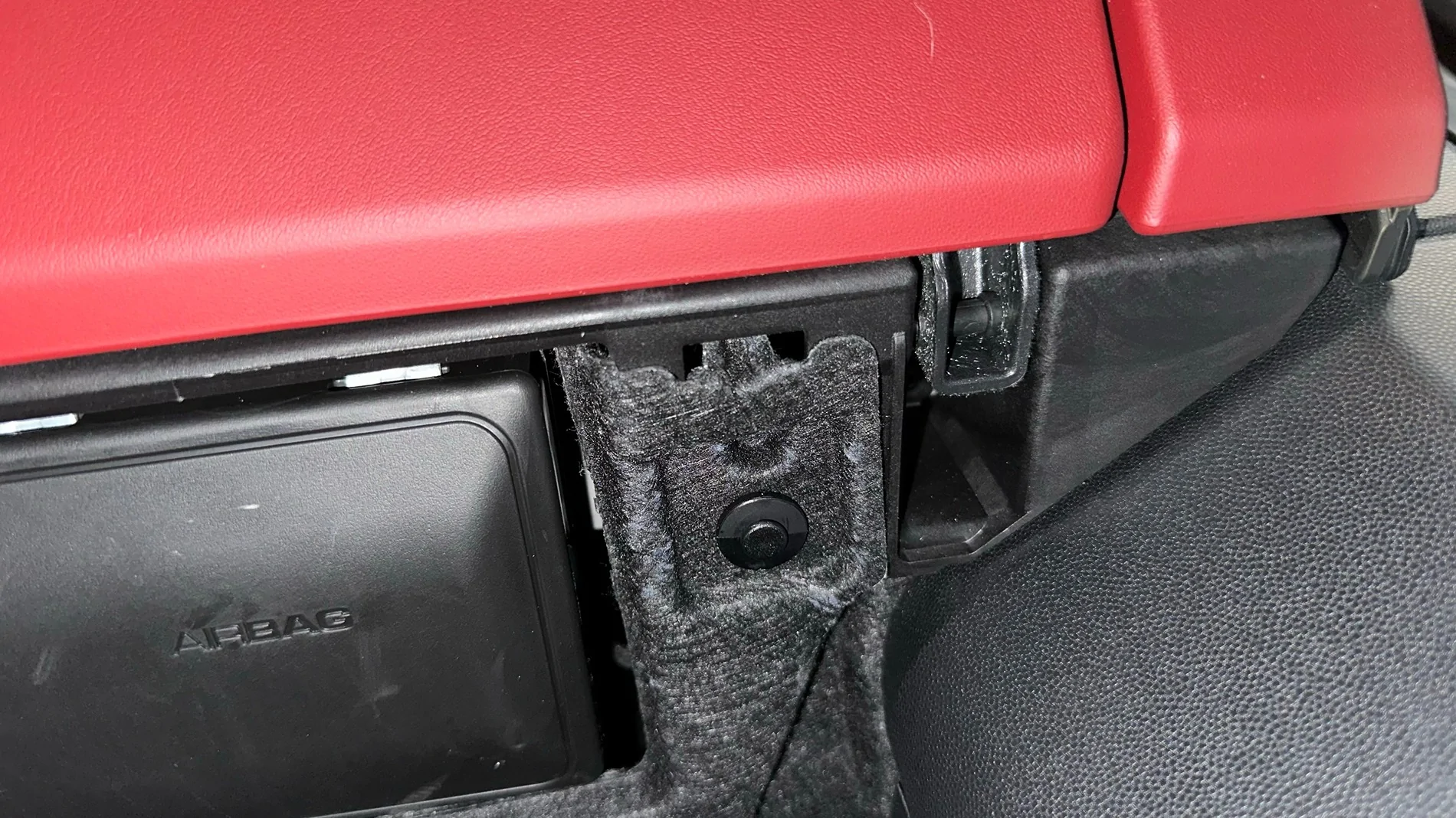

Just out of curiosity, since you mentioned using blower on the cabin filter. How do you access the cabin filter so we can pull it out and change it ourselves? As I understand from the ICE Macans, the cabin filter is located on the passenger side below the glove box compartment. I don't see the same type of clips in my Macan. They just look like this.
Electric Macan EV My 1st Service @ 1 year / 18K miles kno
Is this what I need to remove to gain access to it?
