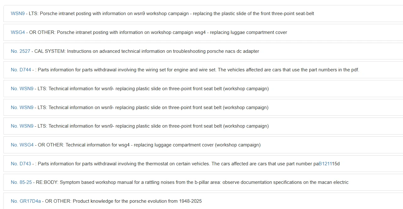

It’s not a recall so it won’t show there.
all campaigns and bulletins show here on the DOT registry: 2025 PORSCHE MACAN Vehicle Details
even the seat belt pillar campaign shows.
look at the bulletins...
Electric Macan EV MY26 software update (week 36) for MY24-25 1764794994963-sk
there's even a bulletin for them updating the toy replica catalog
so i guess this update campaign is just late to the party
