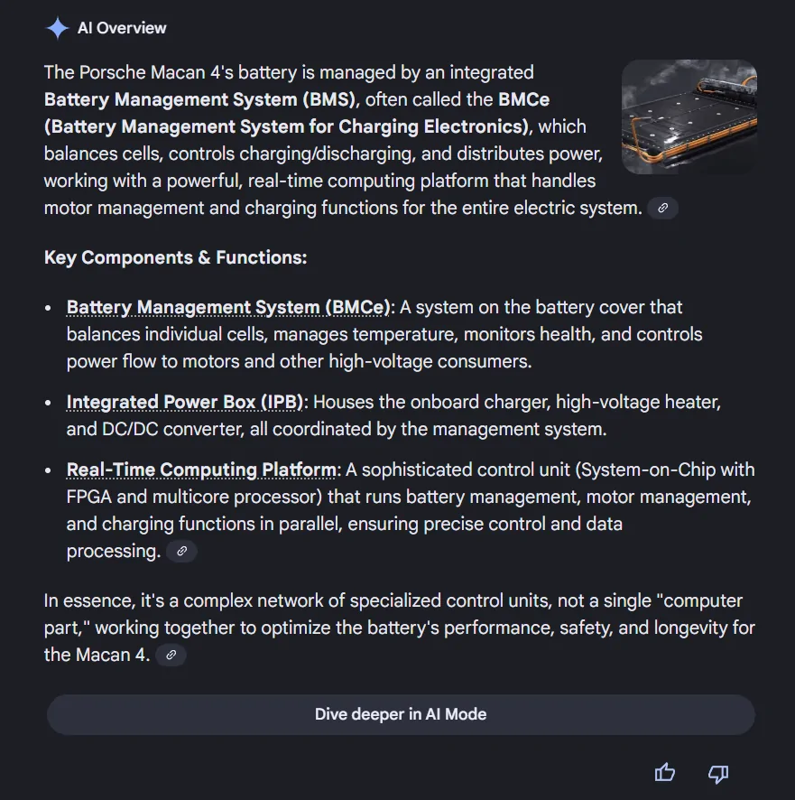

Yep, they told me on the phone it's the computer itself, the hardware.
I will post more infos when available.
Seems it's not just one part that manages battery and charging if this AI answer is correct
