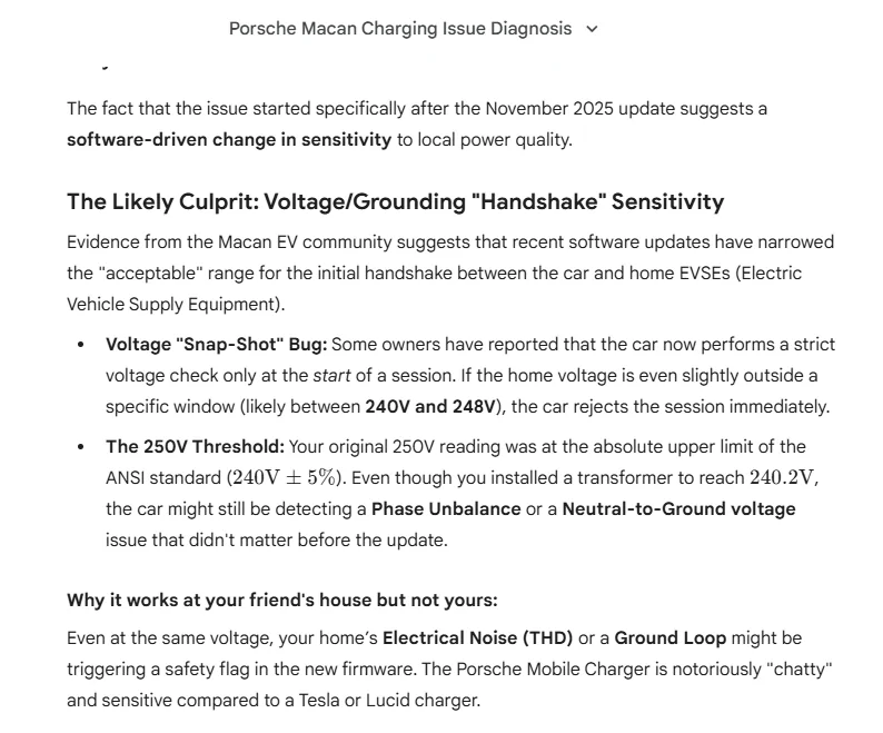

I tried using Gemini AI to see if it had any insight we haven't considered or talked about yet.
This is what it said:
Electric Macan EV MY26 software update (week 36) for MY24-25 1768239912344-m2
