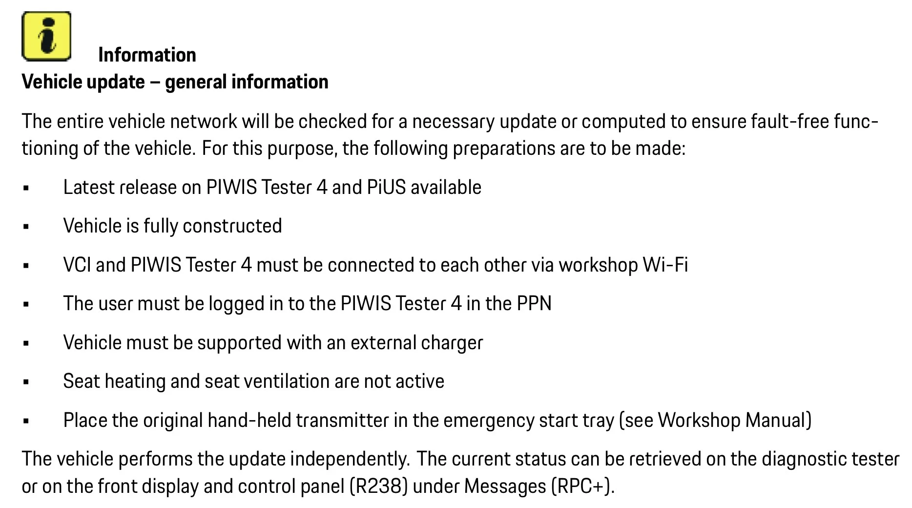

https://static.nhtsa.gov/odi/tsbs/2025/MC-11016767-0001.pdf
ByeBye mentioned WSD0, forgot what this update was so searched for it. Found more detailed technical note from Porsche. Have a look at page 7 and 8. Jesus, explains a lot. Seems dealers keeping us in the dark, they know exactly the source/modules affected. In my case, both faults (two Macan) relate to system failures mentioned. How I see this, it’s hardware related as otherwise all would have similar problems. In my world, that’s simply treating symptoms instead of rectifying cause.
and people wonder why Porsche can't do OTA updates - or continue to insist that they can…
from the tech article…
12V external power supply required during the update process
Battery charger with a current rating of at least 90 A, e.g., VAS 5908 - 90-A battery charger.
Sitting inside the vehicle during the update
• Abort update by automatically activating the ignition
Ăž Avoid sitting inside the vehicle during the update.
read the requirements below for what is necessary during the update process…
Thank you for posting the link.
What I say below is pure speculation, as even superficially understanding the hardware and software systems in these cars is way beyond my limited experience. But I do speak as someone who has written and debugged software, albeit primarily in linear and predictably branching systems.
That said, basic logic suggests that the fact that only a fraction of cars experience these problems, and that many cars display transient warnings, while presumably we all have the same software (pre update), says to me that the software is not sufficiently robust to deal with the wide range of circumstances it must deal with. What I mean by this is, clearly there are many interacting systems, resulting in almost an infinite variety of events, signals and their timing. Plus there is a very high standard of safe behavior by the systems. And we are working with at least some systems (I'm thinking the battery cells especially) whose states and capacities are not 100% predictable.
I do believe that the majority of problems are a combination of underlying hardware faults that are not properly handled by the software. I think there are two points here. One is, some of the problems will not be fixed by software updates, which are not magic pills. Two is, software fixes CAN correct some of the problems, not necessarily as covering up symptoms but rather better handling scenarios that the software designers had not previously properly accounted for.
i have to say, the apparent fragility of the update process itself is a little offputting, and I agree that implies the likelihood of significant OTA updates on these cars seems nil.
I would say, if a dealer says, "that will be fixed by a software update," that statement is more hope than fact, but that doesn't mean it's not true.
