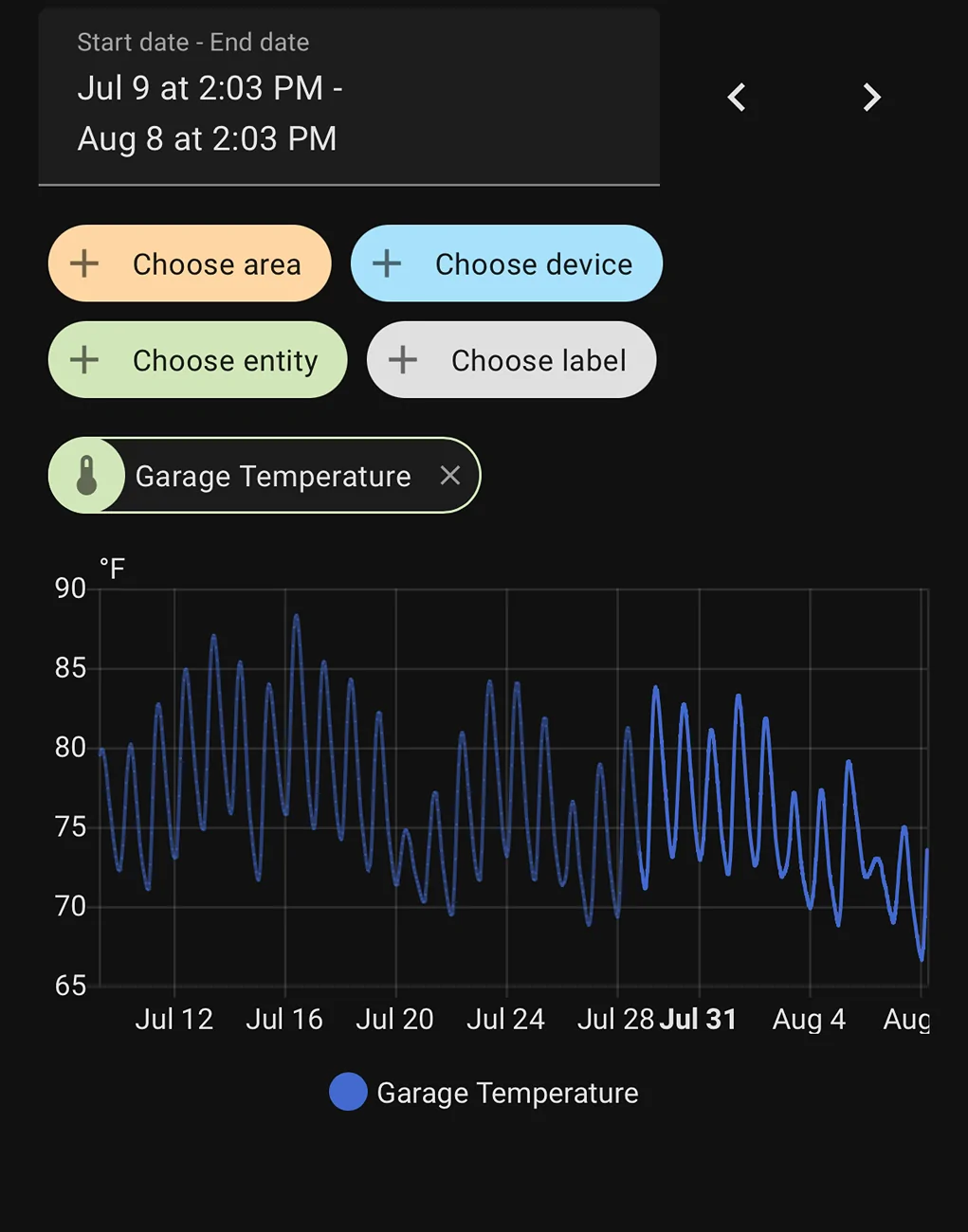

Garage temperatures for the last 4 weeks to confirm what I said about it being cooler.
Electric Macan EV New app features? Screenshot 2025-08-09 at 6.03.56 AM
