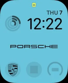

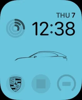

There are actually 2 active complications for the watch - SOC and Lock State.
Lock State isn't available around a dial, so you might not see it as an option for your current face. The Modular face allows you to select both.
Yesterday, the Lock State complication worked for me (but it's really small and hard to read). After today's update, it no longer displays! And it seems the link is broken too, so it doesn't go to the Vehicle Status page of the app anymore.
Here's some screenshot that contains the Porsche complications available - Word Mark, Silhouette, Shield, then Lock State in the bottom middle, and SOC in the bottom right.
As I'm writing, there's another choice for where the Word Mark is that shows a silhouette of a car. I can't tell what this is called, as the UI doesn't show the full text of the complication name.

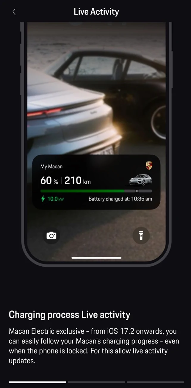

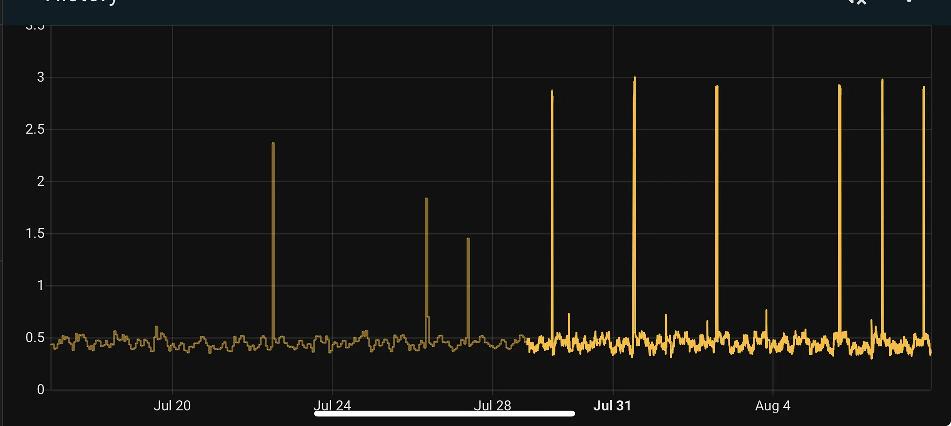

Not 100% sure yet but the new live activity tracker seems to be draining the battery. I’m on a 6 week vacation. Left the car at 50%. I have power monitoring setup a can confirm the first 4 weeks it only used about 4.7 kWh/week in single bursts once a week. Since the app update it’s been charging in 1.5kwh every 24h. I just shut off the live activity to see if it stops.

Here’s the actual consumption graph. You can see the frequency of the spikes started increasing.
2 thoughts:
- Wasn’t the Live Activity update only made available yesterday? What live activity are you thinking of?
- That should impact the 12V battery, not the HV battery you’re referring to
Unless I’m missing something?

I’ve seen 3 charging sessions since it updated. Maybe it was released earlier here? My phone auto updated and I started getting live updates at least two days ago. Only reason I looked at the data to see what was going on.
it’s very clearly the high voltage battery. Why would it need 3kw to charge the 12V?

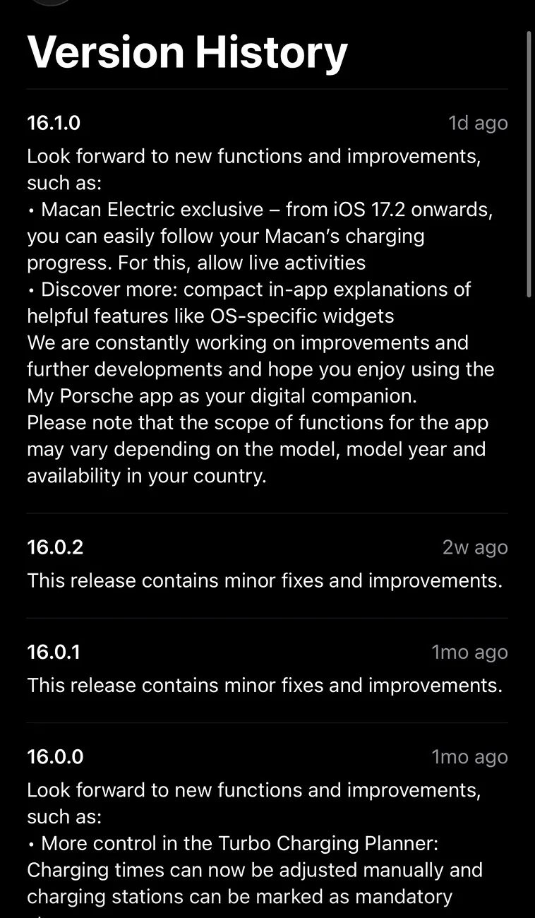

I don’t know where ā€œhereā€ is but the change log on the US App Store shows the release was yesterday and previous releases don’t mention anything about Live Activities - hence my question.

And I fully understand the HV is getting drained. My point was that Live Activities would drain the 12V, not the HV battery. This to say that the culprit may be something else.

Here is Japan, but I use the USA App Store. No idea how apple decides when to release an update. Can easily imagine it’s phased by location of phone not App Store.
Fromanother thread it was stated that checking the app turns on the high voltage battery to charge the 12v battery. Between that and the coincidental timing made me suspect the live activity. I turned it off, while not conclusive if it magically stops charging every 24h that’s good enough for me.

Looking at the App Store, when did you get 16.1.0 updated on your phone?
Open the App Store, tap your picture in the top right corner, and scroll down to see when the Porsche app was updated, it will give you the date.
