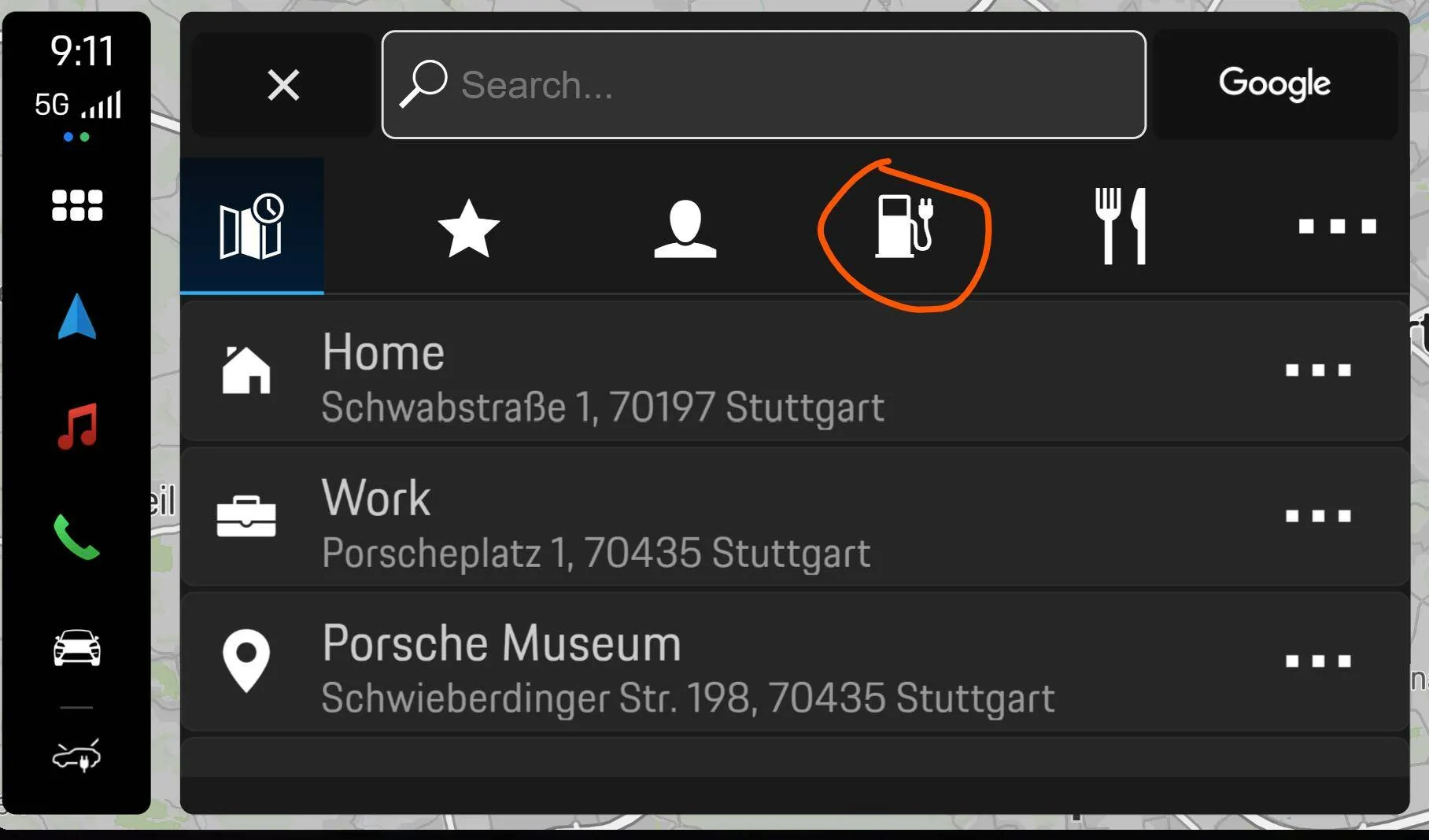

The OP is asking for a step by step.
There are 2 ways to do it, as others are suggesting.
Observe battery temp going up if preconditioning of the battery is working. You need to be in the optimal conditions below to get the fastest charging possible when you get to the charger.
Electric Macan EV Preconditioning Battery 1737667701409-xo
1: Set Charger as Destination from the Charger tile of the Nav system
Electric Macan EV Preconditioning Battery 1737667489755-hc
2. Set Destination as Favorite (star tile) then 3-dots next to is to open a pop up to select NearBy Charger search and then set it as a Stop over.
