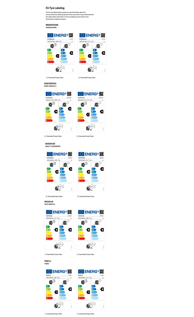

Your choices endorsed by Porsche (don't go off piste) are:
Electric Macan EV Replacement Tyres 1768922764193-ol
All summer tyres, NE0 all seasons include Pirelli Scorpion MS Elect, Pirelli Scorpion Verde All Season, Continental Conti Cross Contact RX (Shite) - any more to be aware of?

Do you have the same data sheet for 22ā€
Or is it likely to be the same?
Go to the configurator, select your model, select rim size, click the tyre icon in the rim image to display tyre options.
