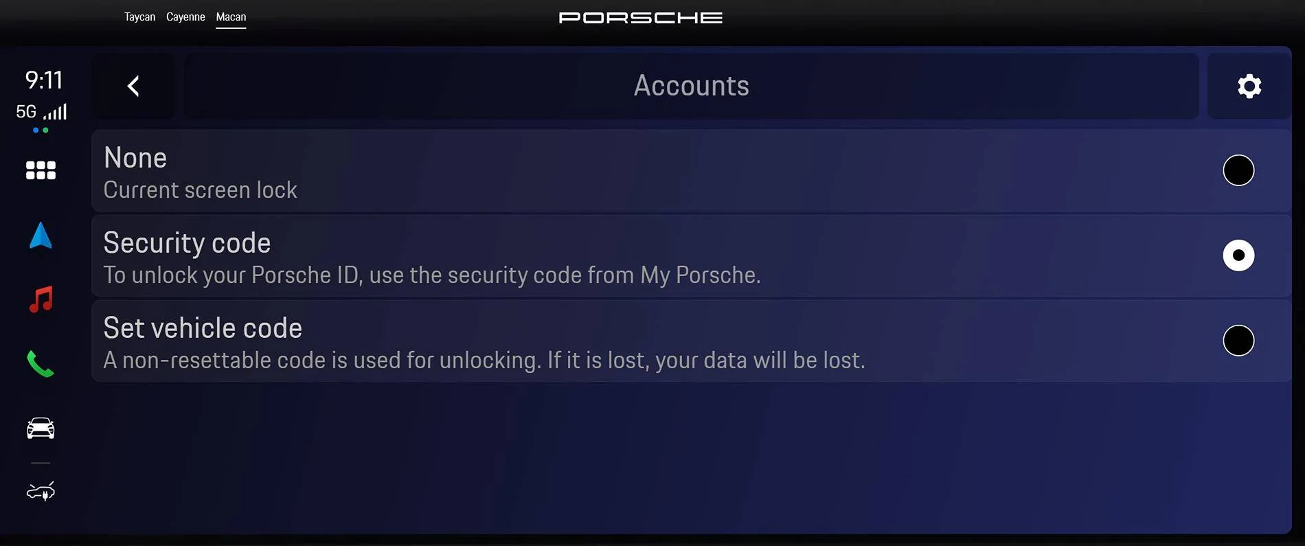

Settings --> Accounts --> Add Account --> then tap Main User Tab and then tap the user tile --> Changing Access Protection --> Choose 'None'

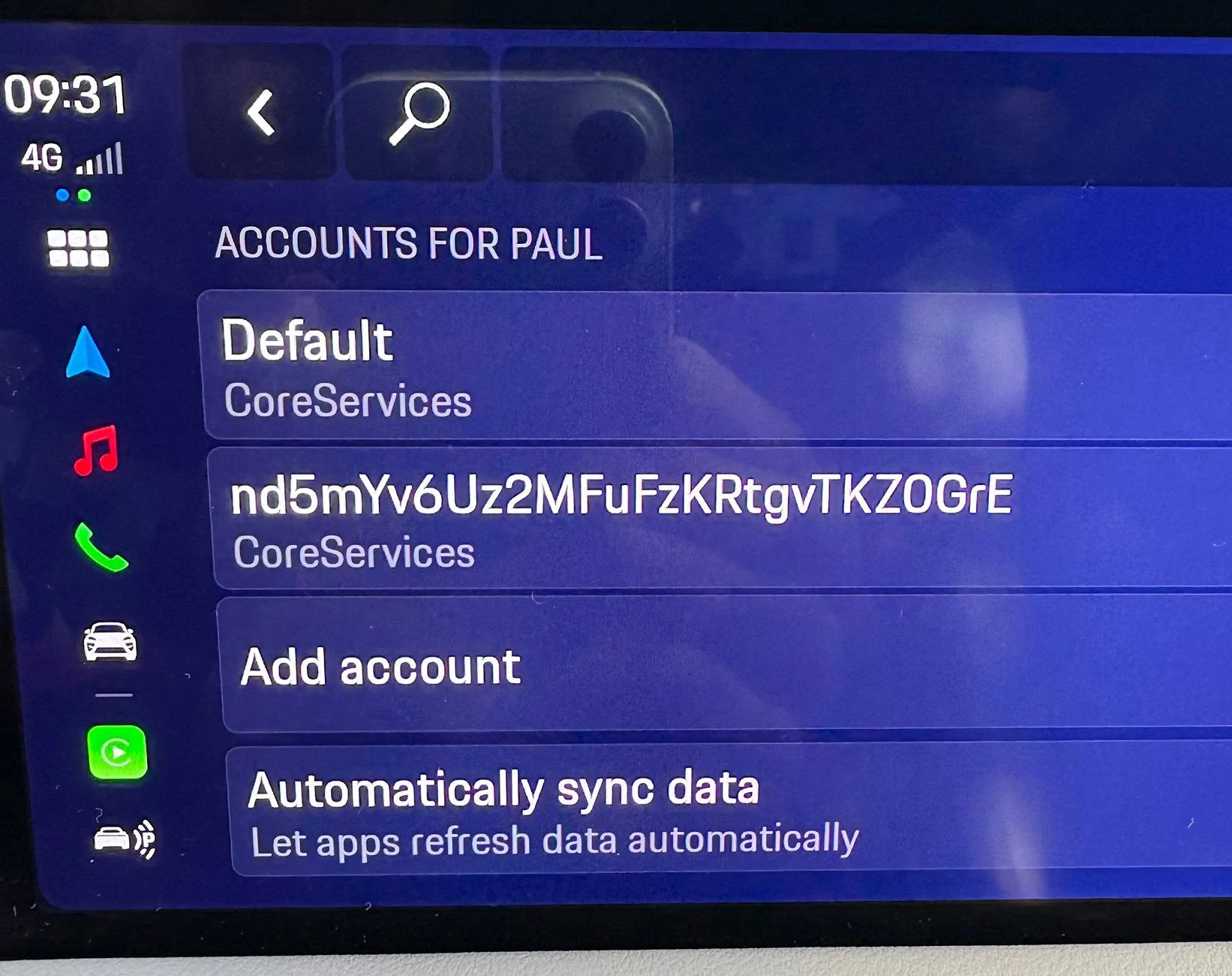

Thanks - this gets me a little closer but...when I click on "Add account" I hear a little click (the one that verifies you pushed the button) but nothing happens on the screen. The screen you show in the image above does not appear on my dash.

My car just spent a week in the shop getting the VR28.11 software update. The security code has been required every time I get in the car since. Porsche of America sent me instructions on how to avoid that but even their instructions ask me to click on an account tab that doesn't exist.
