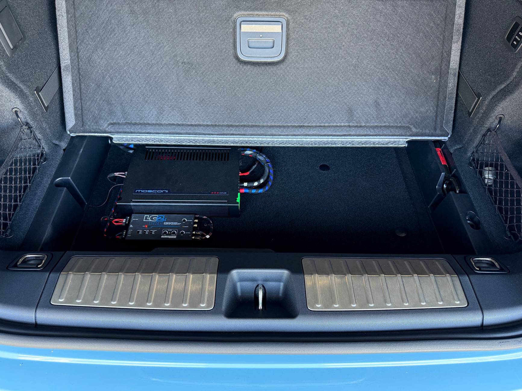

Share a little of my experience, with both 911 and Macan EV. This post is really for those interested in going beyond Bose or Burmester. I have listened to both, and stock Bose is pretty good, Burnmester better with clarity mids to highs, but both below my expectation for bass and power.
For both cars, the plan was to go further then stock and upgrade the full system. I’m happy to spend my money for better sound, both in having a DSP, more and better amplification, and strong subs.
My local stereo shop has done all my systems in my last many cars. Can’t share any tech details on the install, but here’s my experience.
With the 911, the base system is more difficult to upgrade, vs the Bose has many plug and play options from different vendors, to get a clean source and work from there. So on the 911 we chose the Bose and then replaced the Bose AMP, added DSP and MosconI amps, Focal speakers all around, including subs.
When we ordered the Macan EV, we had hoped the Bose upgrade path would be similar. However, the Macan EV has a brand Bose new amp, requires some R&D, that our vendor has been working for a new solution to mimic what we did in the 911. They expect to offer a solution in the next few months that’s plug and play.
While we are waiting, we went ahead and replaced the door speakers with the same Focal P60 as the 911, and complementary rear speakers upgraded. These are running off the stock Bose amp and provide much better clarity then stock Bose. Until we get the DSP solution and better amplification mentioned above, this is temporary and expect to get a lot more on the front end Once we can tune it and add the better amp.
For the sub, we removed the stock Bose sub, and added a dedicated sub and amp, same as the 911. We have a bass control knob mounted under the climate panel, that is hidden but can be easily reached while driving.
Here a few pictures to share. For those that think this is way overkill, you’re right. But my daily commute, and pleasure drives, are very enjoyable. Enjoy!

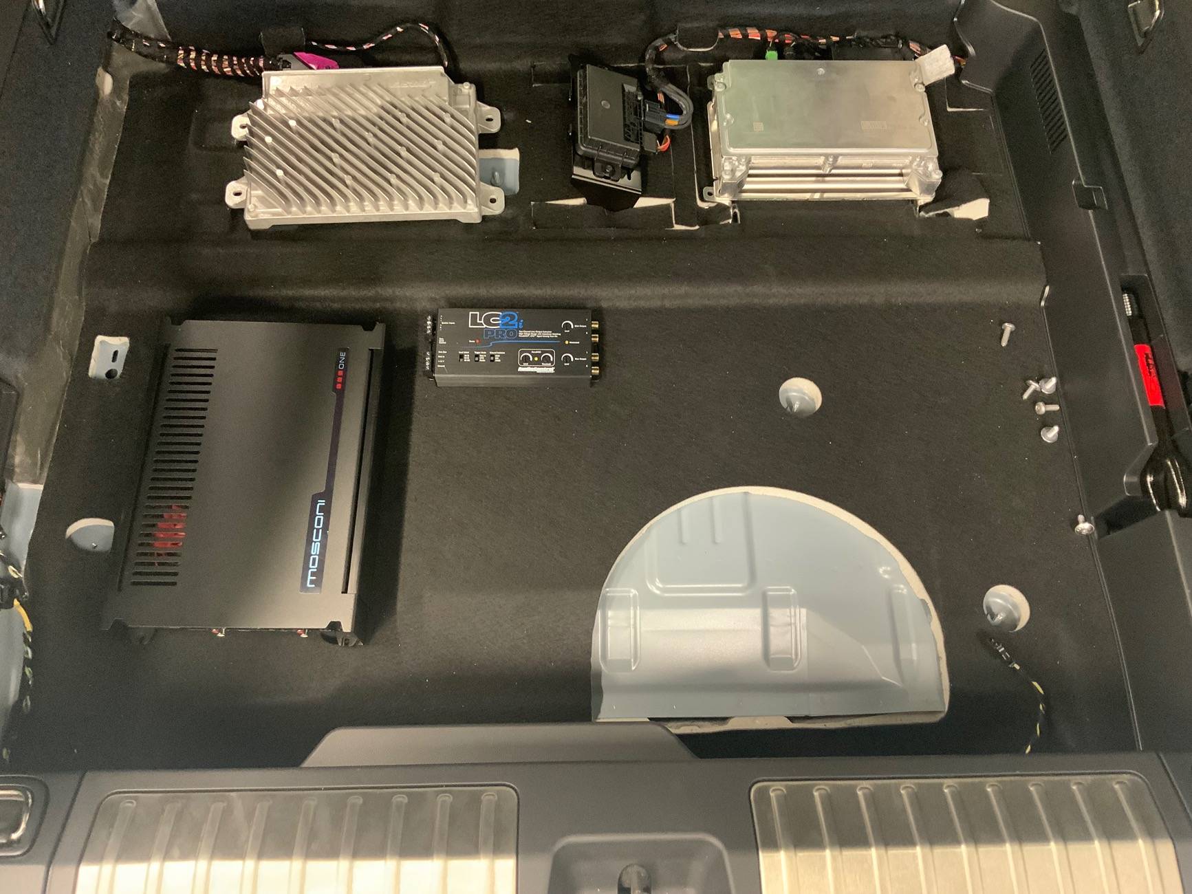

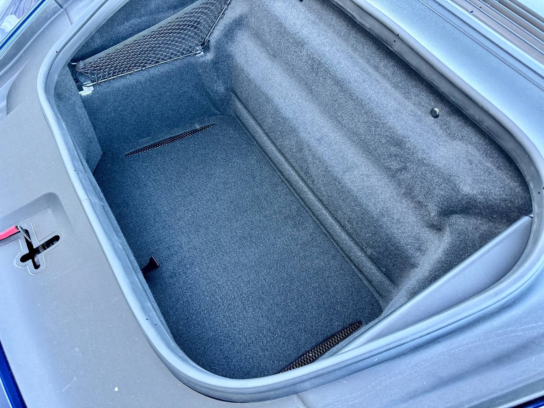

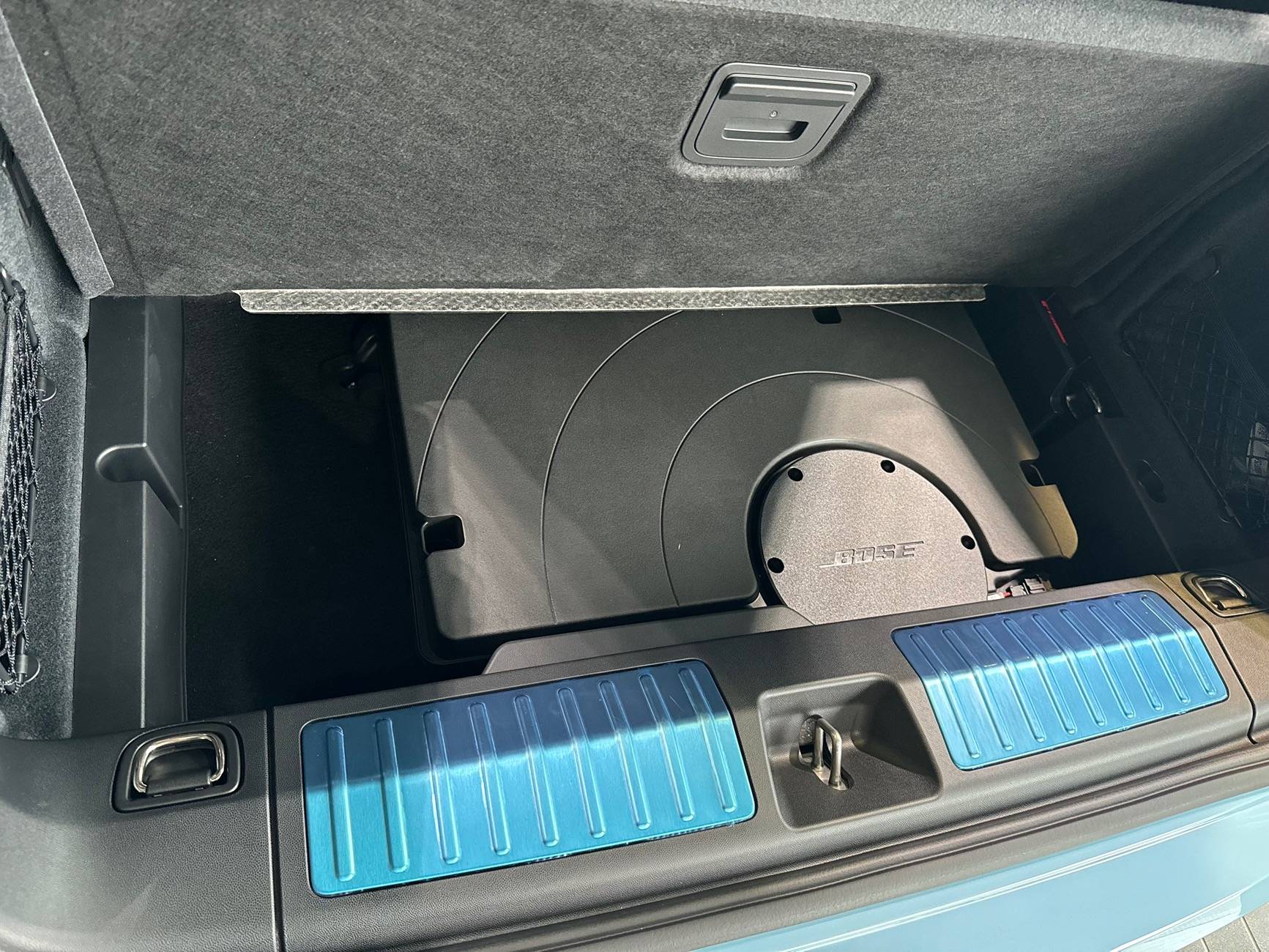

Macan EV Turbo, stock Bose Amp
Electric Macan EV Sound system Macan EV standard, bose, burmester 74831340228__9C38B4B7-334A-4E93-97D6-1DDA5ADE0E46
Stock Bose Amp upper left, Bose sub removed. Very shallow depth but good room to hide signal processor and amp.
Electric Macan EV Sound system Macan EV standard, bose, burmester IMG_7727
MosconI Amplifier and signal processor
Electric Macan EV Sound system Macan EV standard, bose, burmester IMG_4468

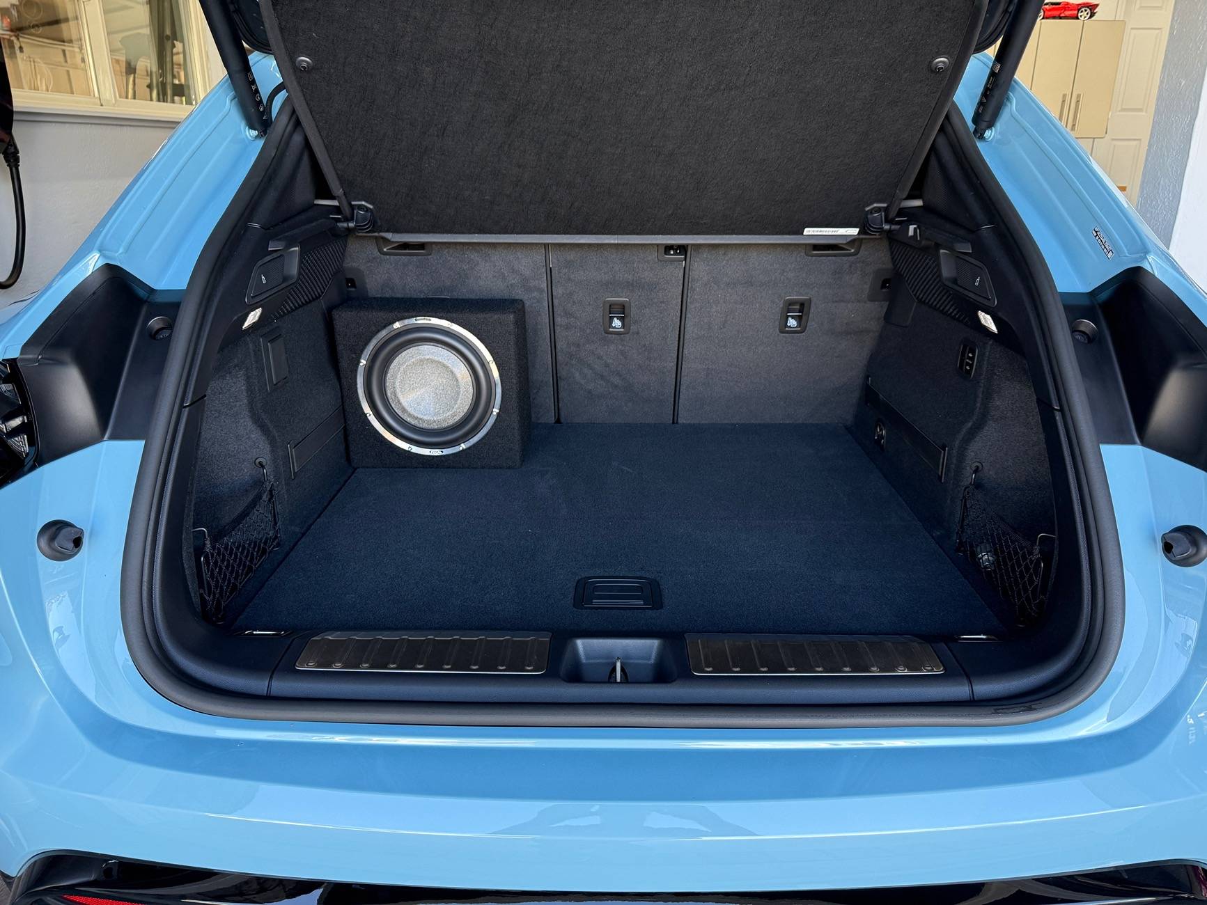

Focal Utopia sub and custom box. Small wedge design, Velcro holds it in place, easily removable if we need the full truck area. Hasn’t come out yet.
Electric Macan EV Sound system Macan EV standard, bose, burmester IMG_4467

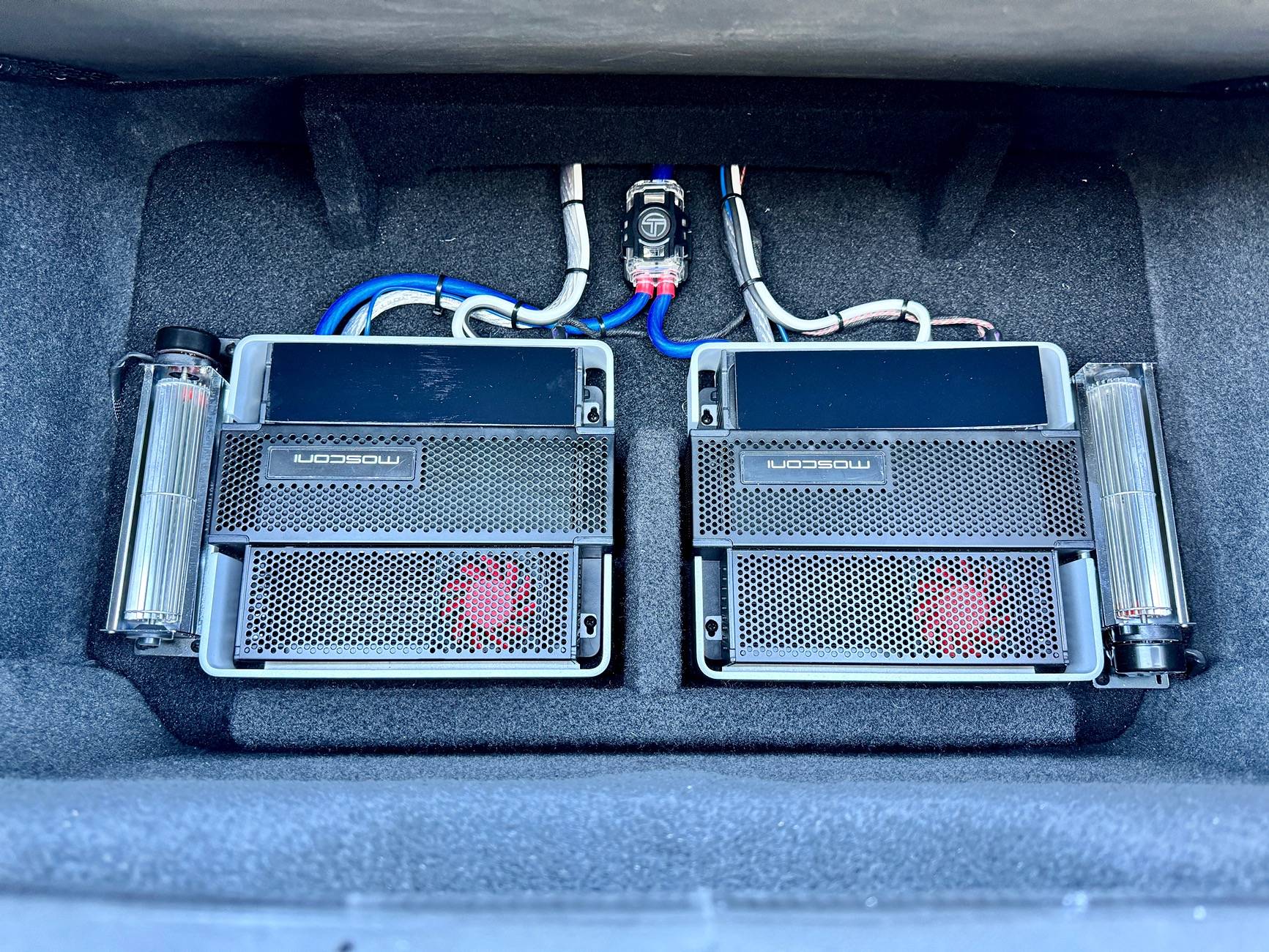

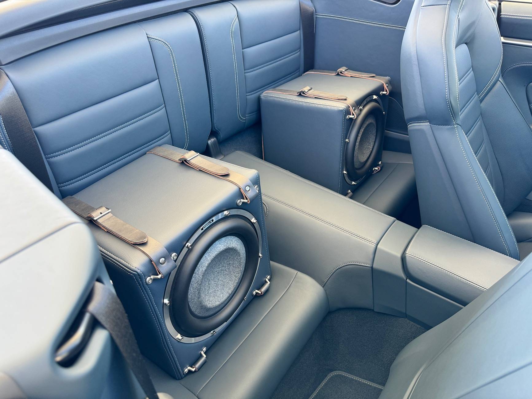

And here‘s the 911 Cabriolet install. This one we went a little bigger on, open cabin, desire for lots of bass. With DSP and inside speaker amps fitting nicely under the passenger seat in the factory location. I designed the custom sub boxes, and made the customer leather straps that loop through the child seat hooks. Front trunk amps are for the subs. Very nice custom install by my shop, and have the same option to quickly remove the subs, in just a few minutes if I need the space.

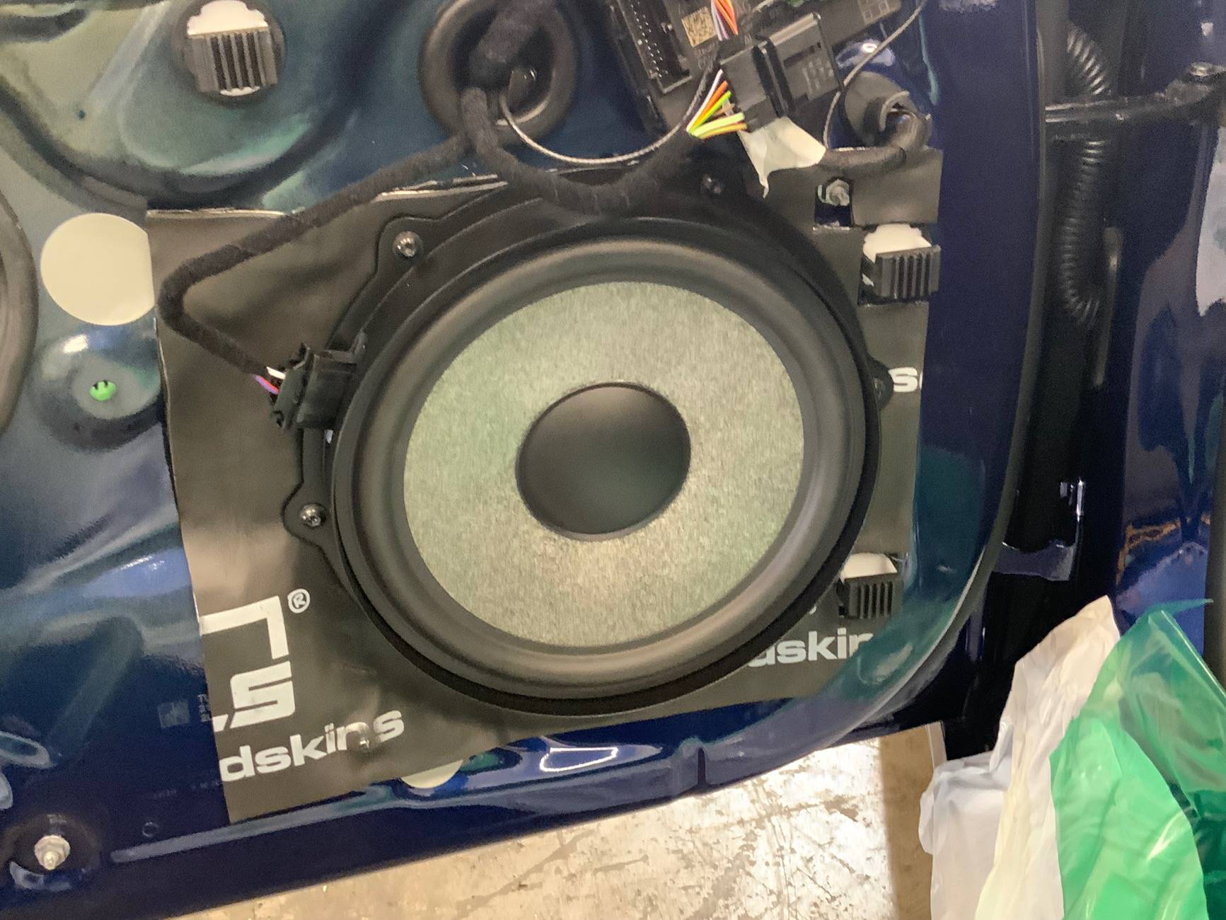

911 Focal P60 speakers front doors.

911 Subs and amps.
