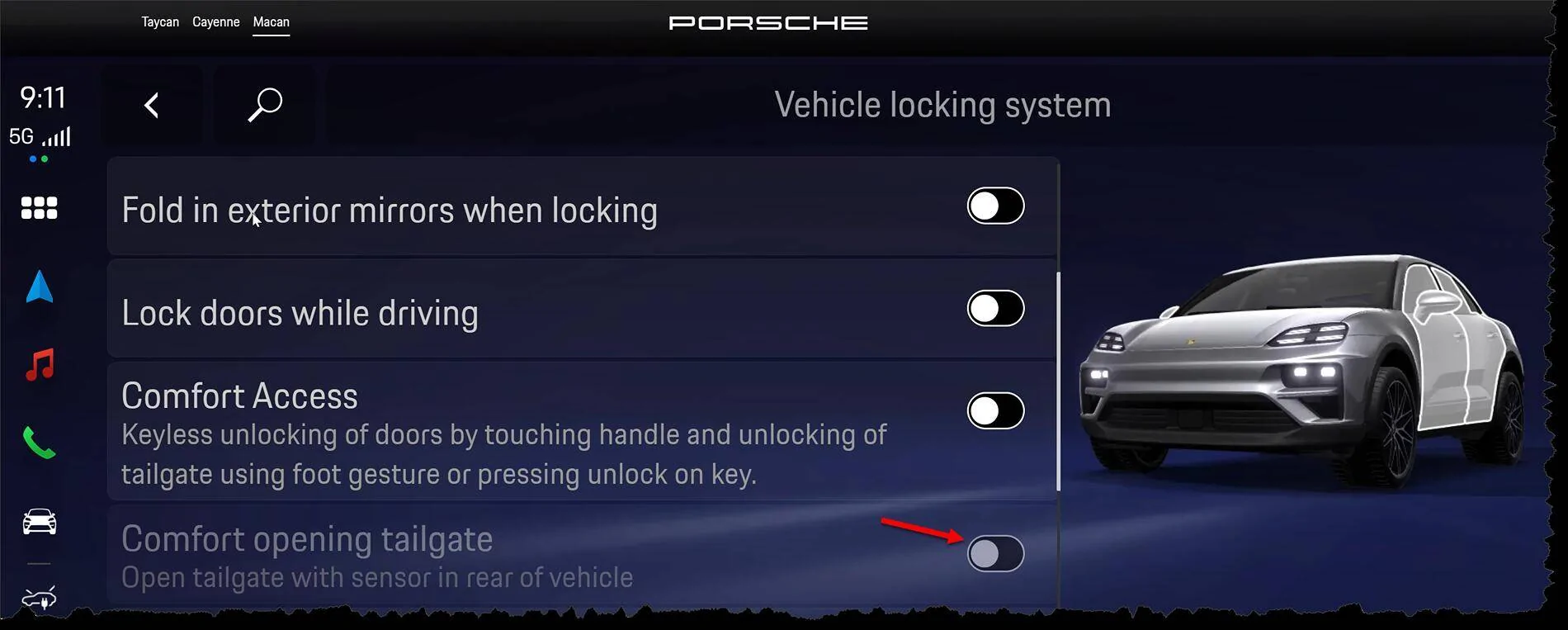

Check that the option is enabled - Vehicle Locking - Comfort opening tailgate option

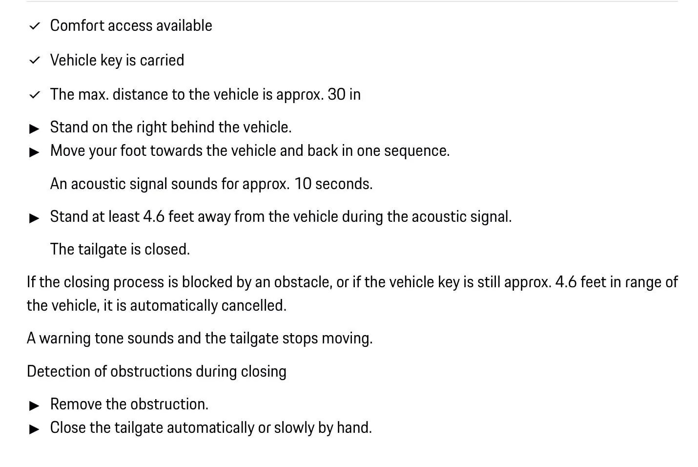

Make sure the keys are on your person, centre of the bumper (not too close) foot in / out and step back, repeat to close.

It works to close it. As discussed in the video above, a kick, offset under the right side, triggers both opening and closing. There is just a bit of delay that often cause me to think the kick didn’t work, but if I wait a second, it usually opens/closes.
