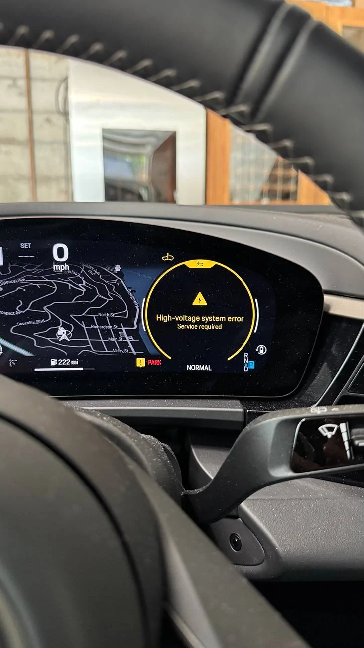

got in my car this morning and was greeted with this message. Anyone else seen this? The car seems to drive, but not sure that’s advisable. Is it safe to drive? Waiting for my SA to call me back…

Yes it is. Everything in yellow or orang, you can drive. If red you better stop.
721
1,165
Had it once but it disappeared after closing and reopen the car. It was related to a voltage drop during the charging process in an hotel I spent the night. Never happened again.

Thanks, gents. I tried turning the car off and on a couple times, including getting out of the car, but the message persisted. I was able to drive it to the dealer (not too far), so we'll see what they say about it. Thanks for the quick replies.

Dealer finally came back with this note. They seem to think it’s due to my home charger not properly connecting to the car. I have a Gen 2 Tesla wall charger with the TeslaTap dongle. I do notice that the dongle sometimes pulls out of the cable slightly. I always make sure it’s in firmly, but it’s possible my wife did not. Something to keep an eye on.
“Drove vehicle into shop, no warning lights present. Performed pre val - found code B17E0F0 - Charging socket 2 (UX5), charging plug not locked as a current code. Charged vehicle and code became history code. Cleared it and charged vehicle a couple more times, no fault codes came back. Recommend making sure vehicle is fully plugged in with factory charger and customer hears click noise ensuring latch is secured. Monitor condition.”

Came back from 3 day biz trip And was shocked by same alert Yesterday 9/May.
its at the Dealership under review/scan and will revert as soon as I hear back likely Monday 12/May.
If helpful/interested, I share some color below:
- Had charged the car to 100% (because upon return I was going to drive >150 mis) and wanted to arrive with plenty of charge left For return leg.
- Last charging session went smoothly; same charger in apartment building I’ve used since delivery. Unplugged and parked my car. No issues.
- After 3 days away, I opened the car seamlessly, the “motor” as usual automatically turned on, loaded bags and got in.
- as I closed the door, the dashboard went from all lit up and ready to go to dead. The car was off!?! I was surprised but didn’t initially worry.
- Pushed start button; car came back to life.
- suddenly the exact alarm as Henry’s pic appeared in orange in same location.
- As in Henry’s picture, the (!) exclamation point next to “drive” in lower left appeared.
- I went to the entertainment screen in the “!” Alerts section. The message stated same alert plus: “immediate service is require” .
- Below that, there’s an access button stating: “call roadside”, which would connect us directly to emergency road side to come get the car.
- I opted to call the dealer 1st, they are 20 miles from my apartment and on the road of my planned travel.
- kept car turned “on“ while parked and on the phone, Fearing I might not be able to restart it or open it should a flat bed tow trick be needed….
- Dealer asked message color, if ”red or white”.
- It was “orange “, so he told me it was safe to drive it there and I’d get a loaner while they ran scans.
- Appears orange alert is ok to drive. red or white no (??).
- While driving to dealer, it ran fine, but consumed battery charge at a faster rate than normal.

I even had it in red, stept out of the car for 5 minutes and it drove afterwards without an issue, turned out to be the sound module that was defect and made other components throw up errors .. nothing to do with the HV system …

I’ve gotten that warning twice in the past two months. Went away on its own, as was the case with a few other warning messages.

My Macan 4, delivered 31st Oct 24. Throws this error every time I try and use the departure time scheduler on the car. No problems using the scheduler On the charger. Has been in and out of dealer since last December. A loan Macan 4S did not have the same problem…. A loan Macan 4 provided last Monday does.
If you close the driver door and lock up and go away for 15mins no error remains and no messages are cached for diagnosis by the dealer (Not helpful).
A couple of months back Porsche Germany said was a problem with the two pulse inverters (they change the DC battery power to AC to drive the motors). These were replaced and it made no difference.
Sorry, no root cause analysis….. if I get a robust diagnosis I’ll get back to everyone.

Every car will have an another main cause, mine was the sound module for pedastrians making the high voltage error being thrown up, very hard to catch and it took the dealer a while to find it … lots of ECU’s on the network and if one is blocking the network you can get strange errors …
